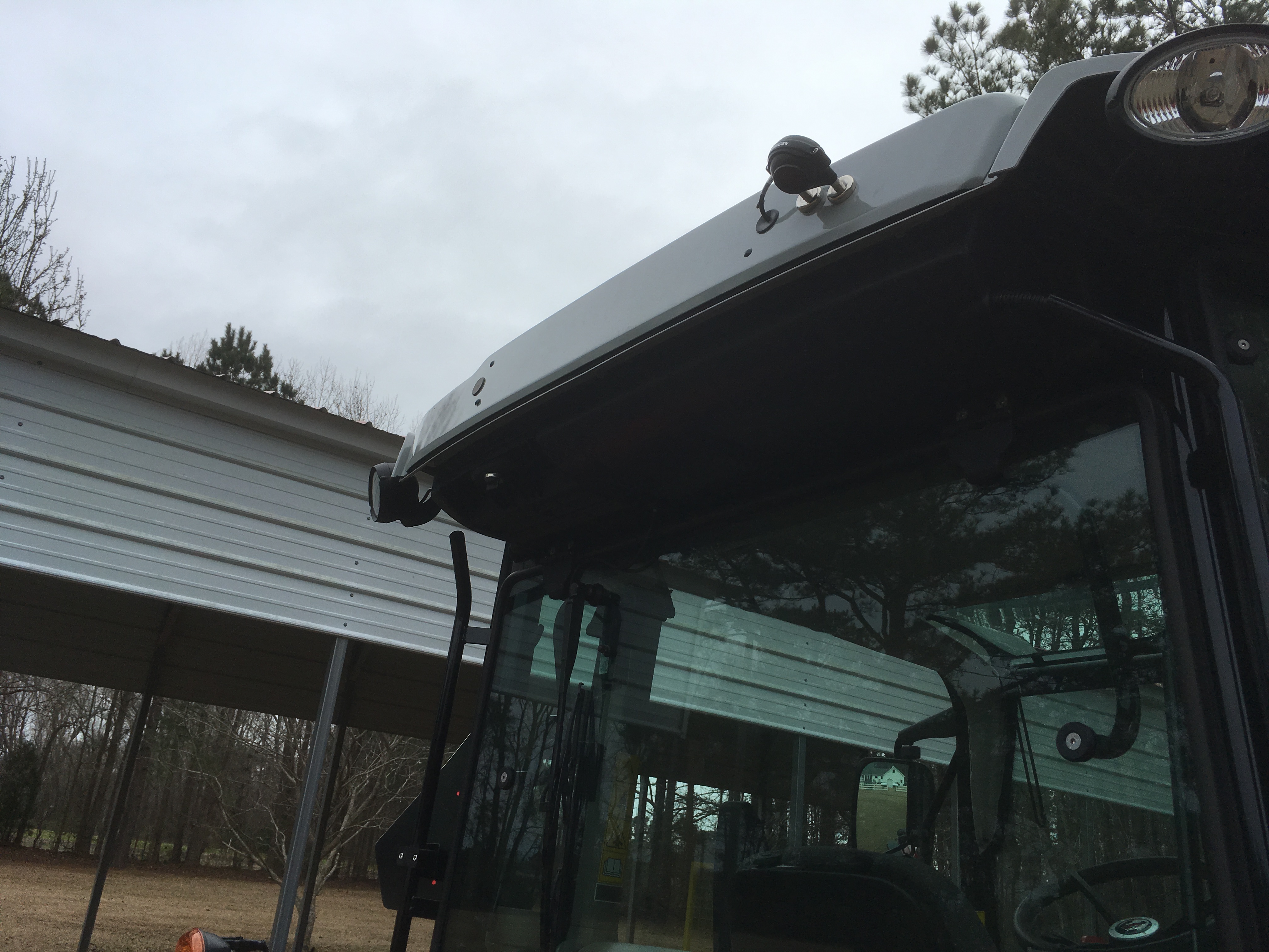

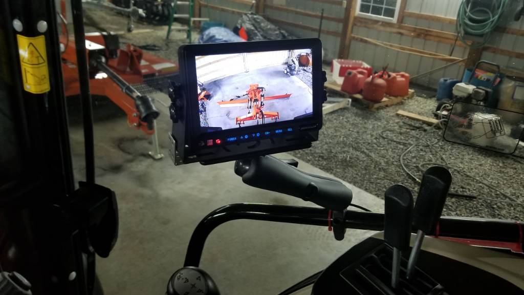

I'm headed there tomorrow morning to sit in the seat while they adjust the camera system to my liking.
Their first attempt was most unsuccessful. Now they are mounting it where it belongs, but still issues of angling monitor.

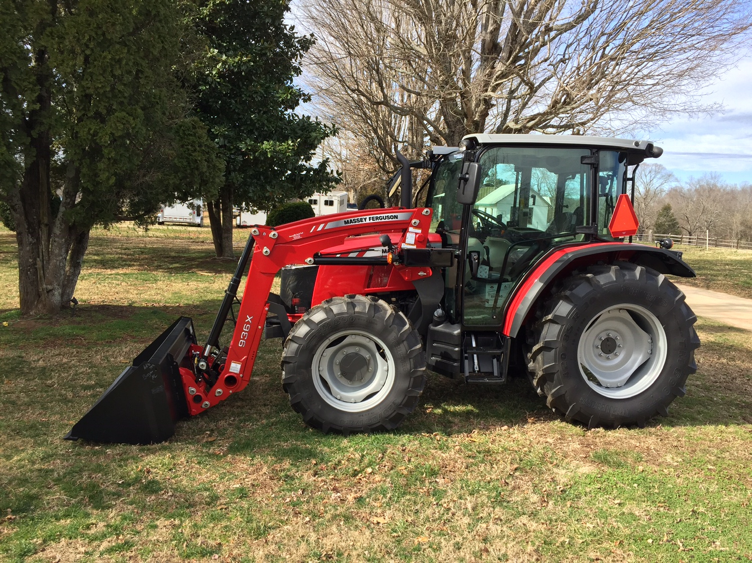

Here is a pic the first night using it. I prefer the forks now though with the round bale. The 3pt doesn’t go down quite as much as our older dk40.

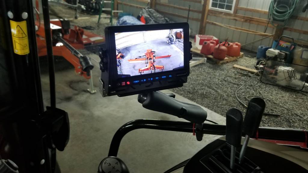

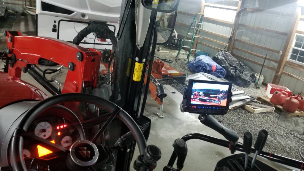

Camera monitor now mounted on right door tubular bar and camera now in center of tractor. Dealer also repainted areas they scratched prior to delivery. Hope to get it back on Tuesday, so much rain here.
I mounted my camera monitor with Ram mounts. They work awesome. 20181201_162546.jpeg20181201_162606.jpeg
