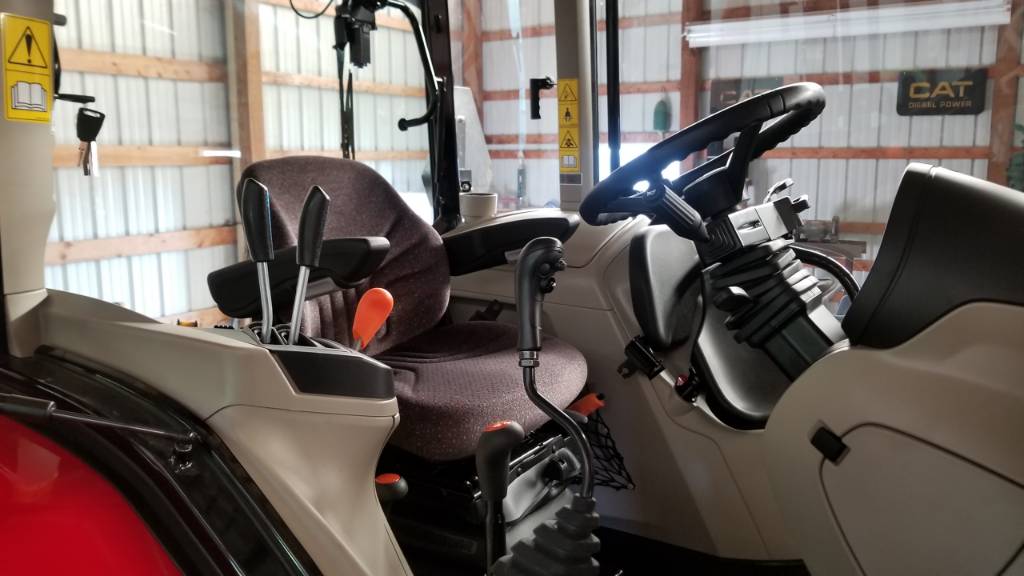

My next question is what type of 3rd function do you have? I’ve learned the Massey option is a diverter.. but I was told it was a true live 3rd function
Massey is a diverter control, which is all you need. I cannot think of a function that you need live.
So it looks like they may switch the 3rd to a wr long bc i was adamant in wanting a true live 3rd function. I’m just glad I followed my gut to go see it vs what I was just told. It’s almost like I could benefit from just getting one of your phone numbers who owns it to find out how to work this thing since the dealer apparently doesn’t sell many..

I personally like the diverter style 3rd function. Push the button, wiggle the lever to do what you need to do, let go of button and back to normal. Works great on a grapple
You have the factory setup?
I have no idea where it came from, sorry. I can ask. I think it's all WR Long, same thing they had to do with my Kubota when it was installed instead that time I got two pushbuttons.

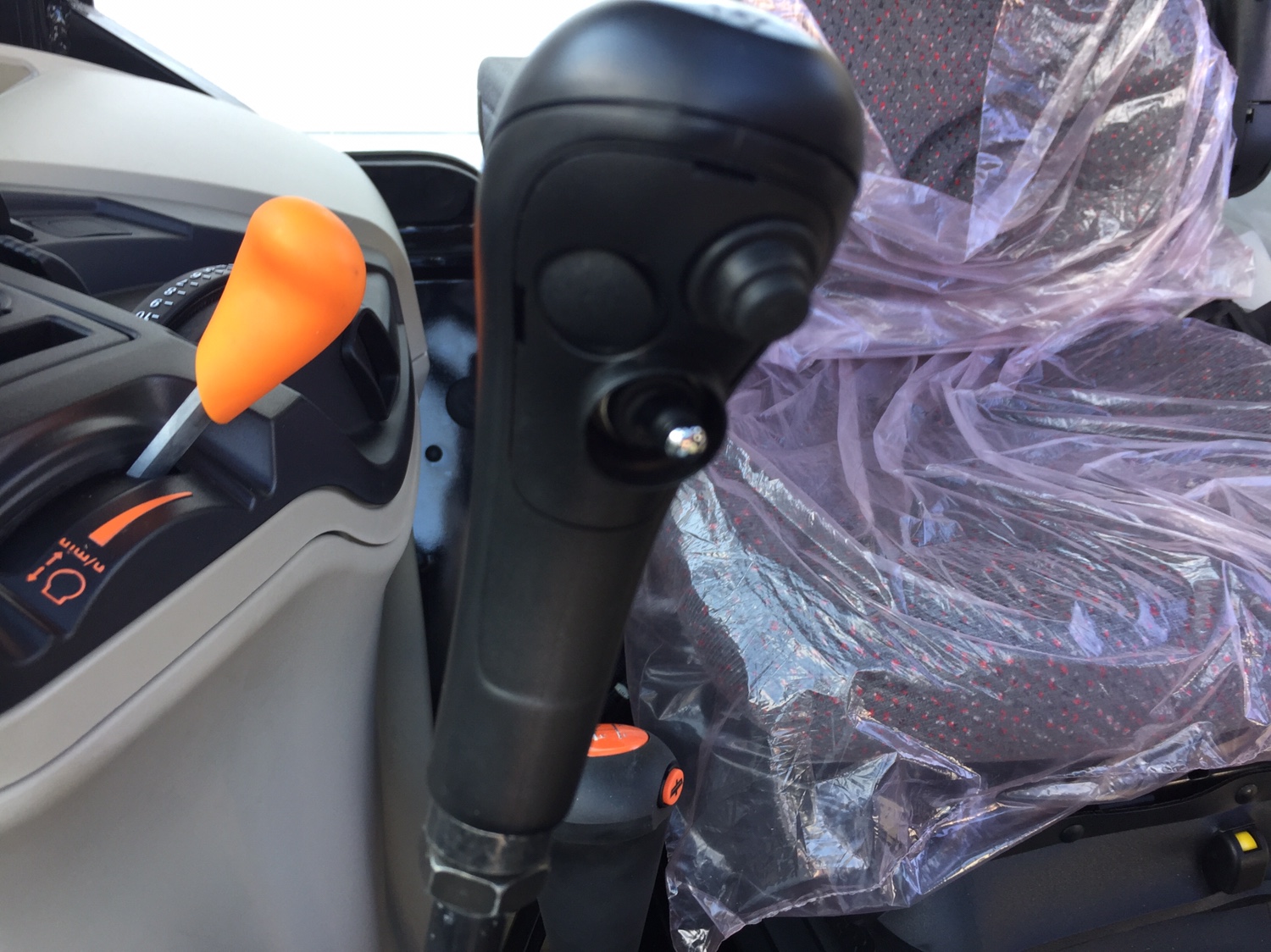

The MF appears to be a double button setup vs a rocker. Same functionality to me, used them both, no preferences.

There is only one button. This picture is with the diverter installed.
I guess they make the joystick for the larger models also and add another button but not on the 47xx series. I’m not sure why they don’t on this one, but they don’t. I’m just used to using a rocker vs one button and losing dump/curl. I’m sure I could learn, just prefer the other.
