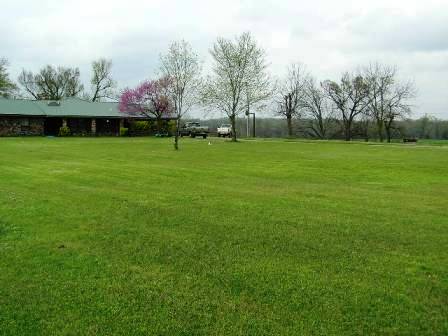

If you can buy a good used 4710 for 15K, you can't go wrong. That price would be about 5 to 6,000 off the price of a new one (that is if you got a good deal on a new one). After you buy it and decided it was too big, I guarantee you can at least get your money back but probably more.
I don't know about your soil condition but I mow with a JD 4610, which is the same tractor except the 4710 has about 4 more horsepower. Attached is a pic of my yard, mowed with the 4610 and a Landpride RFM.
The 460 FEL will set you back about 3,500 or so but never priced an MMM.
