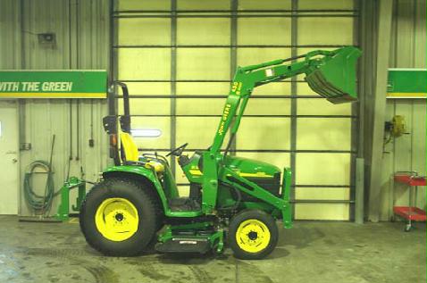

admitting first of all that I am a moron
Now, you gave me length, right, and I had in my prior post width.
correct?
thanks
eric (moron)
   / 4710 vs 4210 vs 2210: is it worth it? #32
Your previous post is length. For example, there are 68 inches of length between the point at which the front wheel of the 4310 touches the ground and the point at which the rear wheel touches the ground.
I'll attach a pic of a side shot of a 4310. See where the front wheel touches the ground? Now look at the rear wheel. Do you see where the rear wheel touches the ground? There is 68 inches between them. The machine overall is 117 inches.
Here are the widths:
Overall Width (Minimum)
4210= 56.3 in
4310= 50 in.
4710= 65.8 in.
Hope this helps. /forums/images/graemlins/smile.gif
