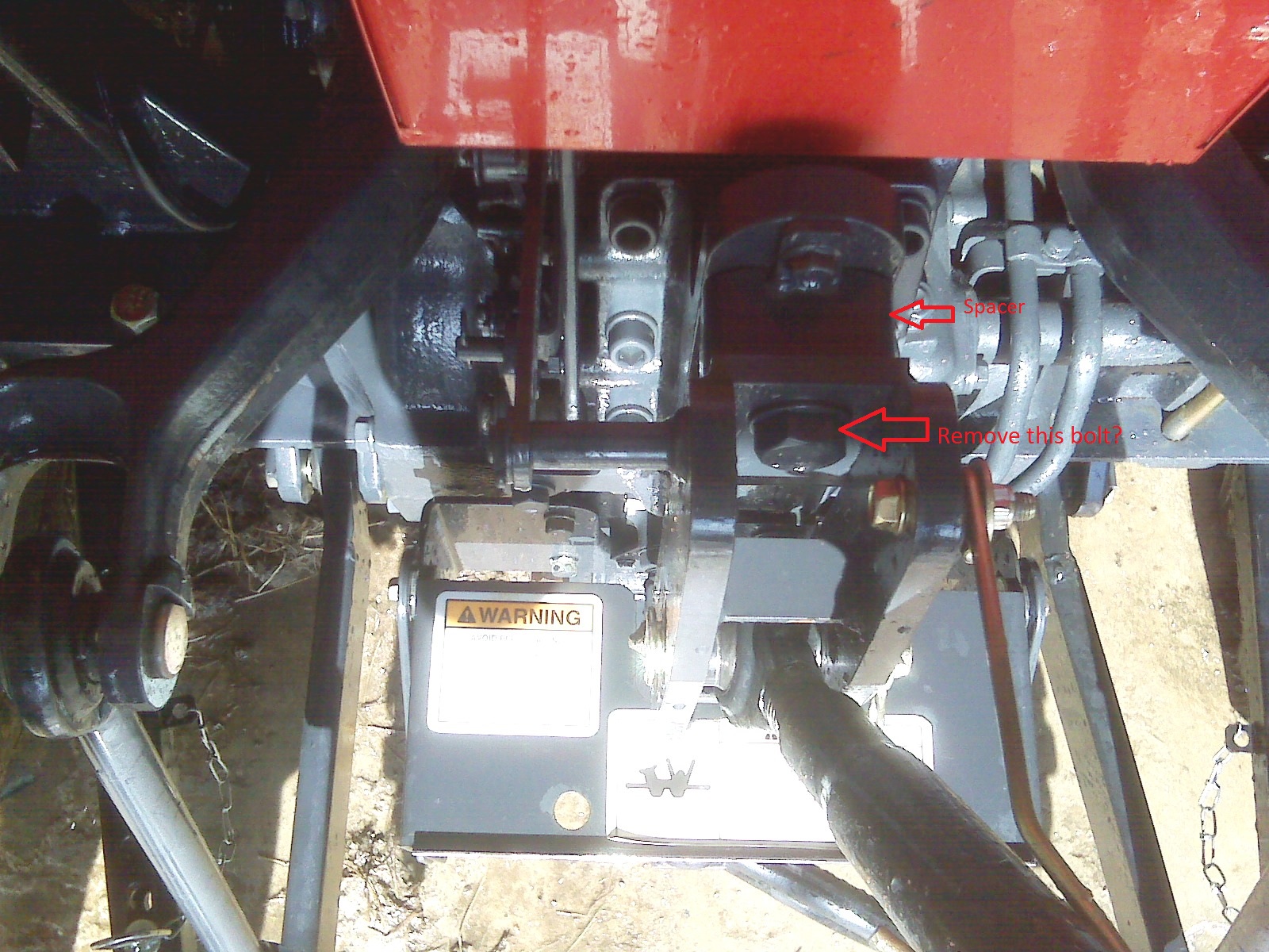

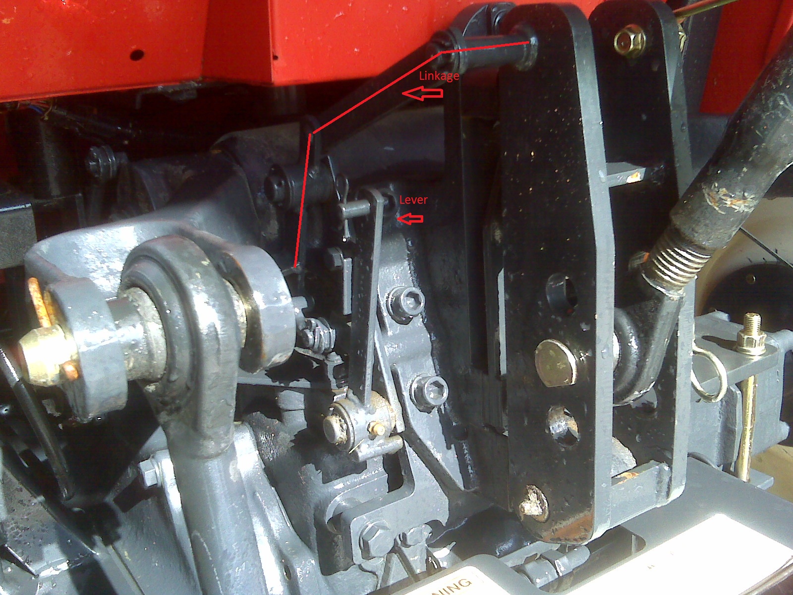

Maybe this will help. I have marked the lever that can be operated by hand. It is connected to the top link mount via linkage, but only the lever can be moved. It appears that a "spacer" needs removed in order to allow the top link mount to move, which would operate the linkage. Maybe remove the bolt that I marked and remove the "spacer"?
You may have to zoom in on the photos.

It looks to me like the tab under the smaller upper bolt is welded to the spacer.
There is likely an internal spring mechanism that pushes out against the yoke to lower the arms when the draft decreases. The larger bolt is likely to be what holds the yoke against the spring mechanism.
Look closely to see if the smaller top bolt is the one to remove.
Maybe not remove but loosen it and swing the "spacer" out of the way of the yoke.

Well, I removed the small bolt one day, but the spacer was too tight to remove or swing out of the way. It appears to be pinched and I would need to loosen the larger bolt. I didn't have the right socket to loosen it that day and have basically forgotten about it since. I am going to be there on Sunday, so I will check it out and let you know.

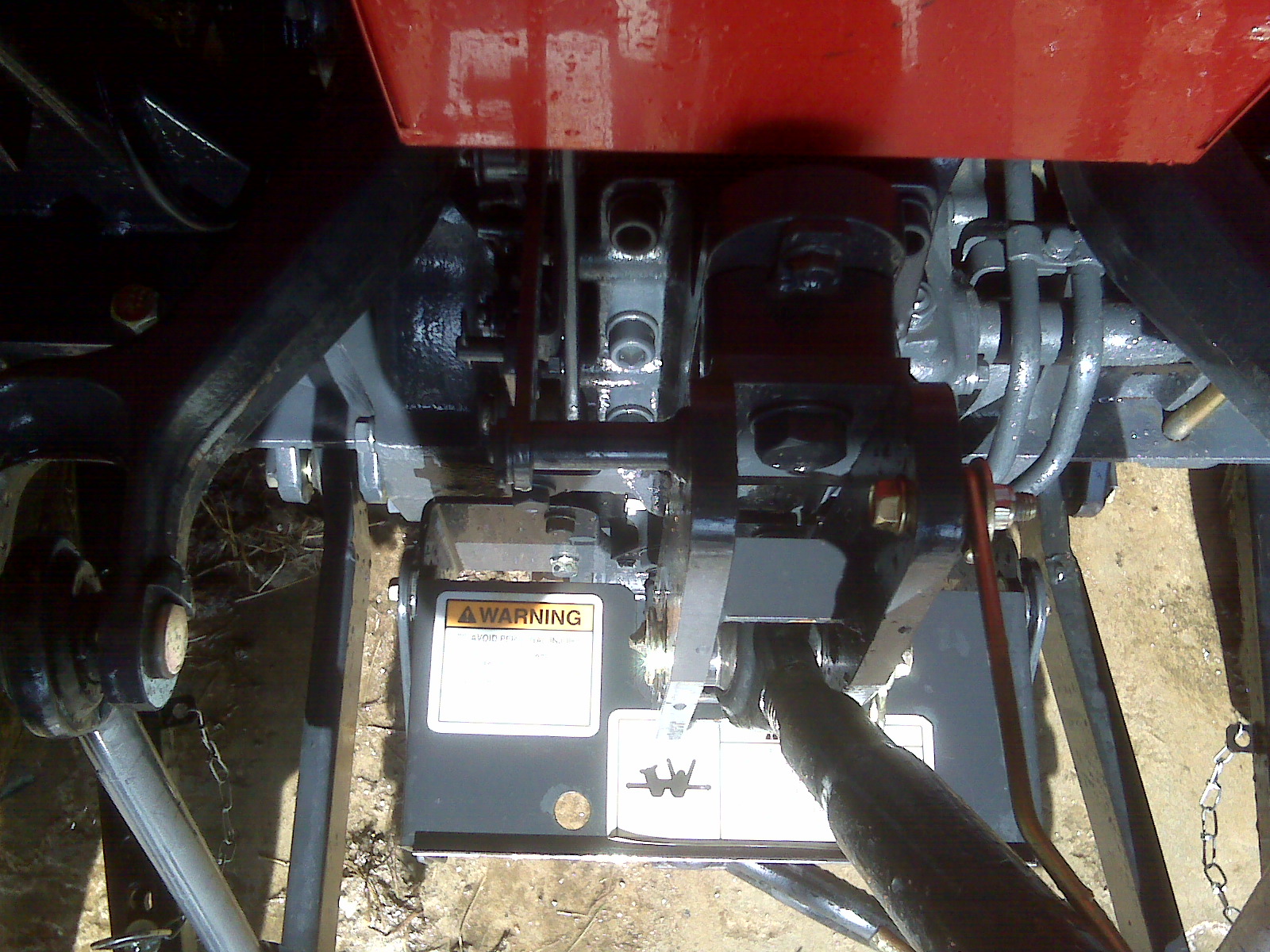

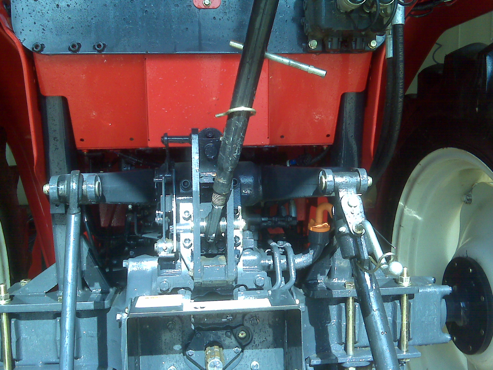

Took out the small bolt and loosened the large one (there is a nut on the back side). I was able to get the spacer out and it appears this unlocks the draft control. I didn't have time to try it out, but it looks like it will work fine.
