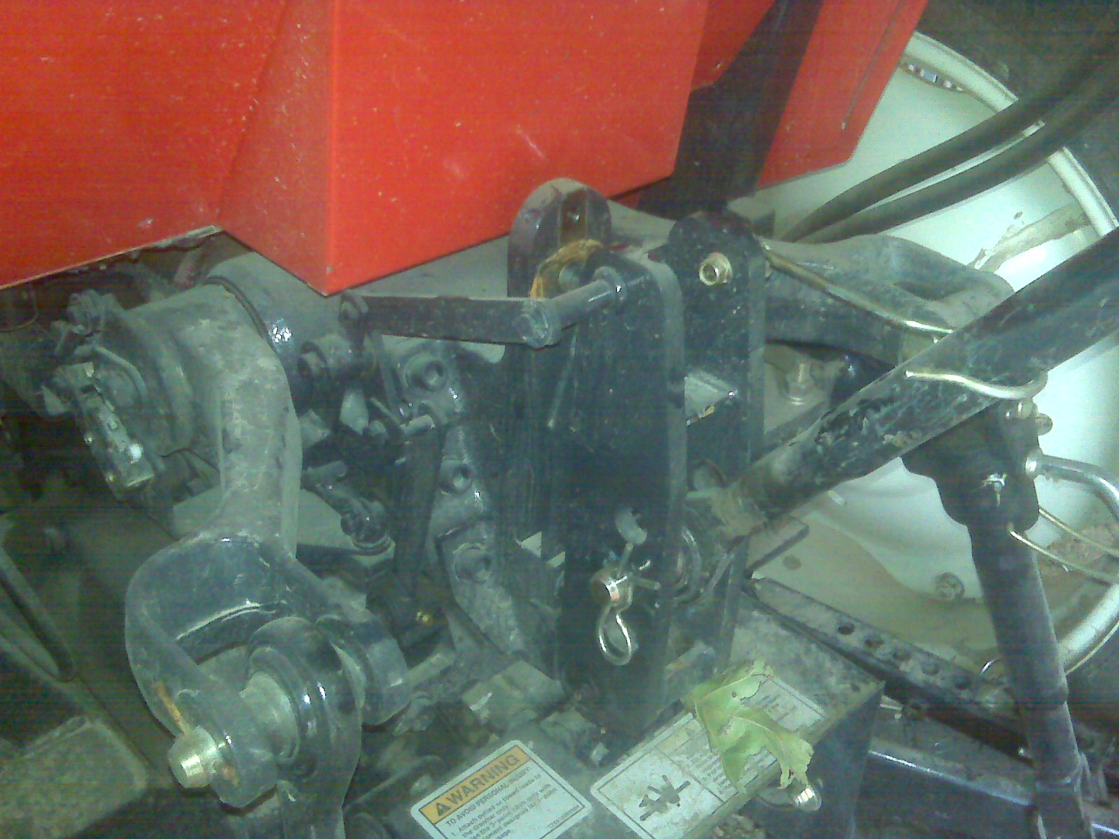

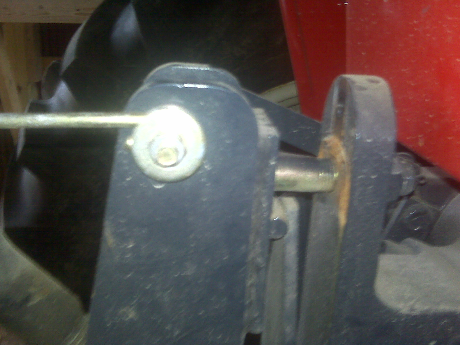

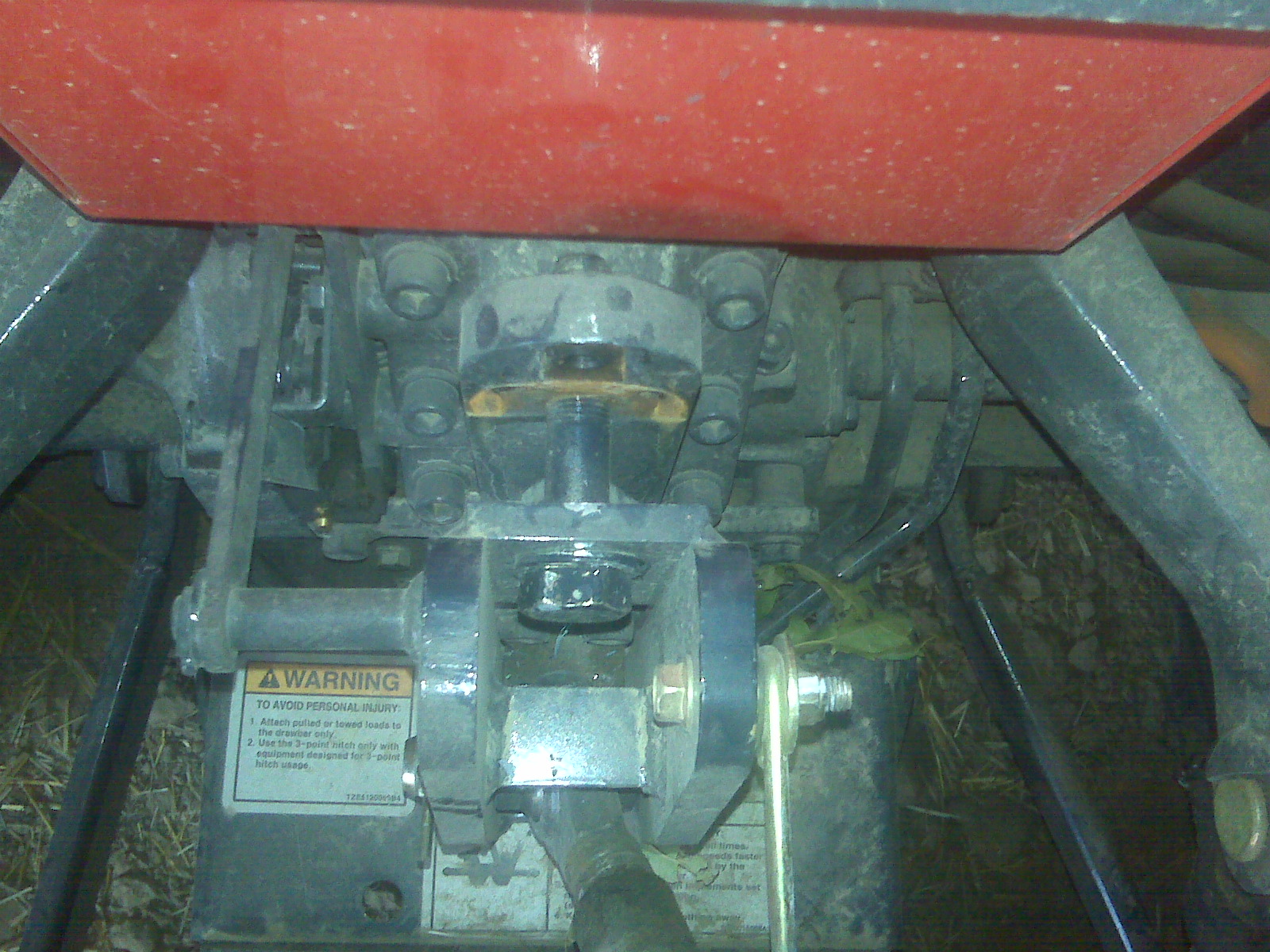

Took out the small bolt and loosened the large one (there is a nut on the back side). I was able to get the spacer out and it appears this unlocks the draft control. I didn't have time to try it out, but it looks like it will work fine.
1st pic is view from top, 2nd pic is view from right side, 3rd is left side, 4th is bonus pic of my daughter shopping at the farm store (apparently she needs a new tape measure)

I'm still on the site, just not very active. The procedure described does enable the draft control.
