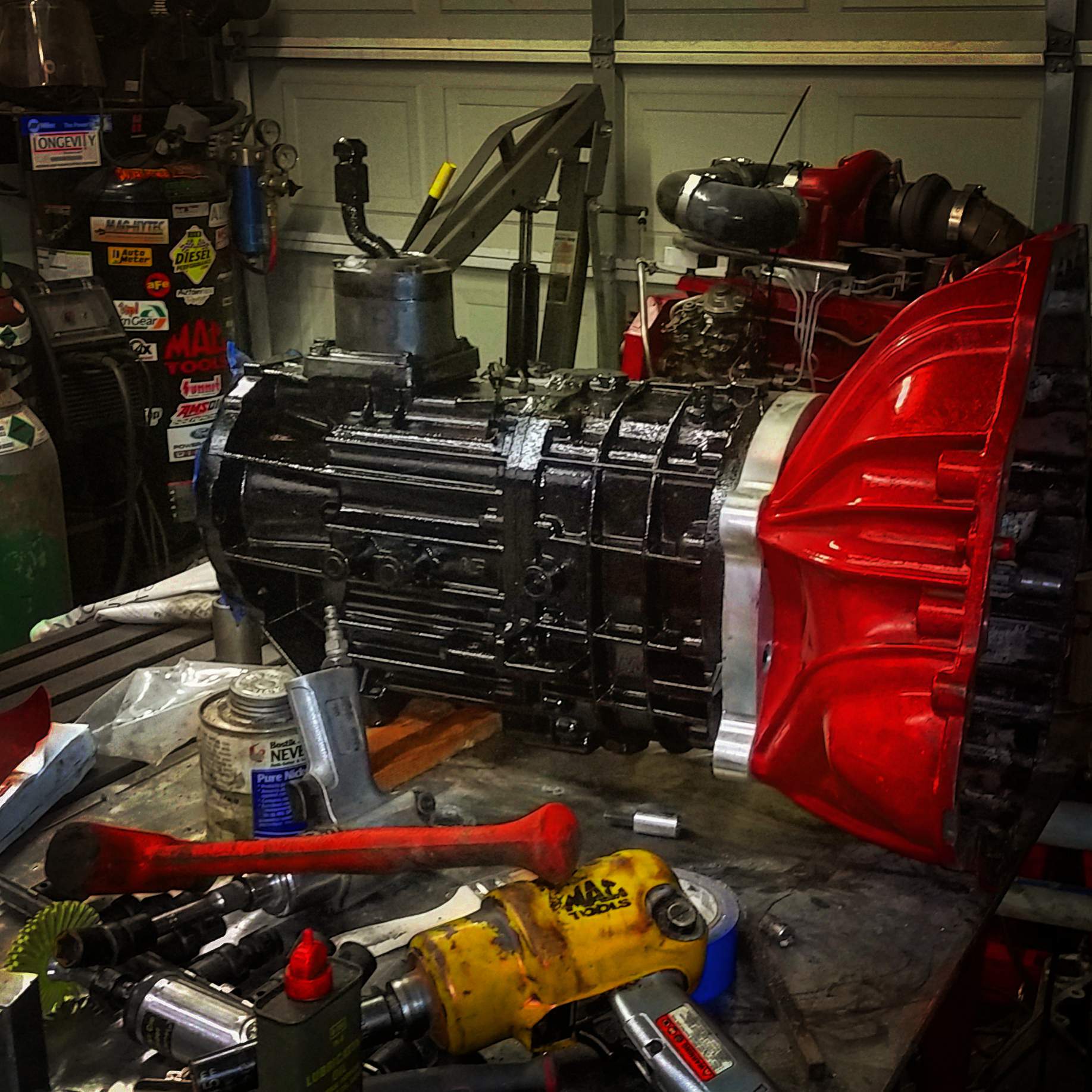

This is the clutch I am using

Here a different angle

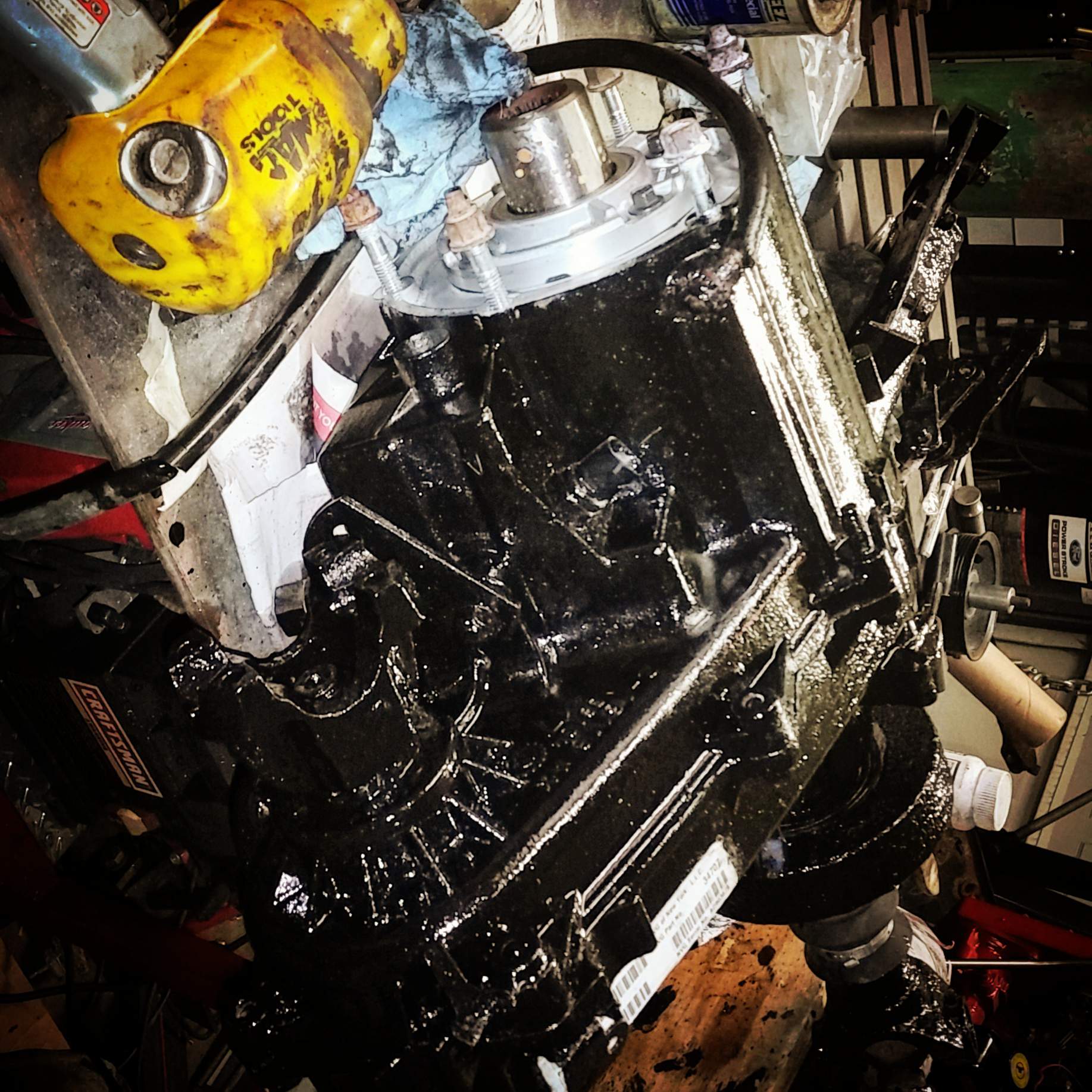

Coated the transfer case with por15
   / 4bt cummins jeep tj #145
The tranny and transfer case look good painted black. The clutch looks good, who makes it?

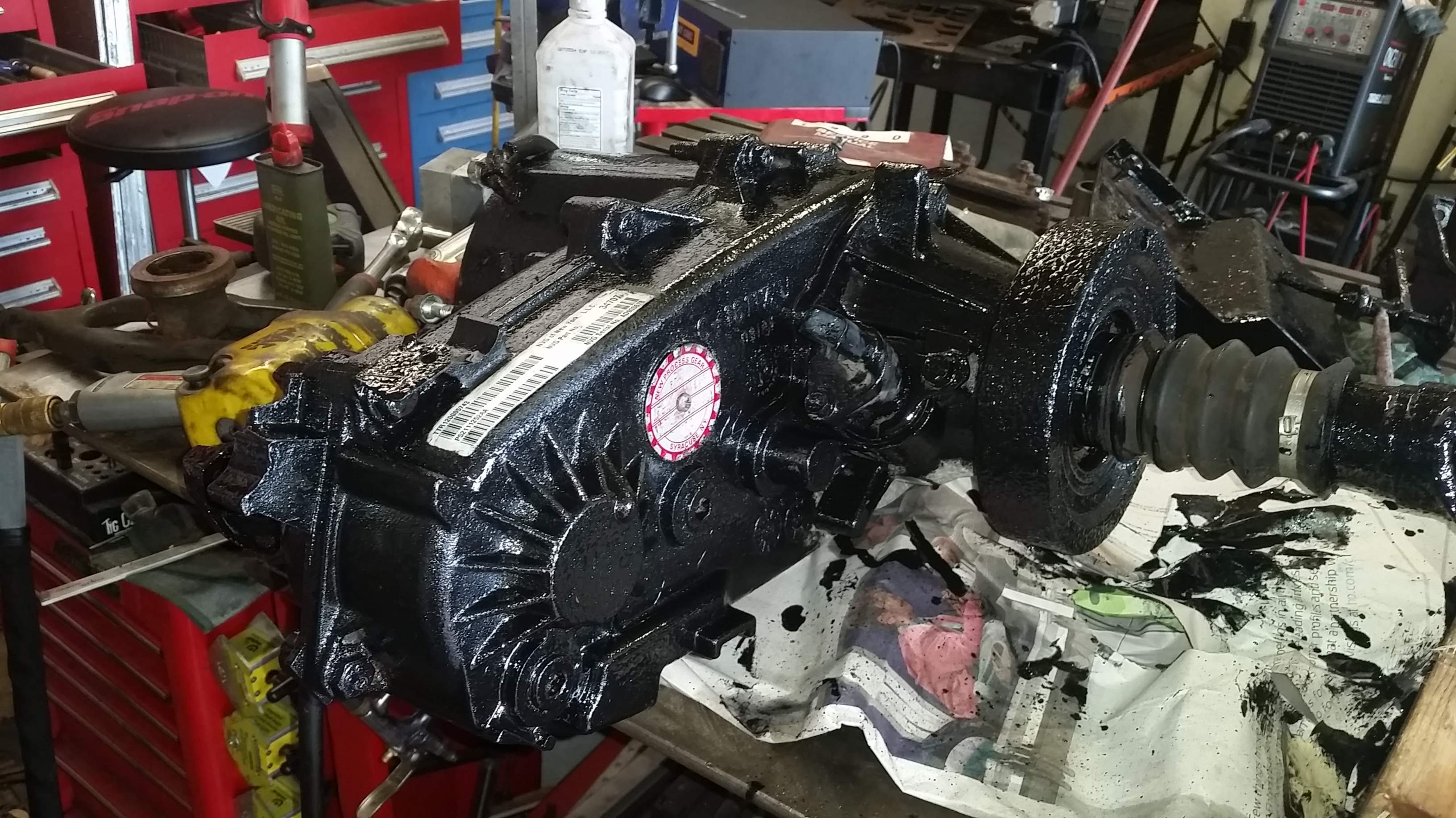

#147
A different angle

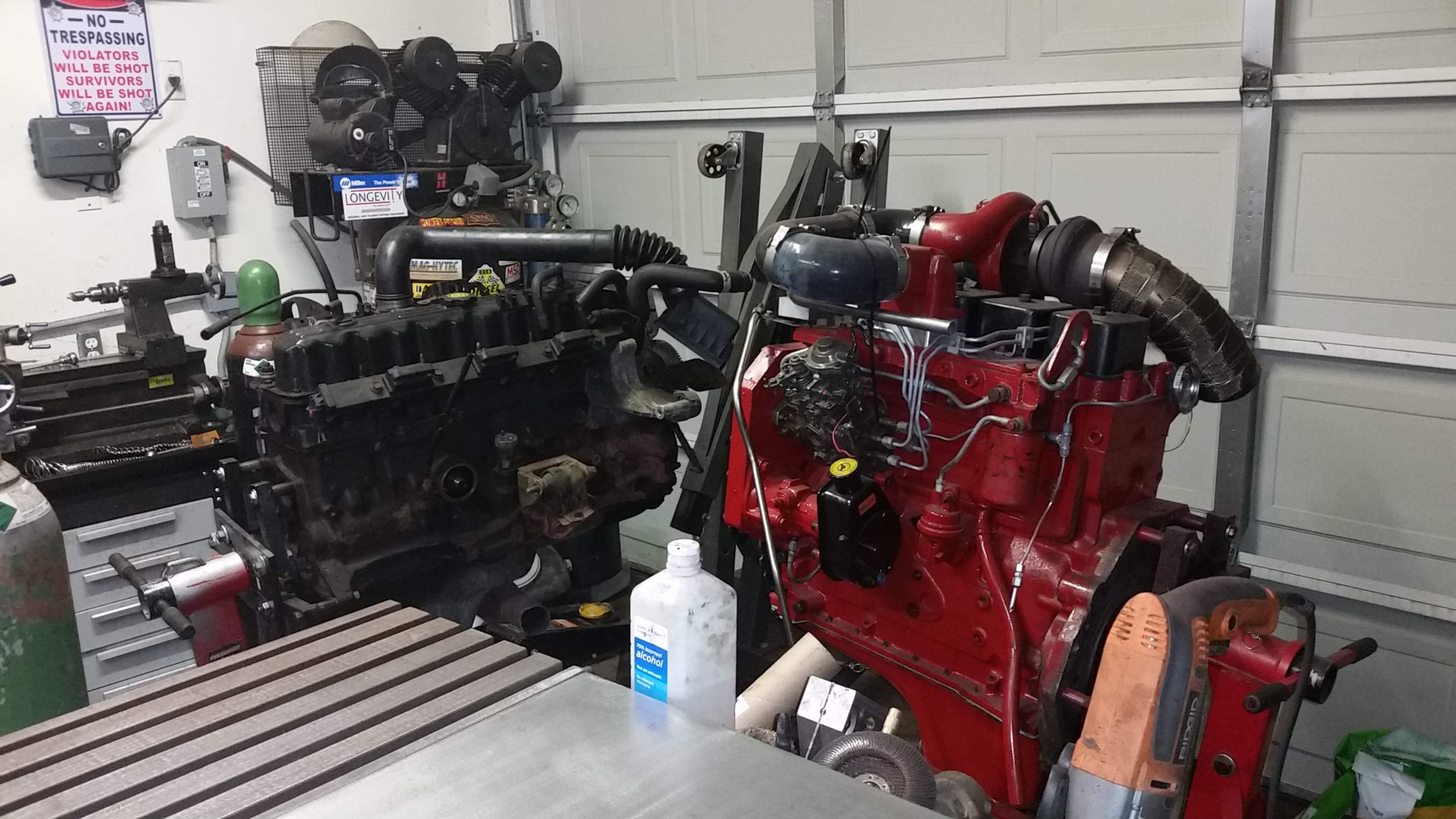

Face off.
   / 4bt cummins jeep tj #150
Good picture, it really shows the big difference between the gas 6 cylinder and the diesel 4 cylinder.
