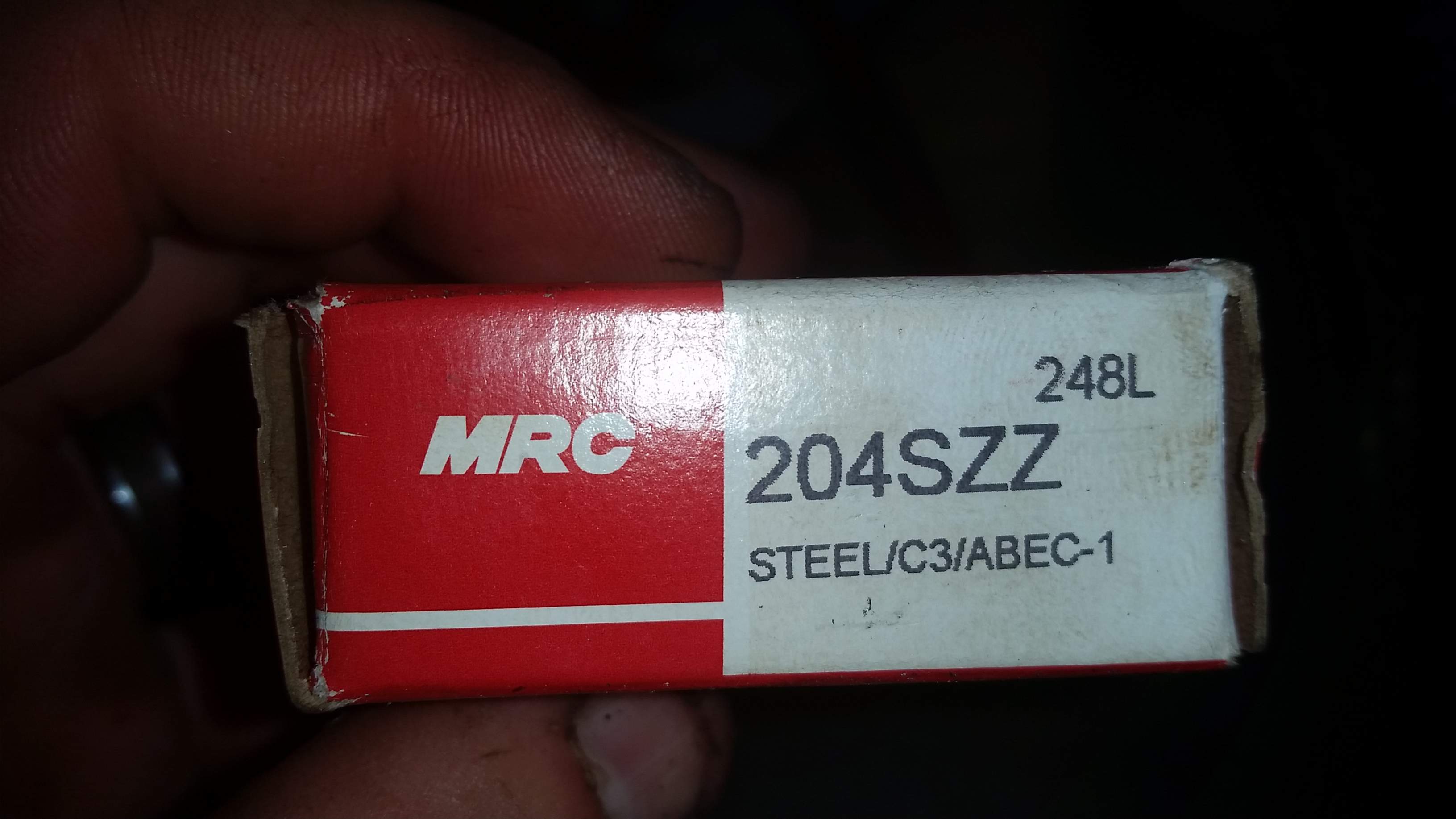

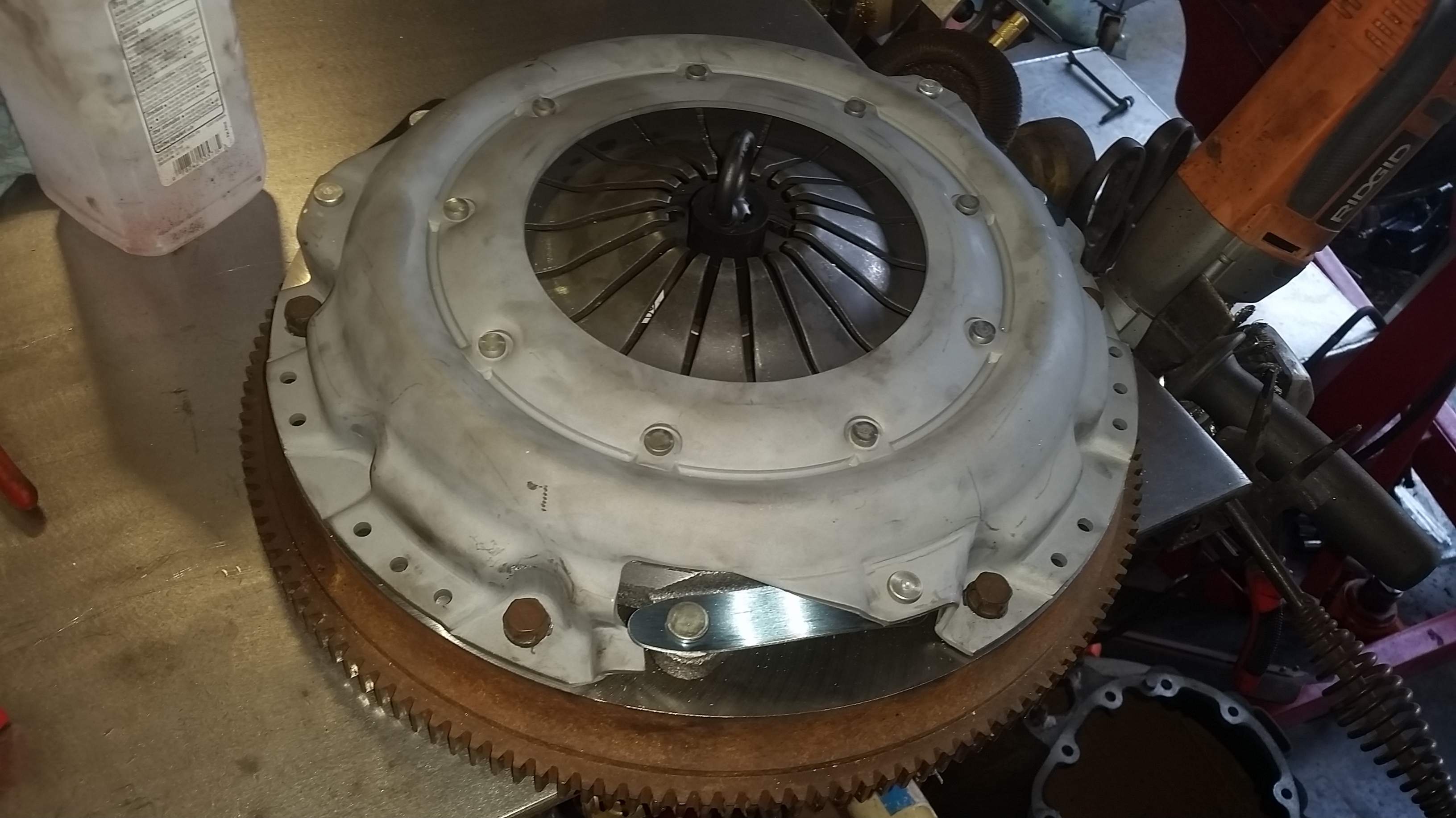

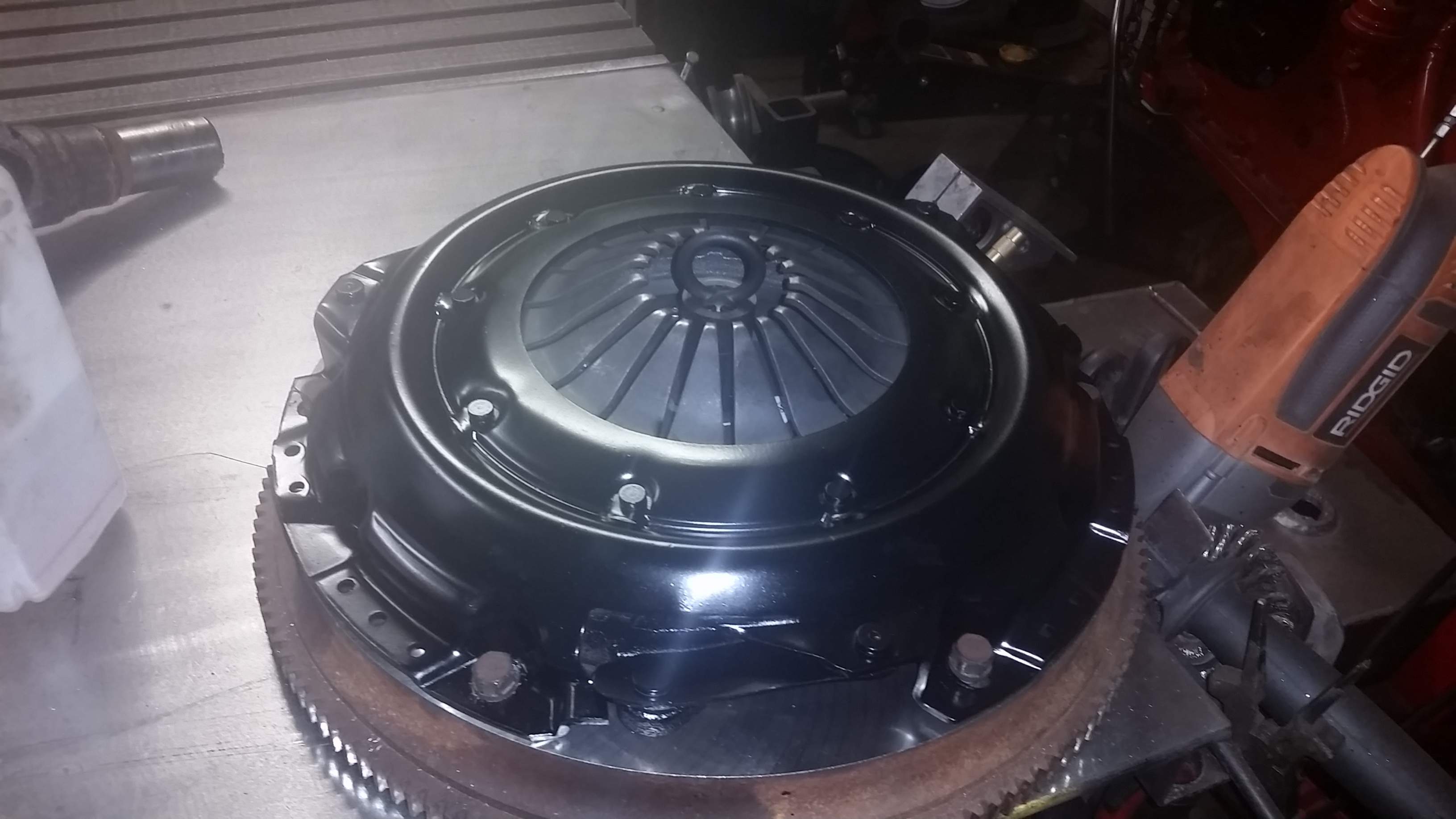

Got the flywheel back from the machine shop and went to work on the clutch, I sourced a new pilot bearing from the local bearing supply but the minor diameter is 1mm to large so I made a bushing and pressed it into the bearing but has a good slip fit over the input shaft

Here is a better look at the pilot bearing

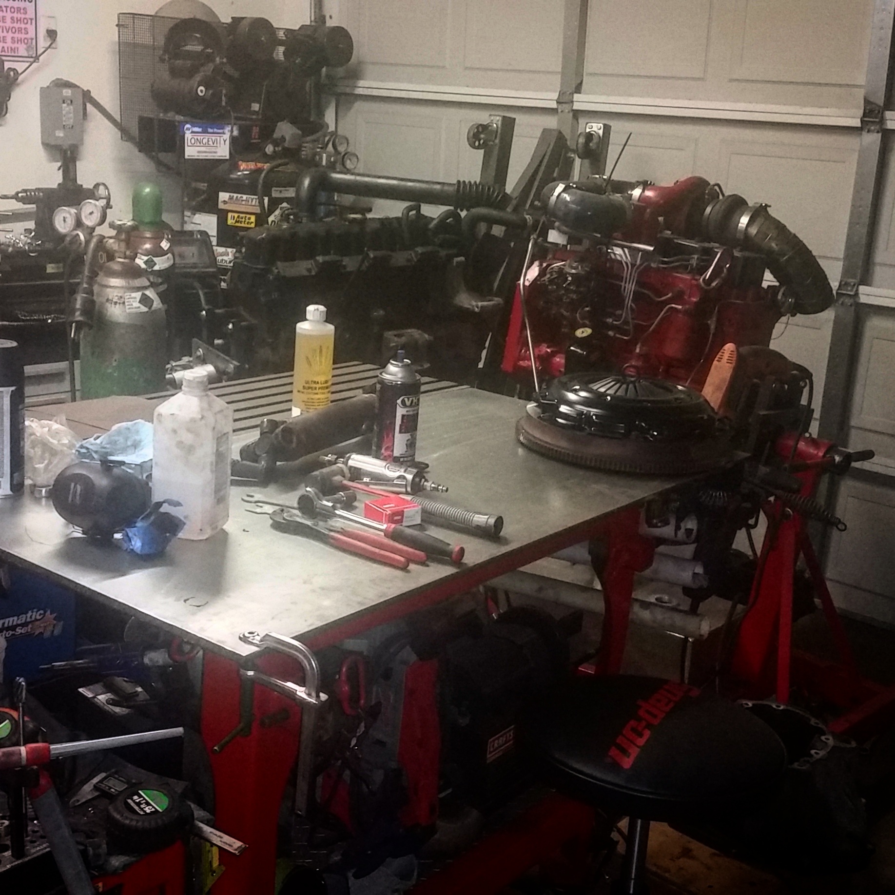

   / 4bt cummins jeep tj
#154
It's getting crowded in here.
