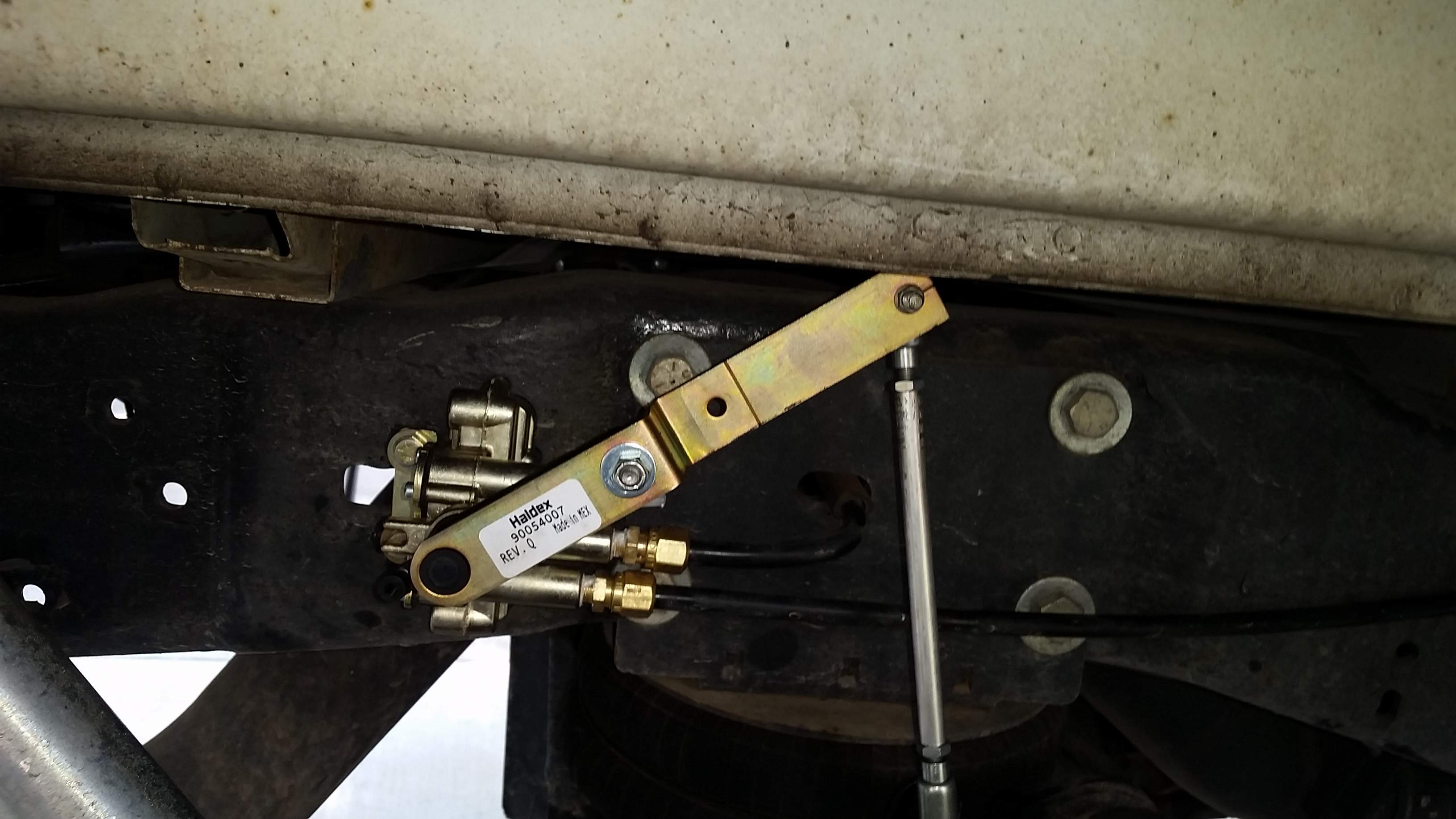

Aug 29, 2015 / 4bt cummins jeep tj Thread Starter #191 OP dzljon Advertiser Joined Jan 11, 2015 Messages 304 Location Jacksonville florida Tractor none Cost is not a big concern, it is more about the challenge and education. it is aired up using shop air to tune ride height and check for leaks Attachments 20150828_183054.jpg 568.5 KB · Views: 236 20150828_170457.jpg 303.2 KB · Views: 217

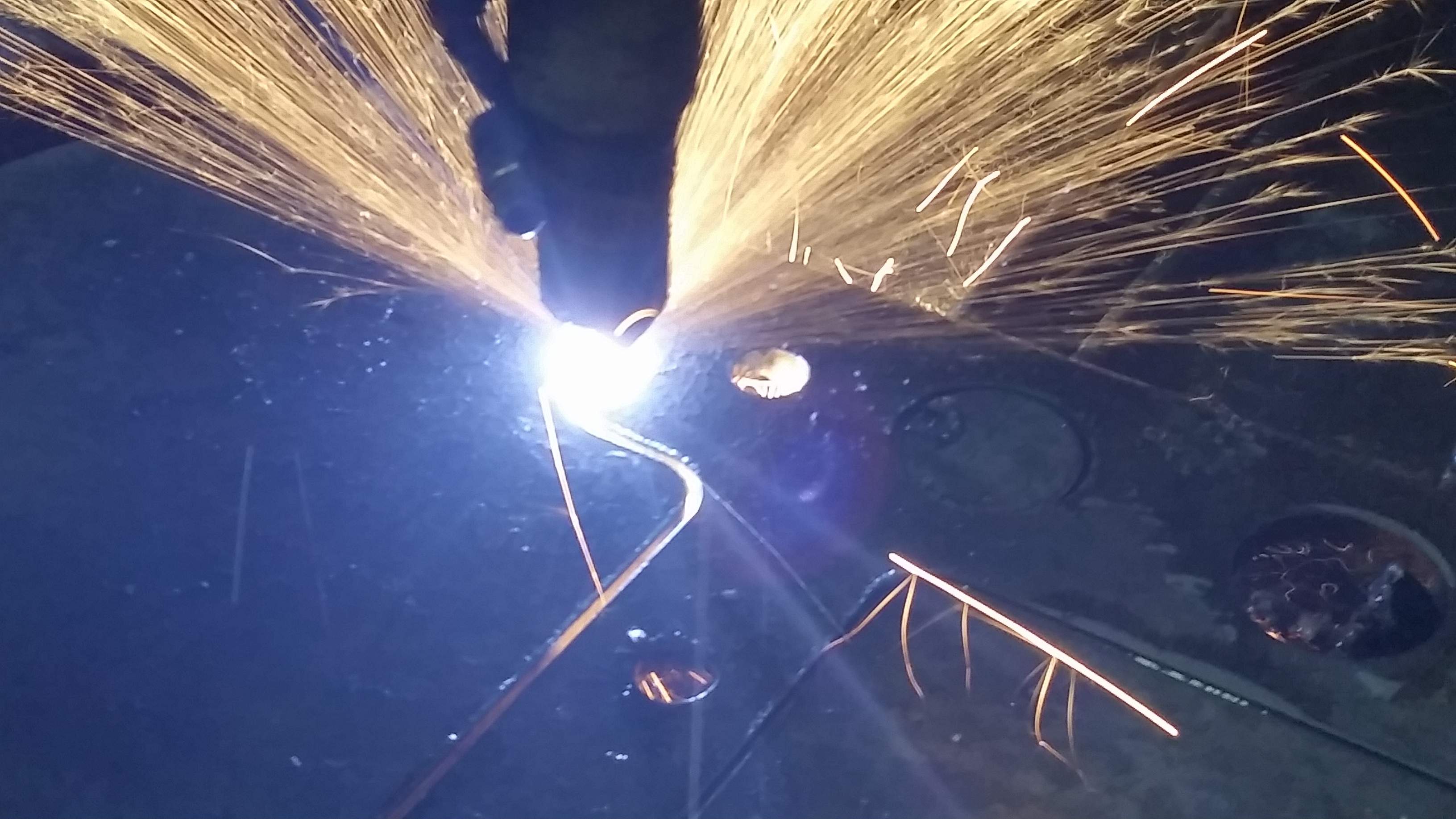

Aug 30, 2015 / 4bt cummins jeep tj Thread Starter #192 OP dzljon Advertiser Joined Jan 11, 2015 Messages 304 Location Jacksonville florida Tractor none Cutting action Attachments 20150824_165258(0).jpg 396.5 KB · Views: 199

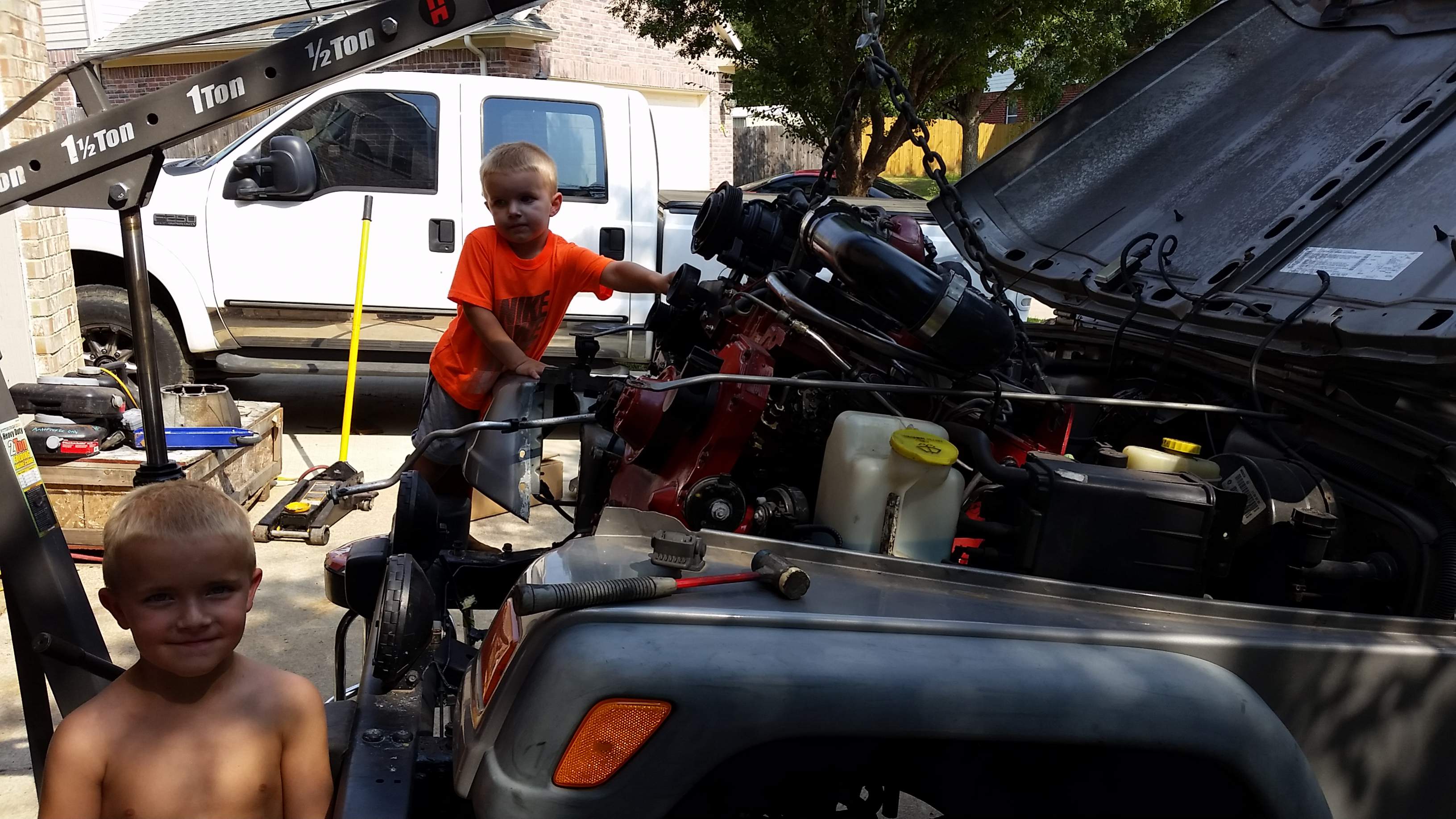

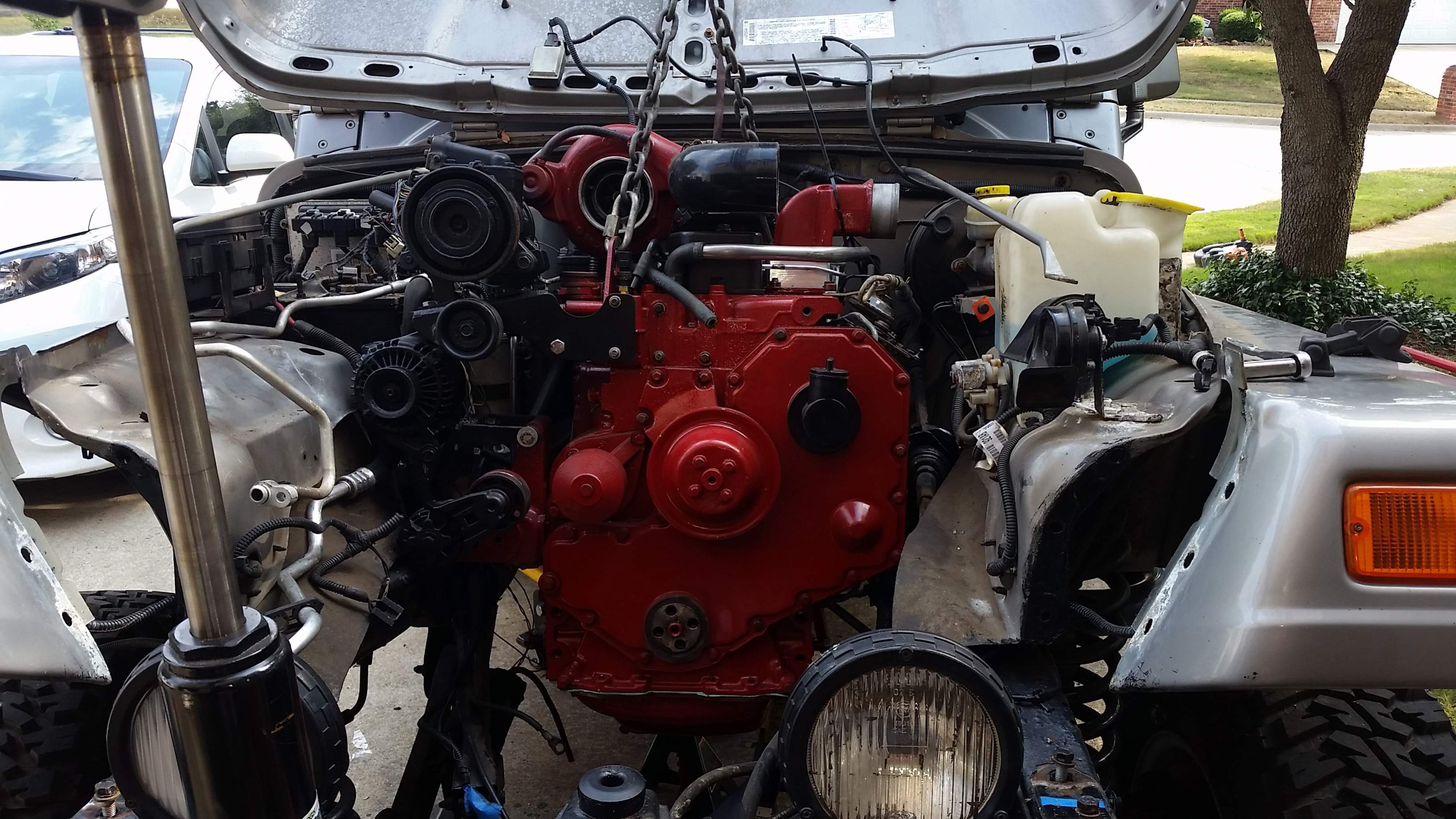

Aug 30, 2015 / 4bt cummins jeep tj Thread Starter #193 OP dzljon Advertiser Joined Jan 11, 2015 Messages 304 Location Jacksonville florida Tractor none 4bt is going in Attachments 20150830_163013.jpg 566 KB · Views: 271 20150830_160327.jpg 645.2 KB · Views: 254 20150830_160314.jpg 543.3 KB · Views: 311
Aug 30, 2015 / 4bt cummins jeep tj #194 wmonroe Elite Member Joined Nov 12, 2005 Messages 3,499 Location Southwestern, PA Tractor 1958 Ford 961 Powermaster The 4BT looks at home going into the jeep. Your boys look like they are enjoying it too.

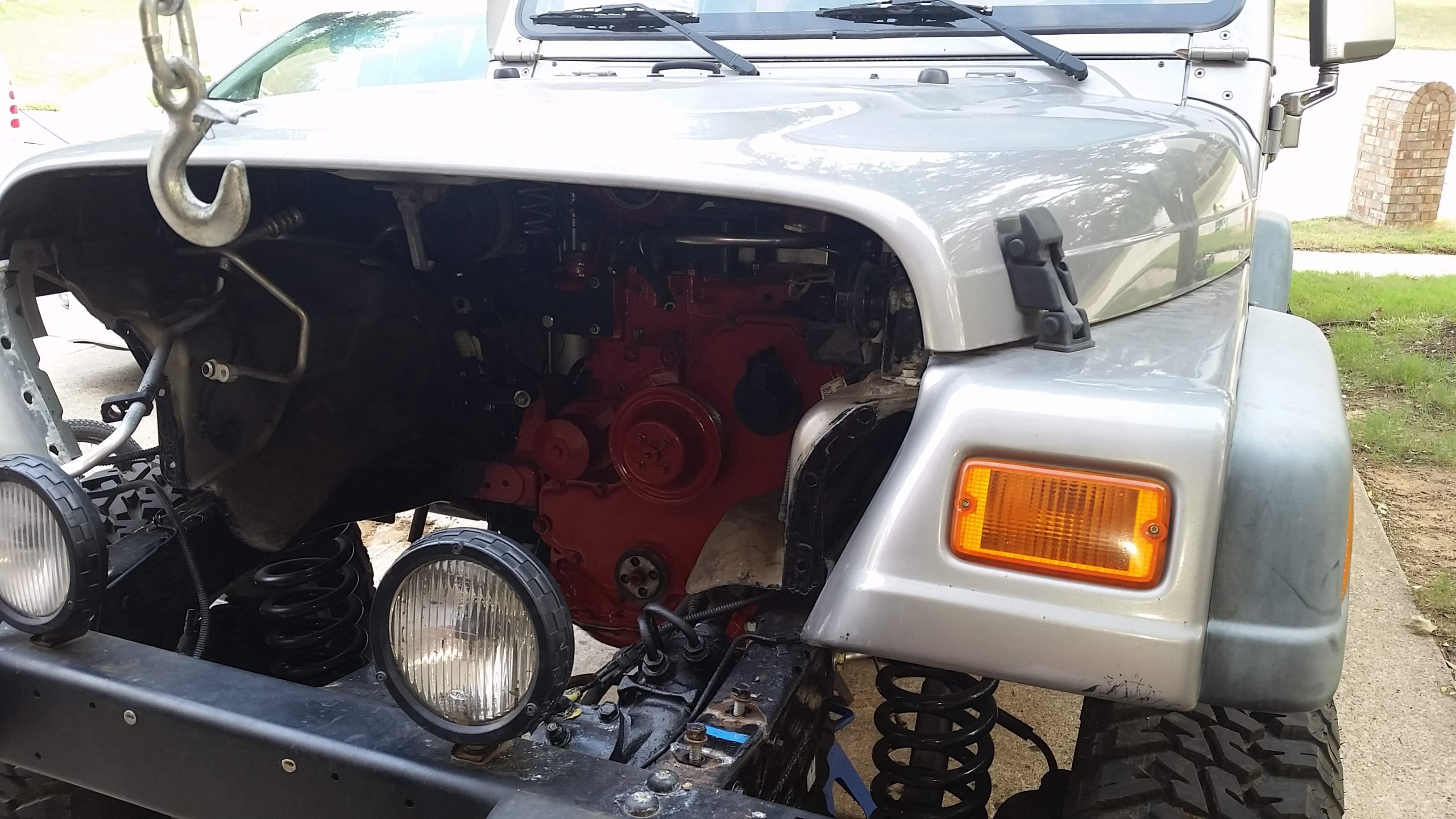

Aug 30, 2015 / 4bt cummins jeep tj Thread Starter #195 OP dzljon Advertiser Joined Jan 11, 2015 Messages 304 Location Jacksonville florida Tractor none Hood is closed but still new to build motor mounts Attachments 20150830_182558.jpg 472.4 KB · Views: 251 20150830_182605.jpg 302 KB · Views: 233

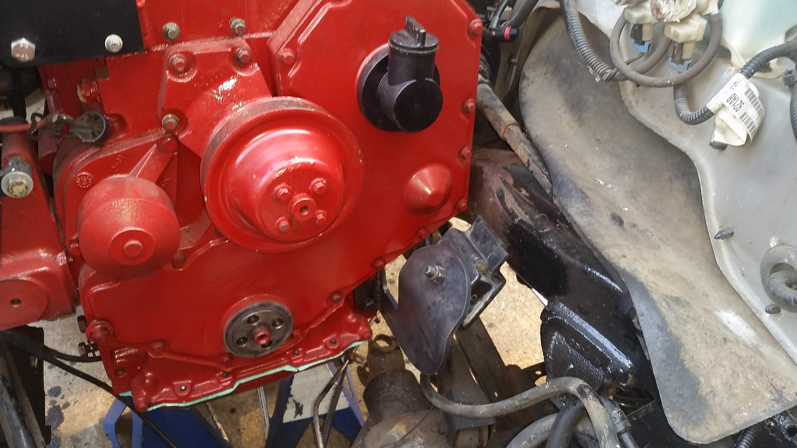

Aug 31, 2015 / 4bt cummins jeep tj Thread Starter #196 OP dzljon Advertiser Joined Jan 11, 2015 Messages 304 Location Jacksonville florida Tractor none Started motor mounts but there are lots to do still Attachments 20150831_181107.jpg 394 KB · Views: 224

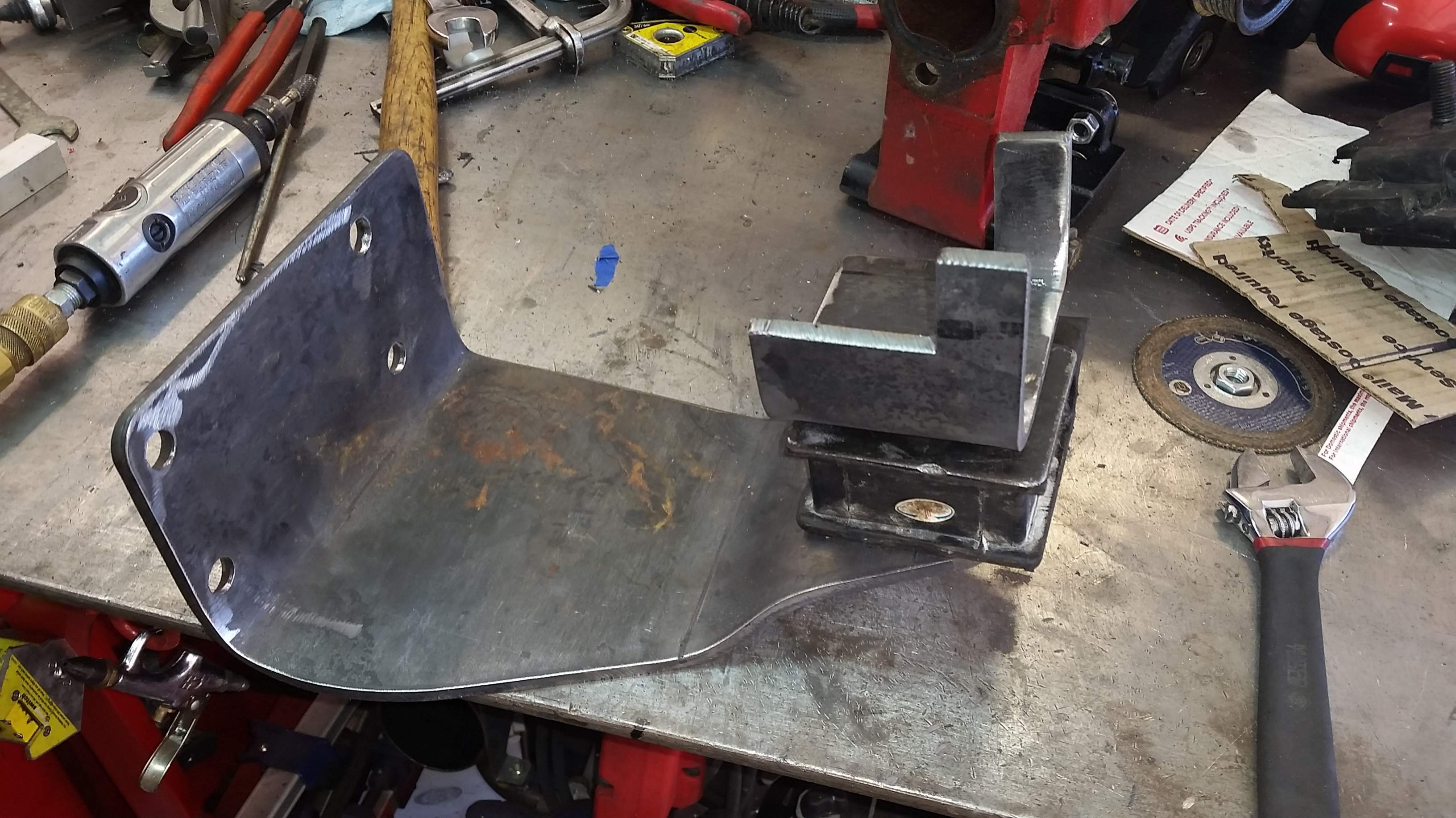

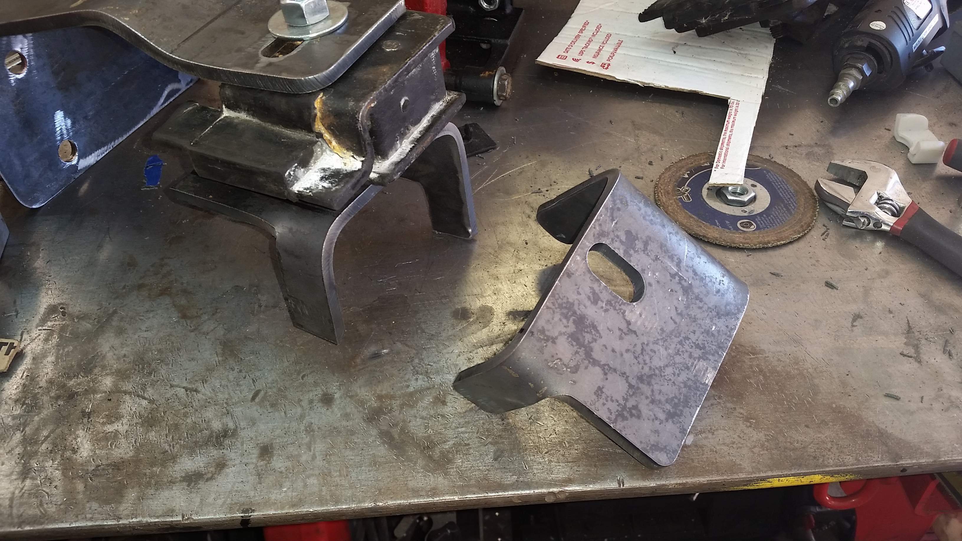

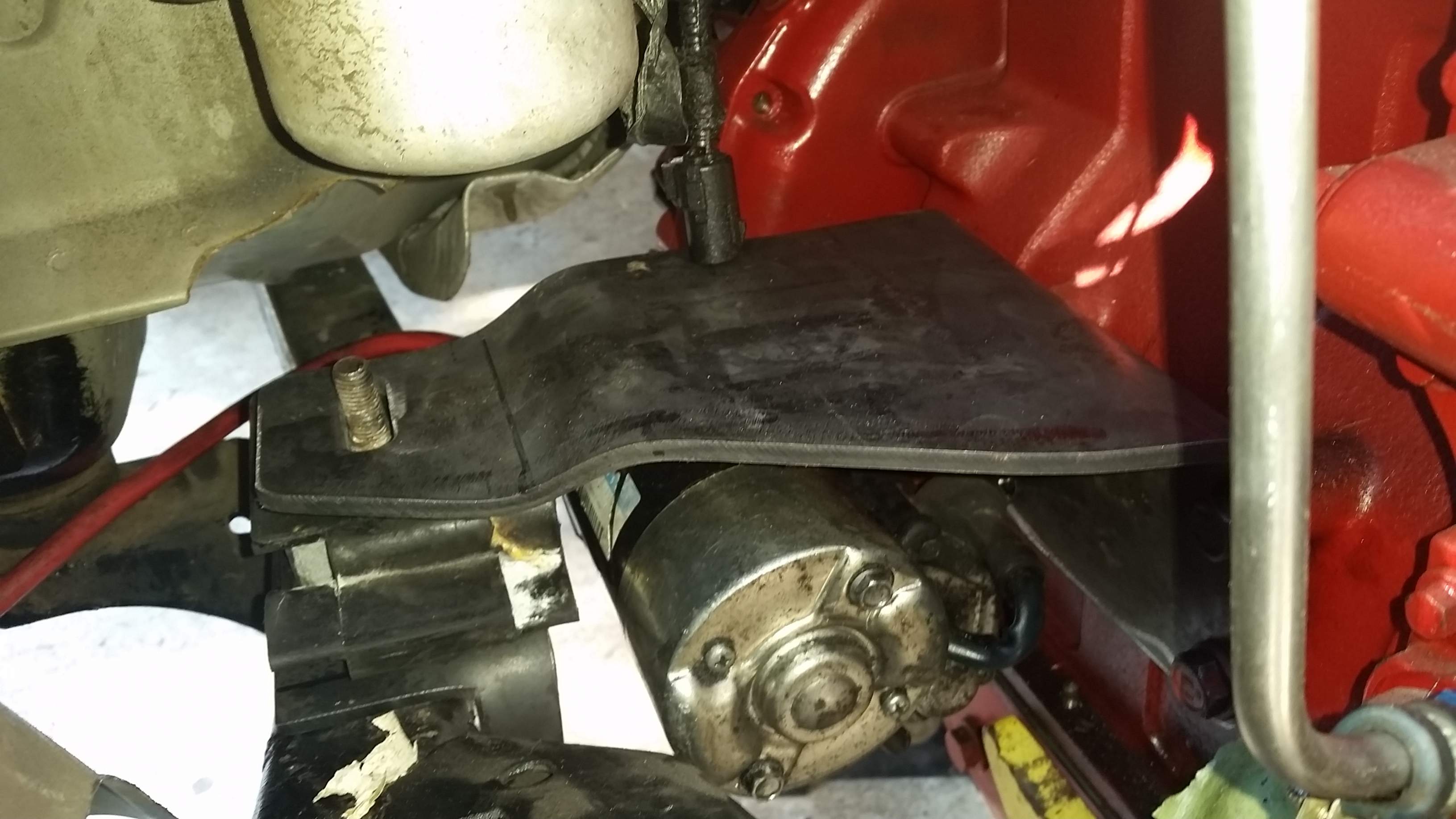

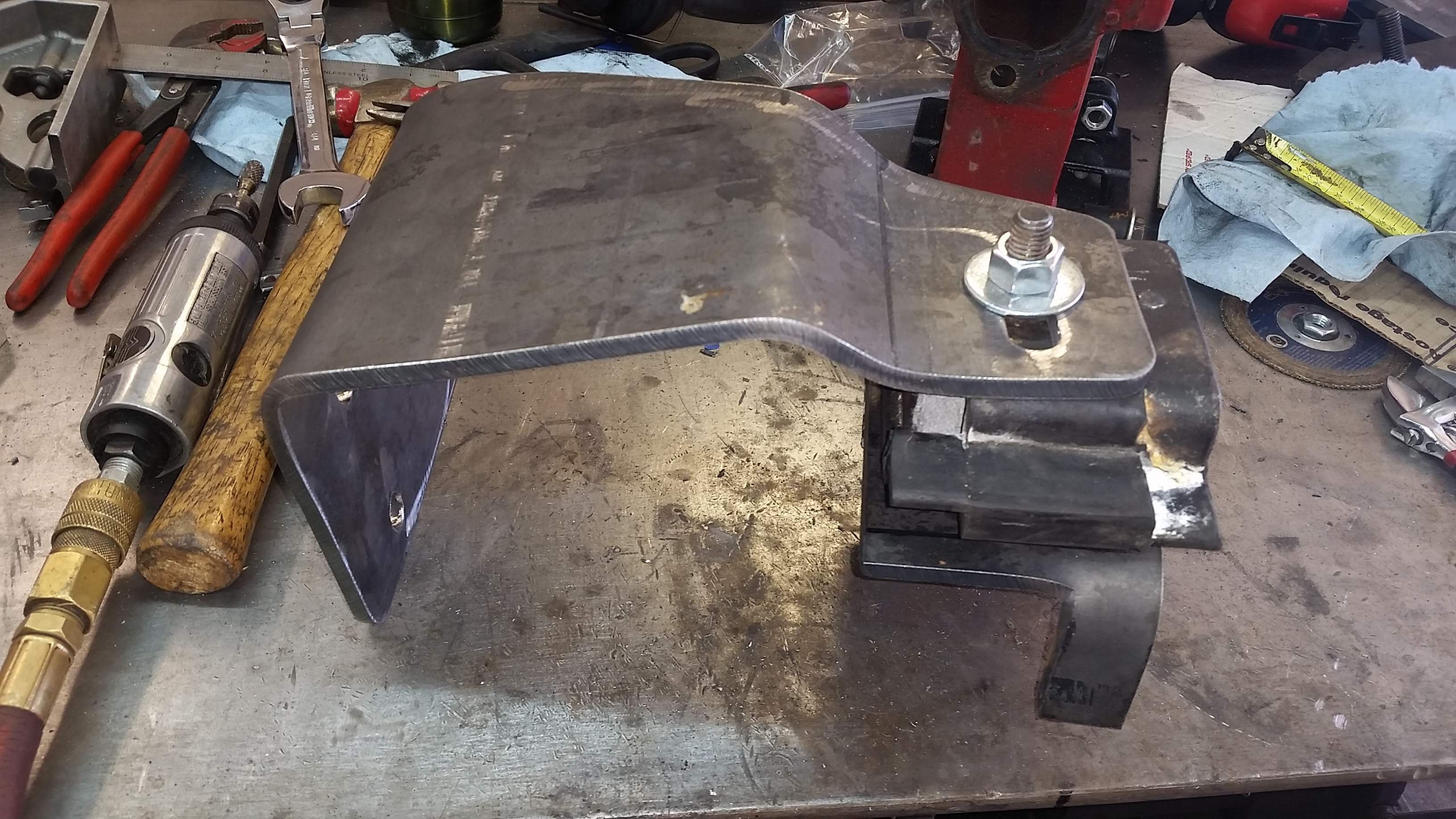

Sep 2, 2015 / 4bt cummins jeep tj Thread Starter #198 OP dzljon Advertiser Joined Jan 11, 2015 Messages 304 Location Jacksonville florida Tractor none Motor mount take 2 Attachments 20150902_094614.jpg 329.1 KB · Views: 217

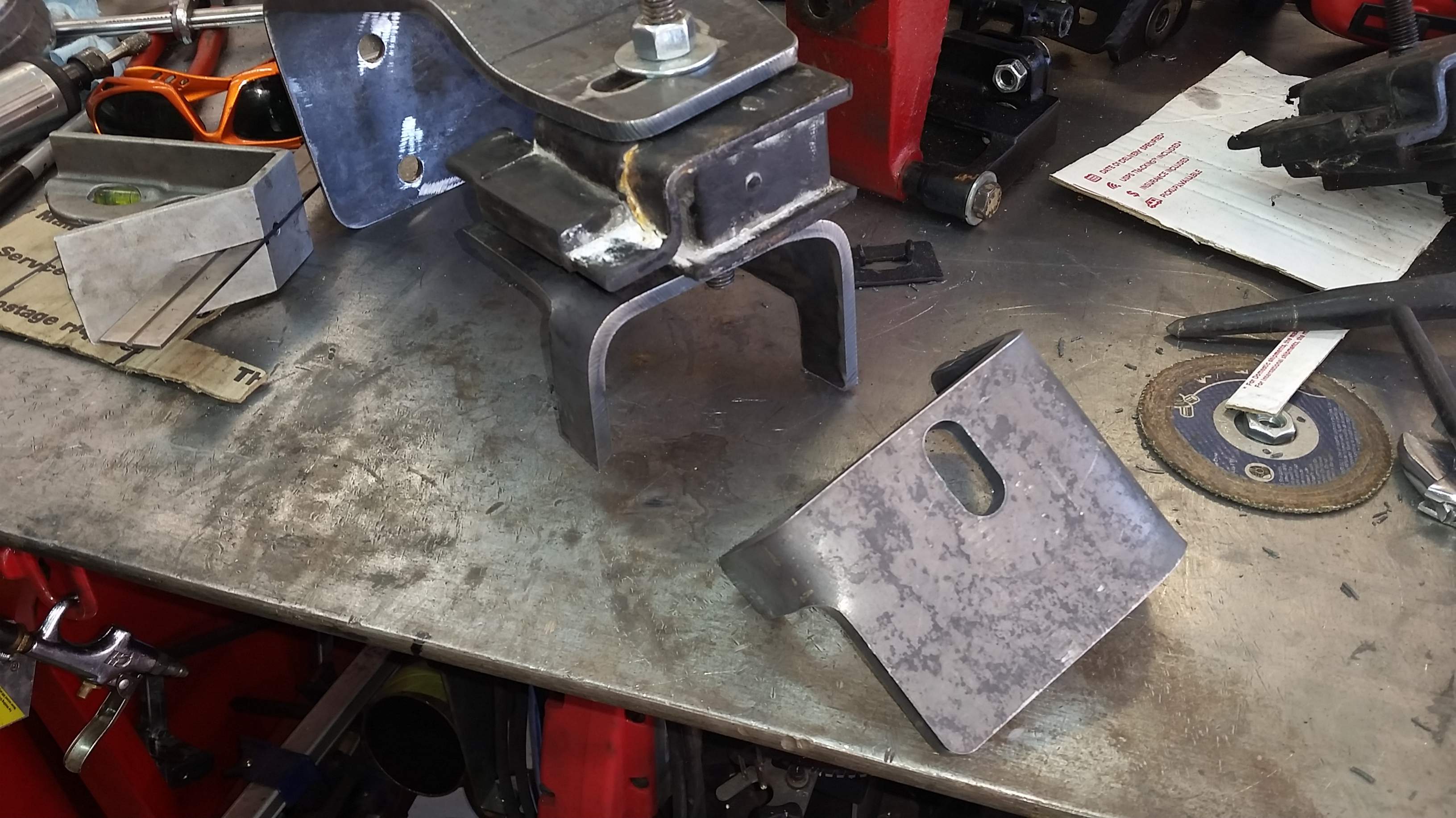

Sep 2, 2015 / 4bt cummins jeep tj Thread Starter #199 OP dzljon Advertiser Joined Jan 11, 2015 Messages 304 Location Jacksonville florida Tractor none Started the 4bt cummins motor mounts Attachments 20150902_094614.jpg 329.1 KB · Views: 193 20150902_101415.jpg 564 KB · Views: 203 20150902_101516.jpg 507.2 KB · Views: 201 20150902_111950.jpg 482.3 KB · Views: 186 20150902_112048.jpg 590.1 KB · Views: 192 Last edited: Sep 3, 2015
Sep 3, 2015 / 4bt cummins jeep tj #200 N NorEaster Member Joined Aug 24, 2014 Messages 38 Location Brunswick, ME Tractor 1993 Kubota 5200 dzljon said: Started the 4bt cummins motor mounts Click to expand... Are you going to use any triangular bracing on those? 4BT is around 800 dry, combine that with the forces of trail riding and you might see a failure. I used 1/2" thick angle plus 1/2" bracing for mounting the 6BT into my Ford, it's supporting two turbos as well.
