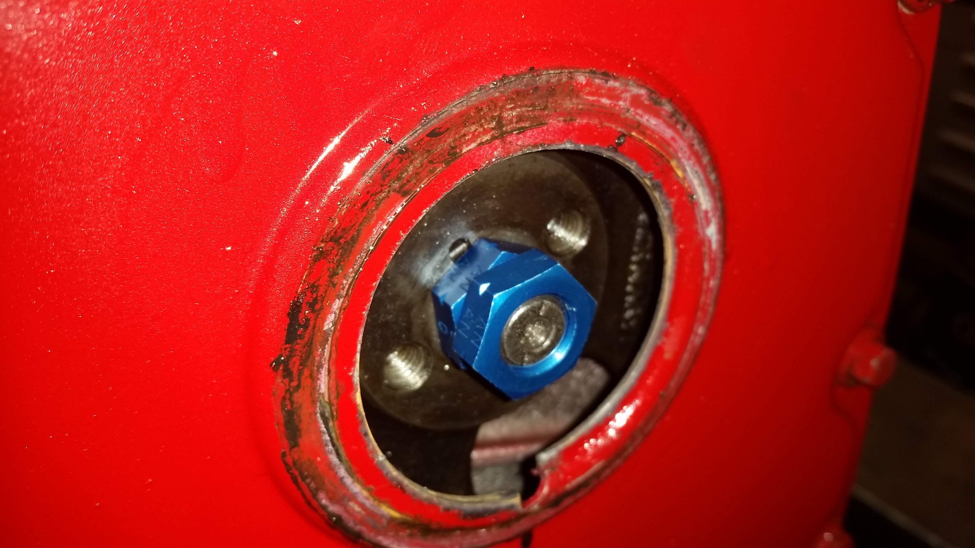

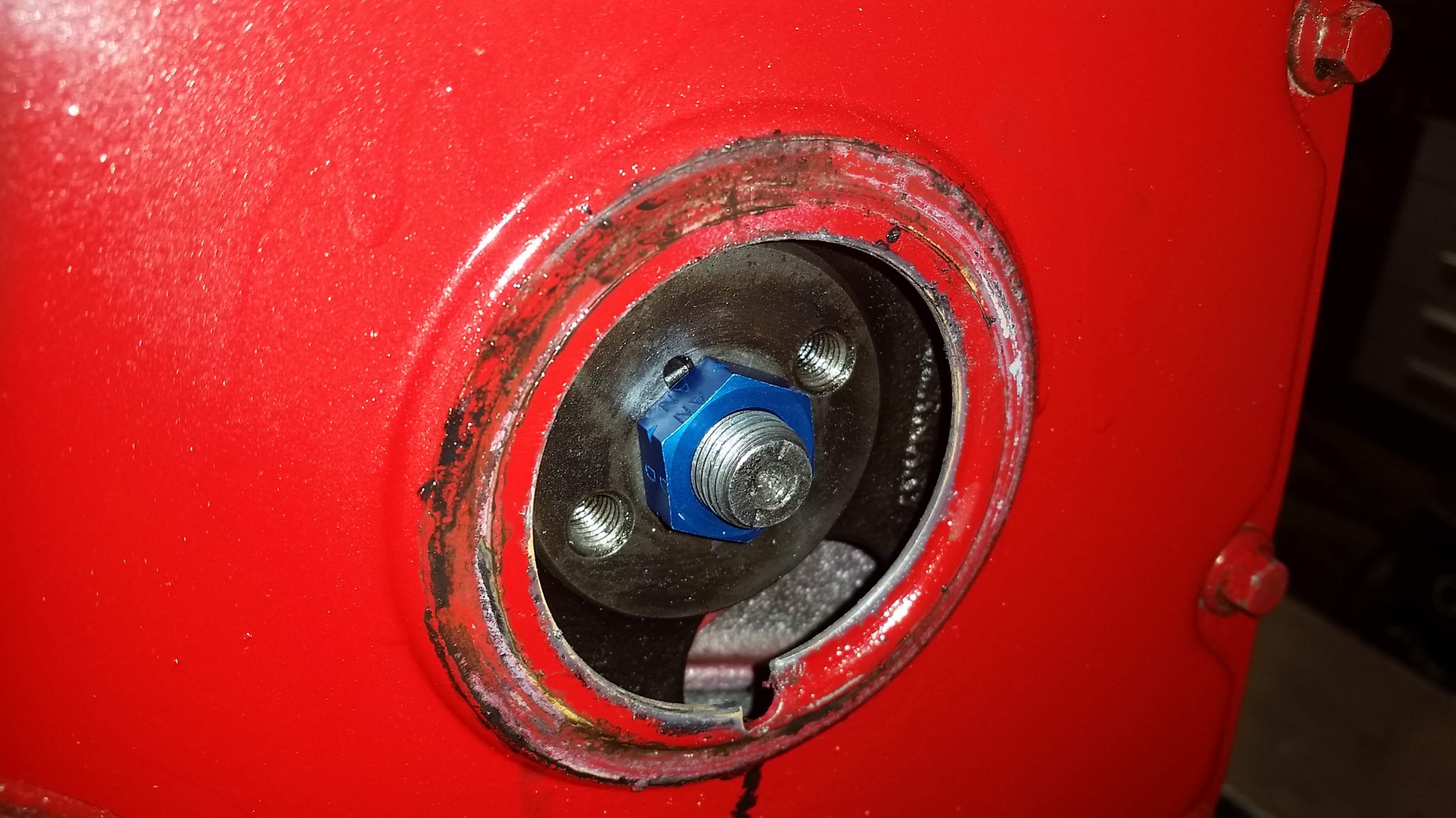

Some how I misplaced the injection pump gear nut, but found that a #6 AN lockout fits perfectly

   / 4bt cummins jeep tj #47
I would find the right one, those AN lock nuts are not made for the RPM or conditions on that pump

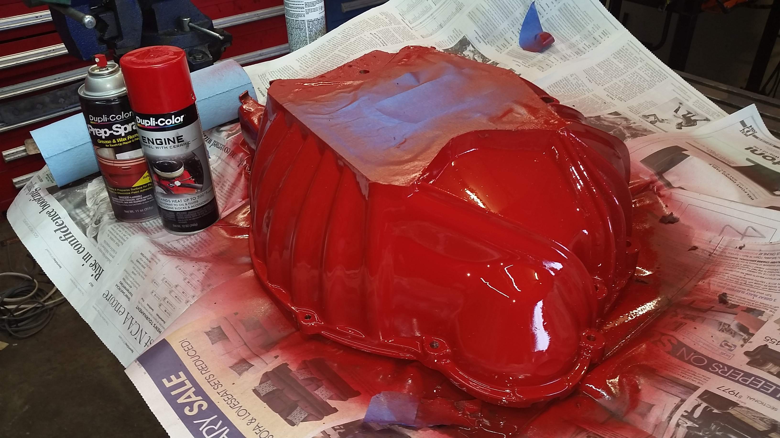

Painted the bell housing

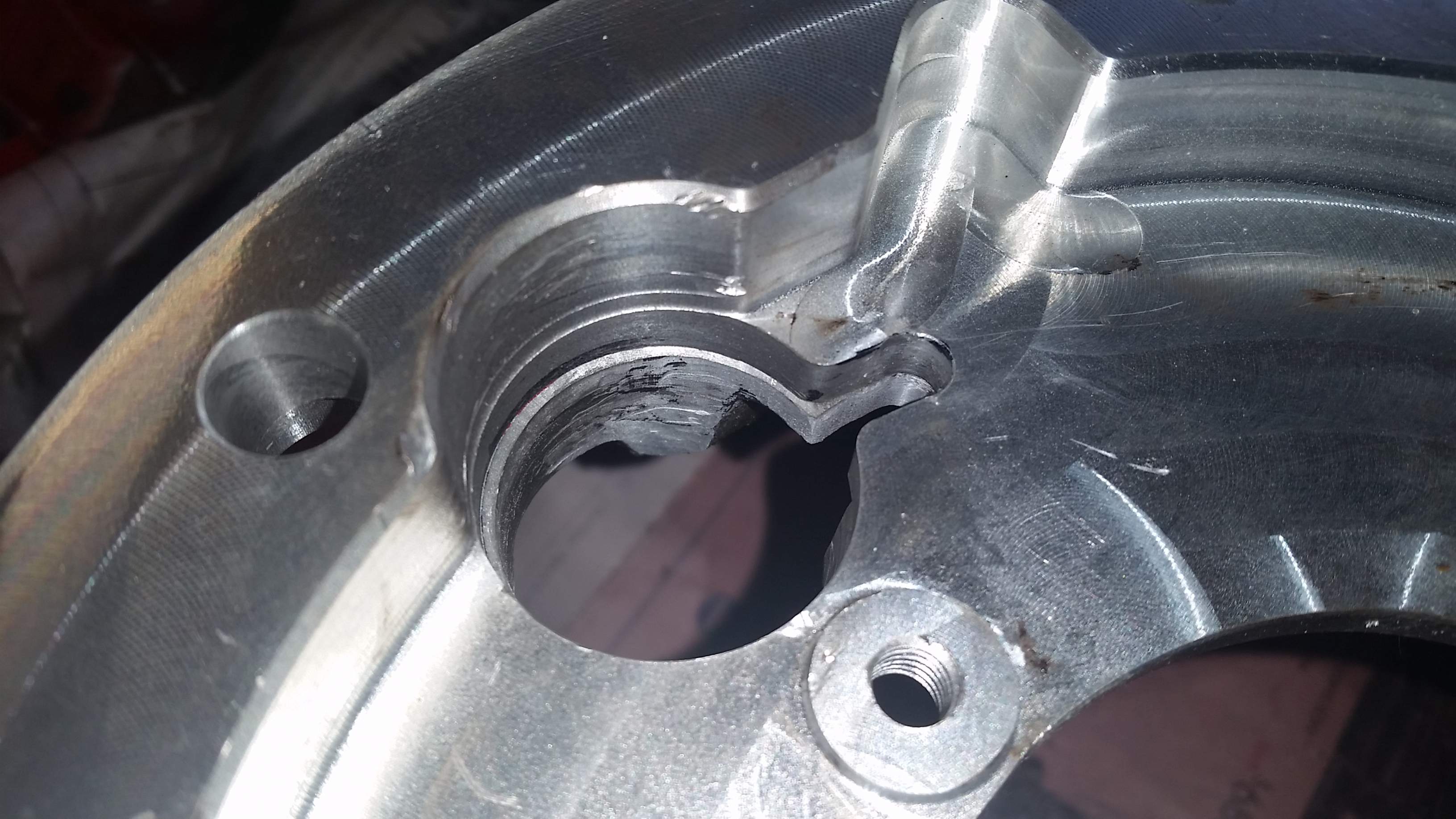

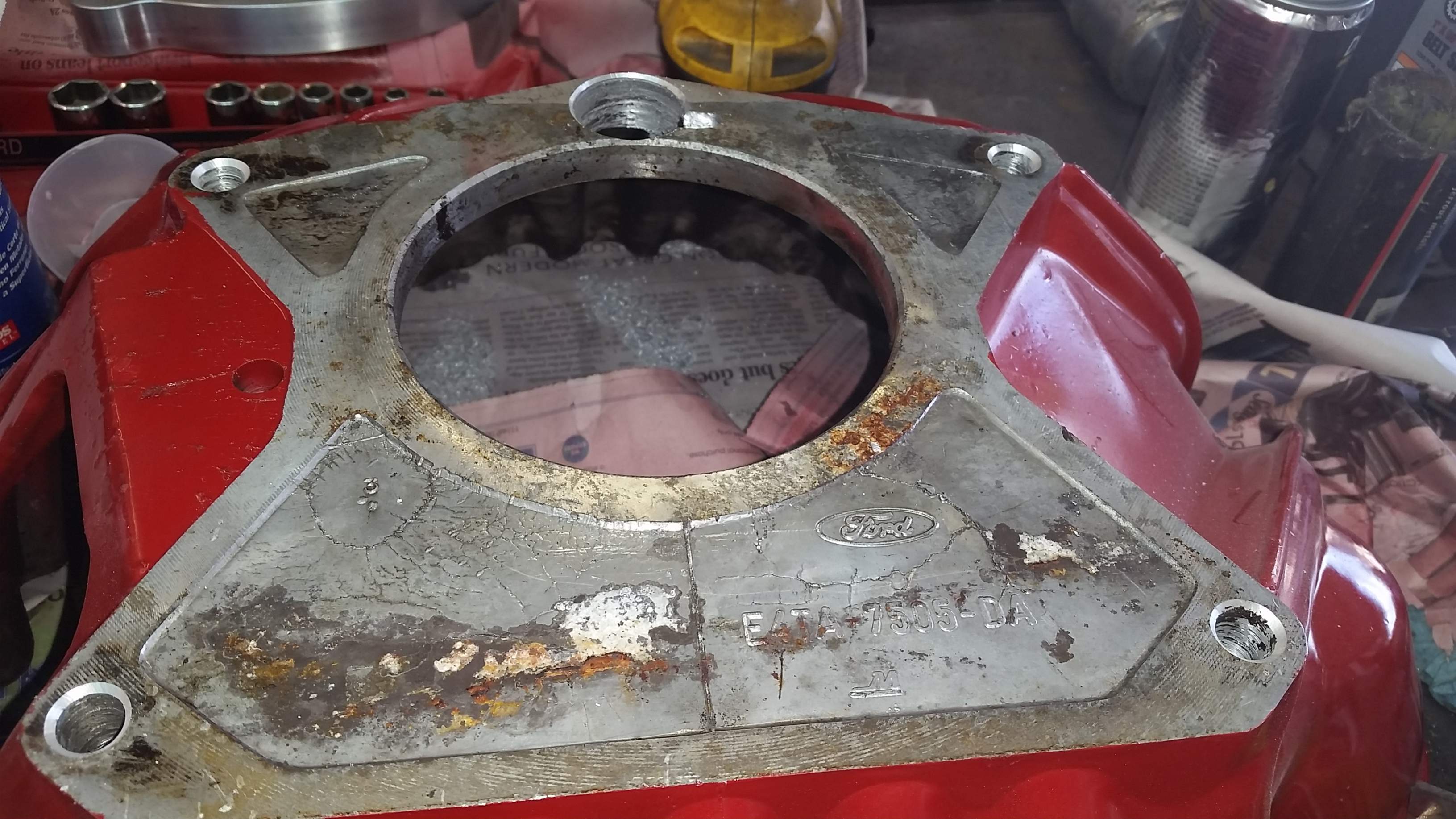

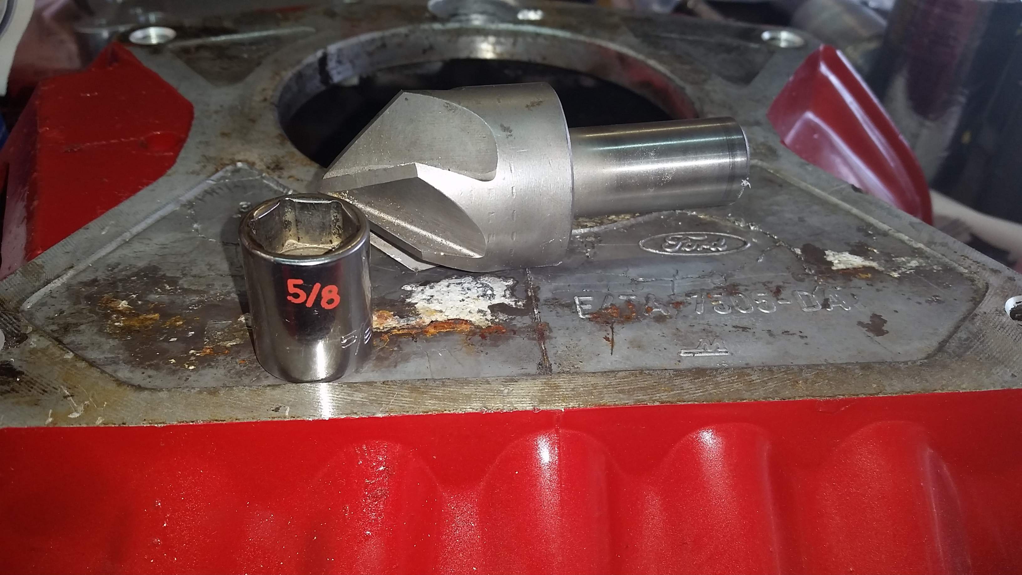

Modified the bell housing to clear the shifter boss on the trans
