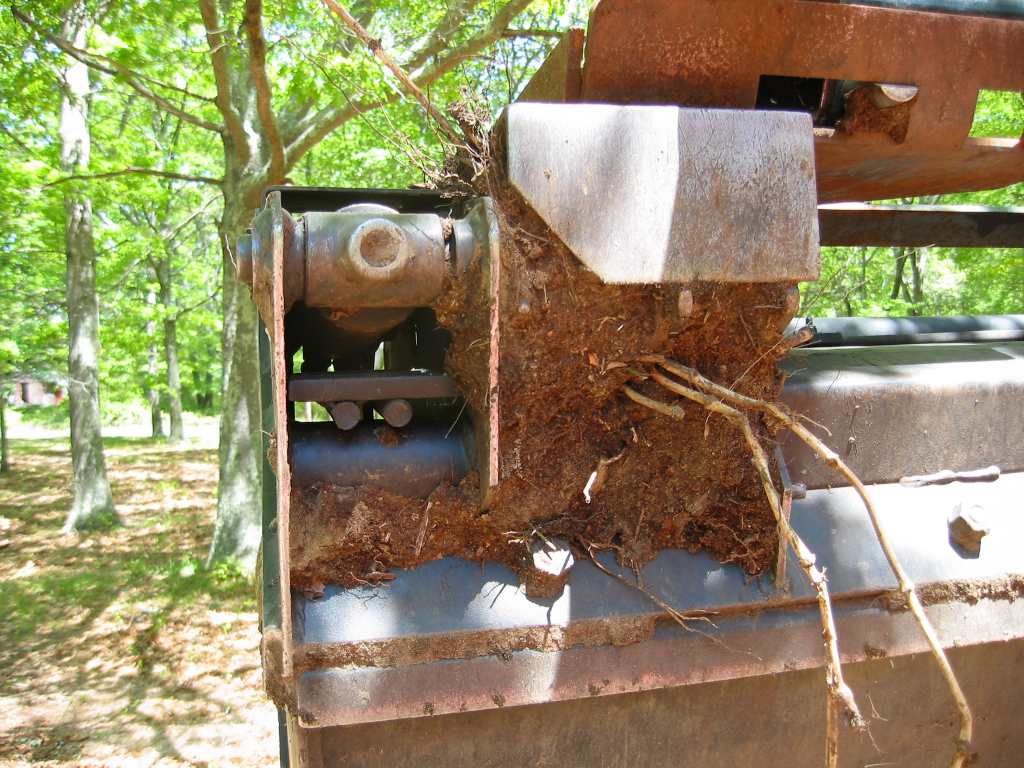

My comments above are based on using a lighter or medium duty WRLong 4n1. I'm not certain but I think it is the HJ60. I bought it used but it had not been used much. Second photo shows one zerk completely covered in dirt and another protected zerk that is jammed full of dirt after routine use. To be clear, I have not damaged the unit at all but it is clear that this is a more vulnerable piece of equipment than either my Millonzi LD48 grapple or the Kioti standard bucket. I don't believe that has anything to do with WRLong (well maybe the zerk placement:p), but rather is inherent to the universal 4n1 design.

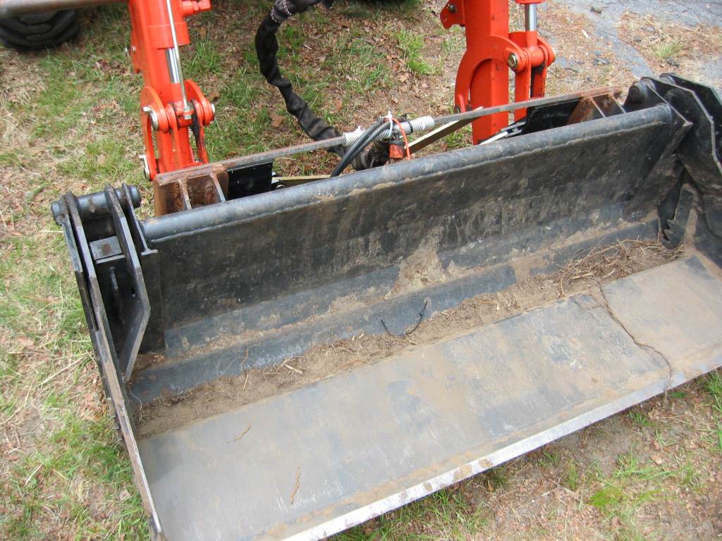

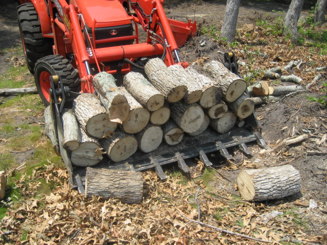

Here are some pics of details I could see. I've still got the bucket filled so can't take that one.
The stumps are there for perspective - big oak stumps, the one in the 4n1 is 8 feet tall or so.
Hmm, looking at it the reinforcements are tough to see, I'll take some more tomorrow in decent light.

More photos of the dumb placement of zerks on the 4n1. On the second photo you can see that if they had moved the zerk 90 degrees it would not be face down in the dirt every single time you use the bucket but would instead be in back with at least partial protection. There is one other zerk in there that is so buried in dirt I didn't even find it the first time I greased the bucket up.
