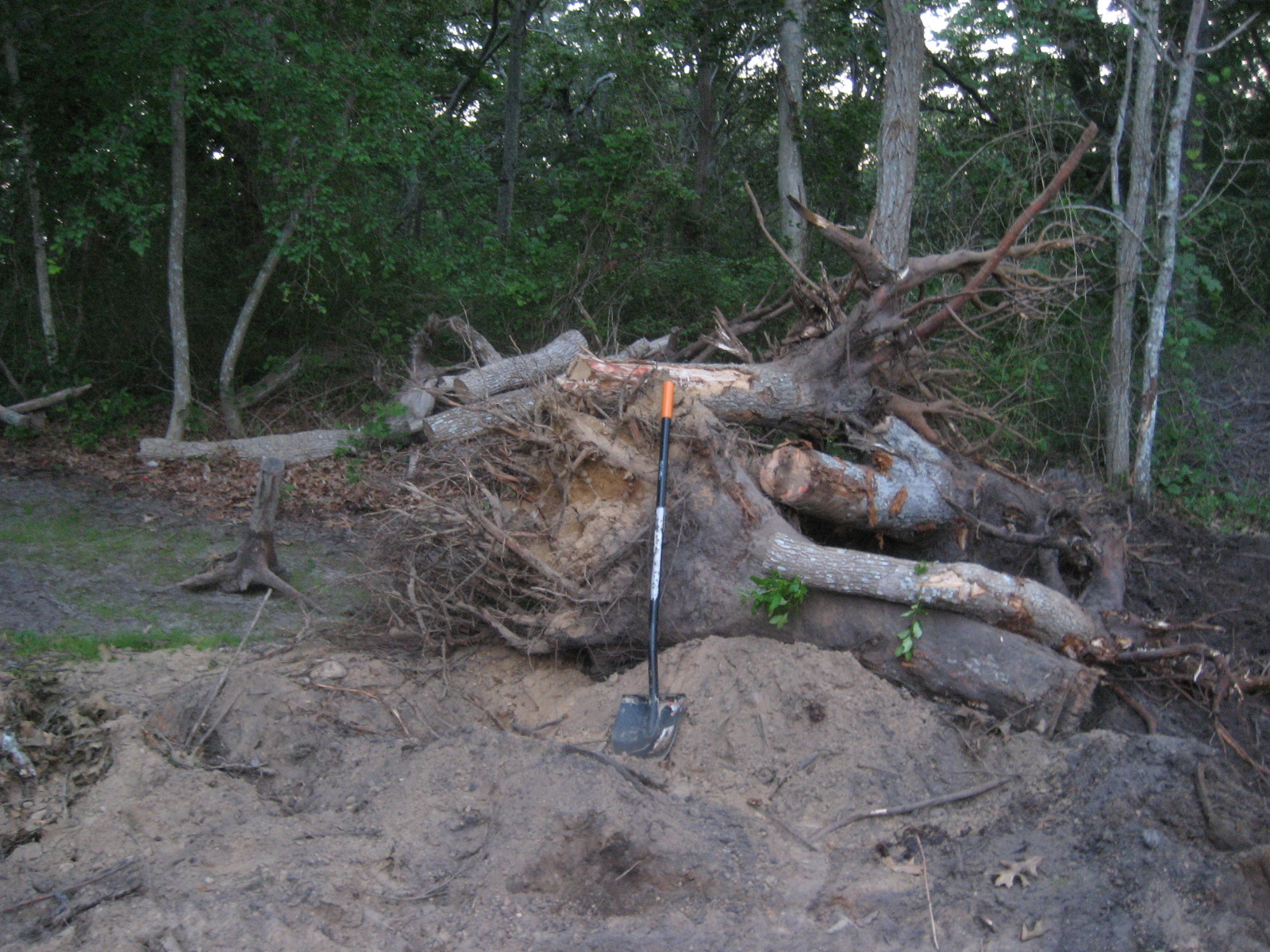

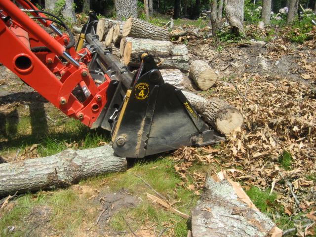

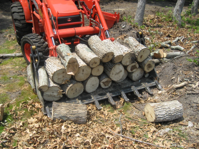

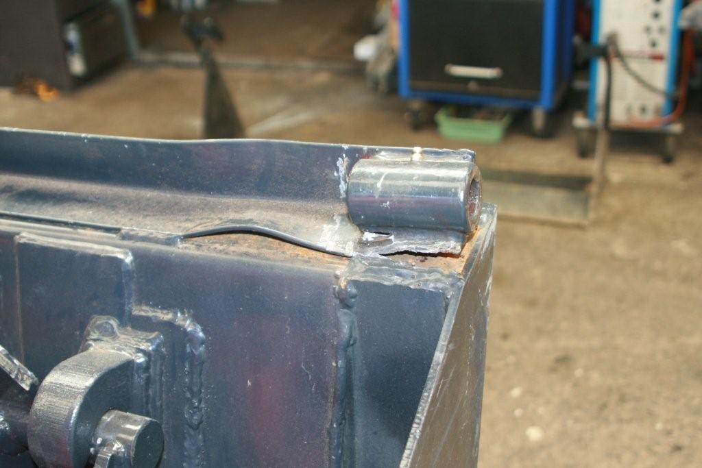

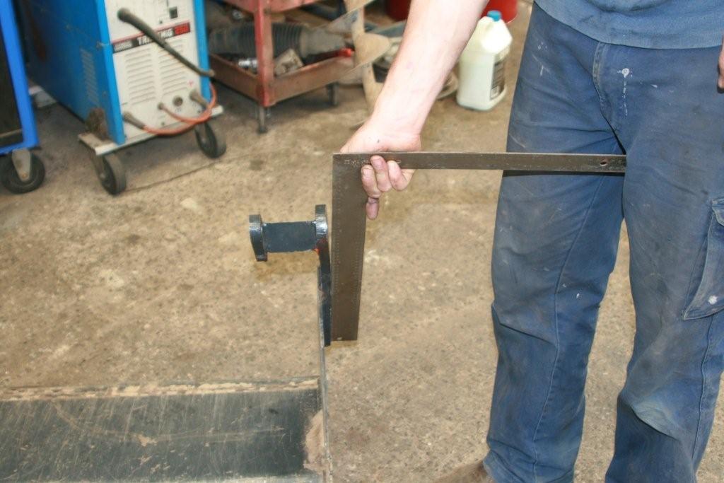

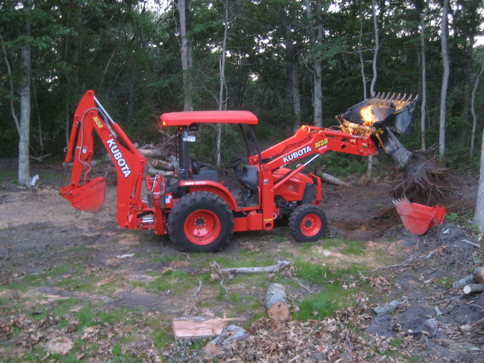

Here are some pics of details I could see. I've still got the bucket filled so can't take that one.
The stumps are there for perspective - big oak stumps, the one in the 4n1 is 8 feet tall or so.
Hmm, looking at it the reinforcements are tough to see, I'll take some more tomorrow in decent light.

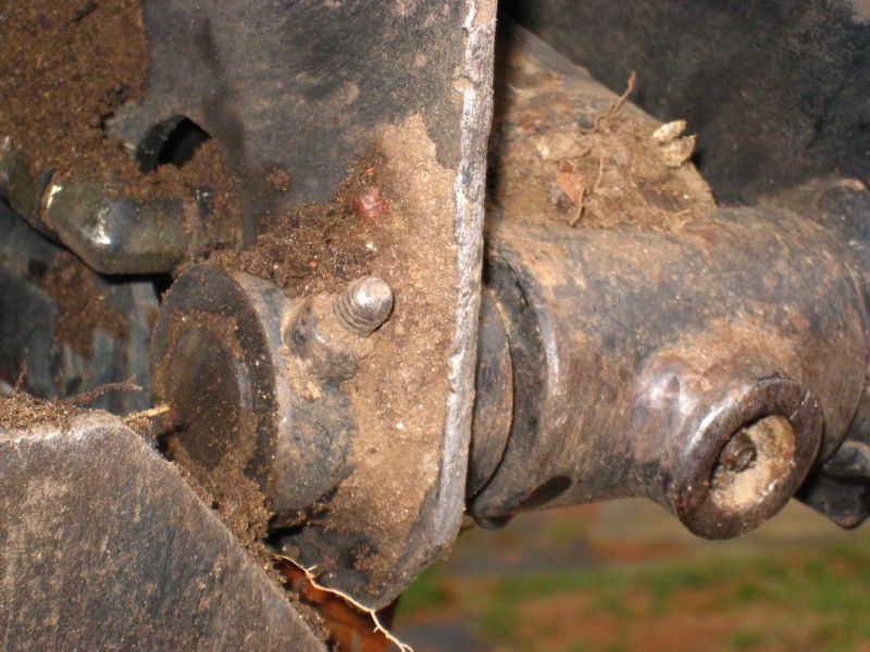

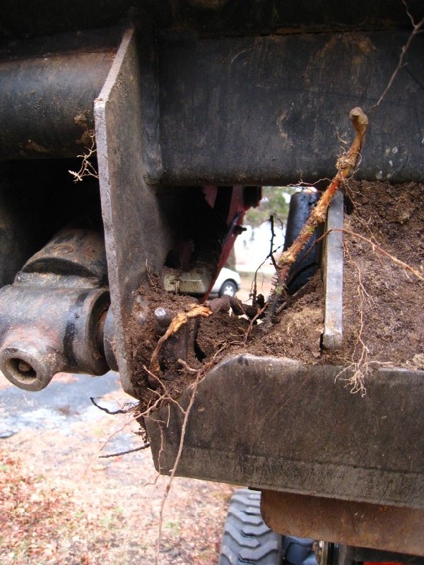

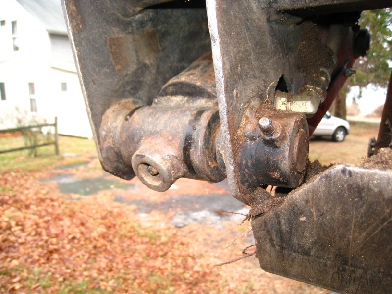

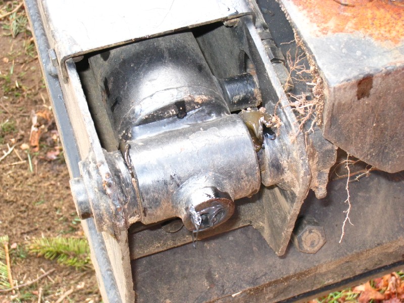

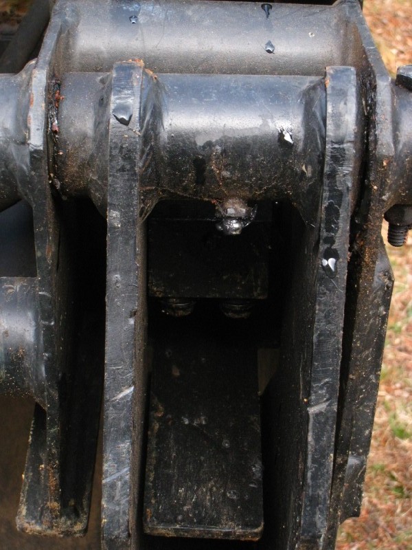

More photos of the dumb placement of zerks on the 4n1. On the second photo you can see that if they had moved the zerk 90 degrees it would not be face down in the dirt every single time you use the bucket but would instead be in back with at least partial protection. There is one other zerk in there that is so buried in dirt I didn't even find it the first time I greased the bucket up.

yep, I think thats where mine is as well.... Maybe its unavoidable?
I haven't had call to use a zerk flusher yet - is it that I'm lucky, or because I use a pneumatic grease gun, not a hand one? Sometime it does labor a bit before the zerk opens up...
