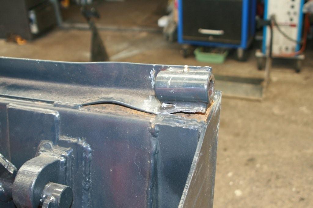

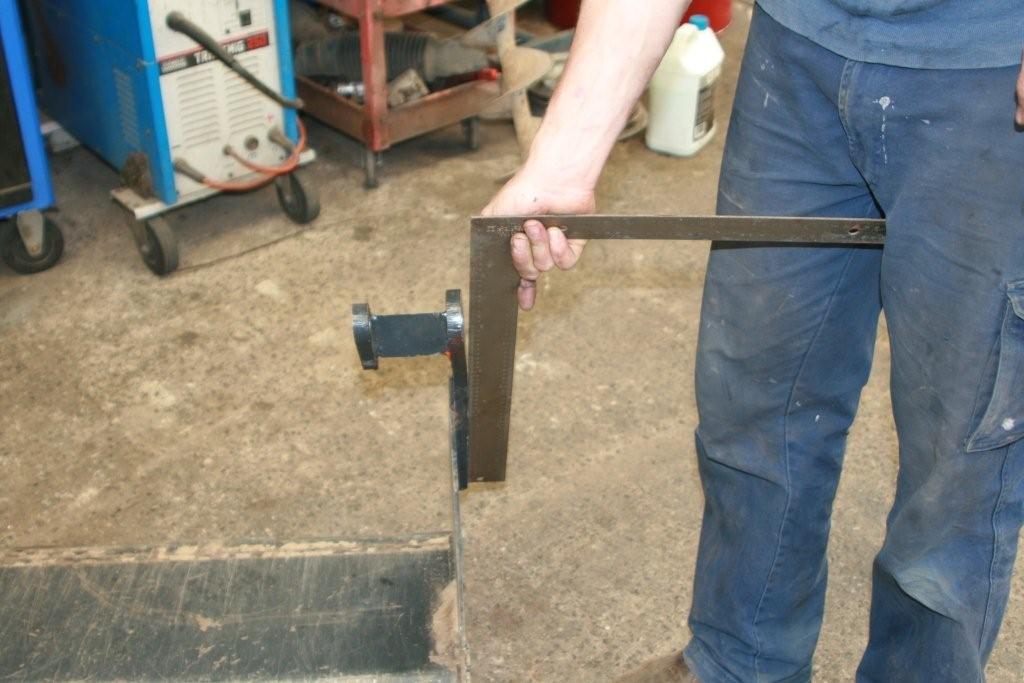

Here are some pics of my broken new Daedong ( Kioti) 4:1 bucket after 12 hours of farm fencing, I was the unfortunate owner to get Daedongs prototype bucket the first in Australia. A very pour design !. I hope they get better -- my dealer AG POWER did the right thing and credited my bucket back and arranged a high quality bucket made by Hughes in Australia. I have since done a further 100 hrs with the new bucket without any problems at all. However the new bucket is 150 kg heavier than the factory unit. With 2 1/2 4:1 rams the bucket will easily cut a 3 tree branch in half, when picking up rocks / logs etc in the middle no distortion at all.
