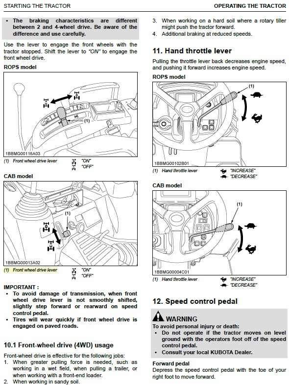

The dealer had told me that they use 4WD for all loader work. I moved a mount of soil over the weekend on un even ground which is why one of the wheels had spun, plus it was pretty wet. I'm confused as to why the manual shows what it does below for 4WD.
This page says using 4wd is "effective" when doing loader work, and while in pavement (increased tire wear). The point made about damage is by forcing the 4x4 lever into position rather than a smooth action by lining up the gears by stepping forward or backwards on the pedal.
I generally use 4x4 when loading on soil and avoid 4x4 on pavement, unless it's wet and slippery, to save my tires. When loading, I get a very full bucket in 4x4, i find I get a smaller load in the bucket and the rear wheels tend to slip when not in 4x4 and I have a backhoe but not loaded tires.
