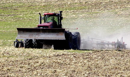

Is this one of those light front end tractors? I see these very tractors on many of the large farms out here in Northern California. Wonder if they ever use 4WD.

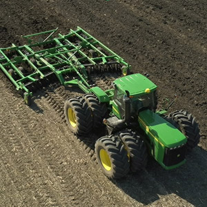

My choice would be an 8 wheel drive, if I had the land to go with it. /forums/images/graemlins/grin.gif
