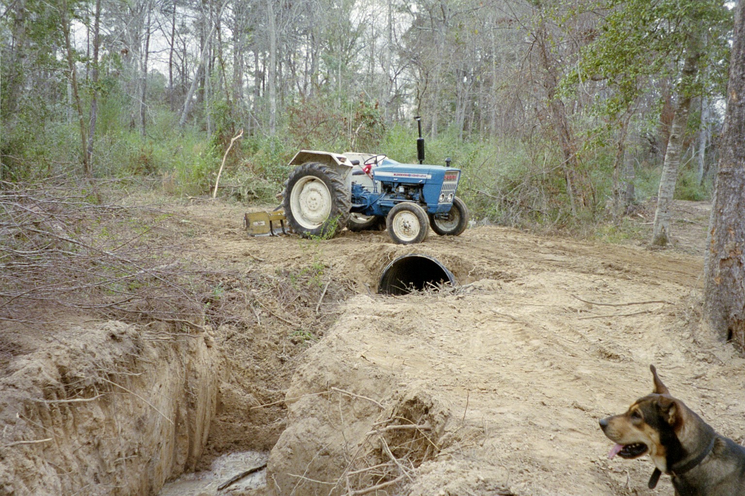

I don't know. I plan on doing mainly tillage work, with a secondary use for pulling heavy, red oaks, some 20-30 in diameter,some as thick as 48 in anywhere from 8 ft-40ft long. They are heavy. Of course I can cut them to managable sizes with a chainsaw. Do you think a 38hp Massey Ferguson 2605 2wd will handle them properly ? I have also considered the Case IH Farmal 70 2wd, and the NH T4020 2wd, which is almost the same tractor, except the body work, and rearends. I know they are heavier, but the cheapest new one I see myself getting is probably around $19,000.00, while the 2605 is around $12,000.00 That does include, rotary cutter, plow, tiller, cultivater, grain harvester, manure spreader, etc.. I will be also purchasing
I cleared my 5 acres after the loggers left a mess. I started with this 54hp Ford 3055 with 2WD. I bought it used for $3500 with a wore out JD rotary cutter. It's rear wheels were about 5 feet or so high. The tractor was almost too lite to tackle the big trees remains. You catch a large log wrong with just a box blade and that log will spin you around. You need weight to handle large logs and small tractors just don't have it. I was glad I bought the 3055, as I was looking for 20-30 hp tractors to clear and clean up the mess with. I can honestly state using anything smaller than the tractor pictured can get you and your tractor hurt in a hurry working large logs.
hugs, Brandi
