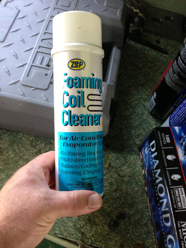

Its a very mild cleaner, and it is for the evap. I believe it is a spray nine product. Will look today. But your are right, there are some really nasty cleaners out there.
I worked on reefer units for a long time and had to use some of the harsh cleaners on the condensers. Nu brite I think is what it was. You can't leave it on very long at all. But man does it foam and push that road grime out. Made for much more tolerable head pressures.
   / 4x20 cabin air filter #22
I was wrong. It's a zep product.

I buy mine from Johnstone Supply, some aerosol cans and some gallon jugs. No more than I need it the spray cans are good enough. I would much prefer not having to take the top off to clean the coil but it looks pretty tight in there.

here ya go some good stuff especially in this Texas heat/humidity of today

I will order some.
Thanks,
D.
So... can you just spray that on the coil through the hole where the filter goes, without removing the cab roof? Does it not tear anything up in blower? Cause foul smell or vapors in cab?
   / 4x20 cabin air filter #28
It won't hurt the blower to spray the coil from the outside but it may not do a good enough job of cleaning either. I will look at it this morning to pass judgement.

To my thinking trying to clean evaporator through access hole that cab filter fits in is very similar to showering ones body with you "undies" still on.:thumbdown:
   / 4x20 cabin air filter #30
Waste of cleaner. But why even consider it, when the cabin filter comes right out by removing two simple thumbscrews? Remember, the owner manual is your friend.
By the way, how many of you have ever removed and washed the foam dust filters on the cab side of the evaporator.?
