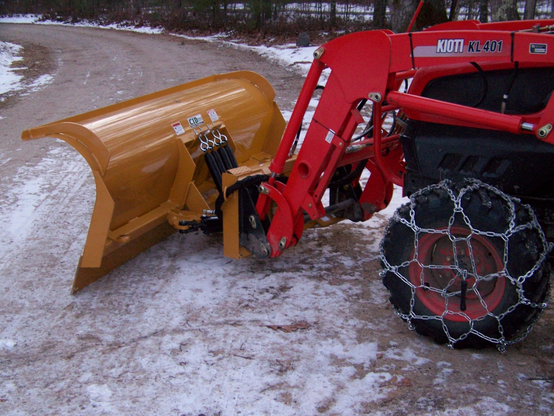

Most farmers, contractors, and public work departments I know only put chains on the front. They put chains on the front to primarily to prevent side slipping when using a front or rear plow blade. When the blade is angled and moving large amount of snow the tendency is for the front end to swing on the oppose direction from were the snow is being pushed. This happens because the front is normally lighter then the rear on most tractors, loaders, and skidsteers. Plow truck have a different weight configuration so a truck may only have chains on the rear if any.
The first time I tried pushing back a road side snow bank with a rear scraper blade angled and off set to do the job I tried using no chains. I had no problem with forward or braking traction, but force on the blade would force the front wheel into the snow bank every 30 or 40 feet. After mounting the chains to the front wheels I had no problem and I was not using 4 wheel drive.

You need to learn how to use your steering brakes.
When I used a rear blade (angled), I had the same problem of sliding to the side of most resistance. A short tap on the brake opposite to the direction of slide brought the front end back to straight.
Of course, if you're happy with those chains on front...continue what you're doing. As long as you use some common sense, you shouldn't have any problems.

Using the steering brakes pedals and HST pedals at the same requires more concentration then I can muster in my middle-age. Plus it will distract me from listening to the Stones and Rush on the stereo. There are priorities you know! :)

I believe most compact tractor use a standard differential design on front and rear axles with the exception that the rear can be locked. What is called a locking differential. With a standard differential power goes to both right and left wheels as long as neither wheel slips. When the wheel slips it causes all the power to go to it and the other wheel provides no traction. The locking differential and limited slip differential over comes this issue by allow power to go to the wheel that not slipping. The locking differential is normally manually engaged and should always be disengaged after you're out of the slippery situation or you risk damage to the drivetrain. The locking differential forces equal power to be applied to both the right and left wheels. A limited slip differential is normally always on, if a wheel slips it will allow "some" power to be applied to the other wheel.
So along as neither front wheel slips, which is less likely with chains on, both wheels get power if 4x4 drive is engaged.
Note: while there are chains on the front wheels of my tractor I rarely use 4x4, only when I need it. The chains are there to prevent side slipping on the front as I noted above.
