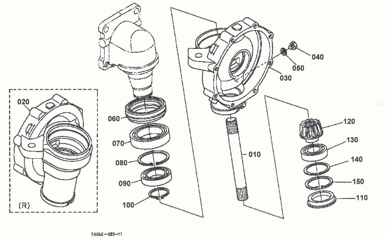

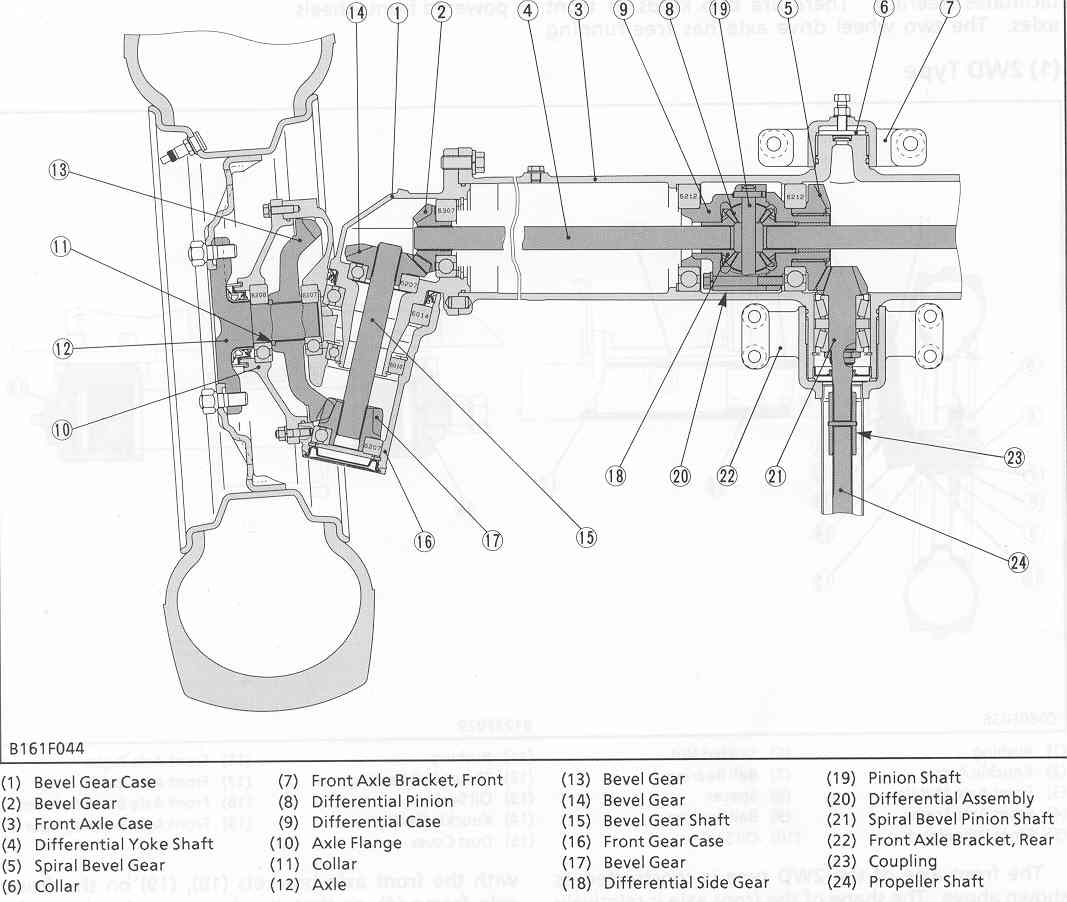

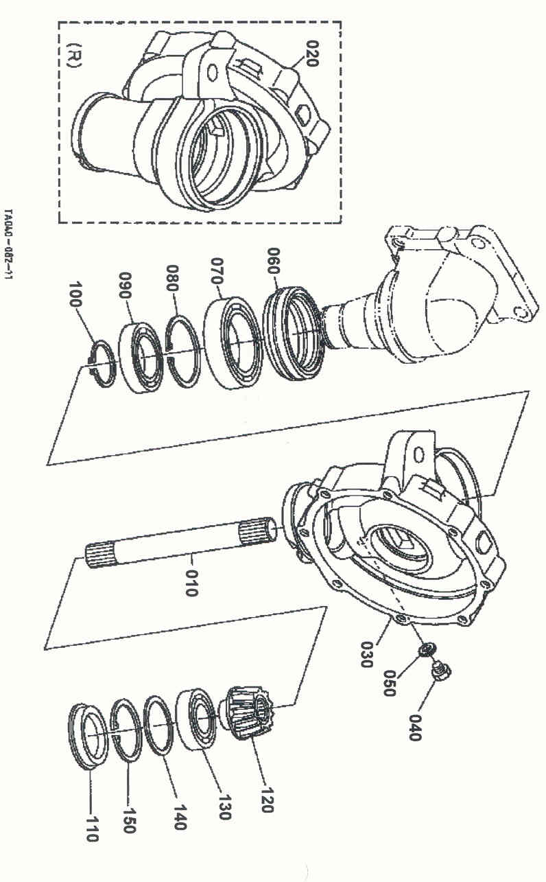

Hello Jay.. mine does the same... I'm tempted to run the 85w140 gear oil in the front, that should stop or slow the seep... here are the front seals... KennyV
I switched to 80W90 gear oil and it did seem to help for a while. Maybe I'll try 85W140 next and see how that does. Given the spots forming under the tractor, I doubt it'll cure the problem. Maybe some of that weird #00 grease would solve the problem permenantly. I put a cup under the hub when I left my place on Sunday to catch the drips, so I'll see how much actually leaks out in a week. If it is a lot, I might just take the cup and dump it right back in!
Thanks for the pics. I may hit you up for a shop manual procedure in the future :).
