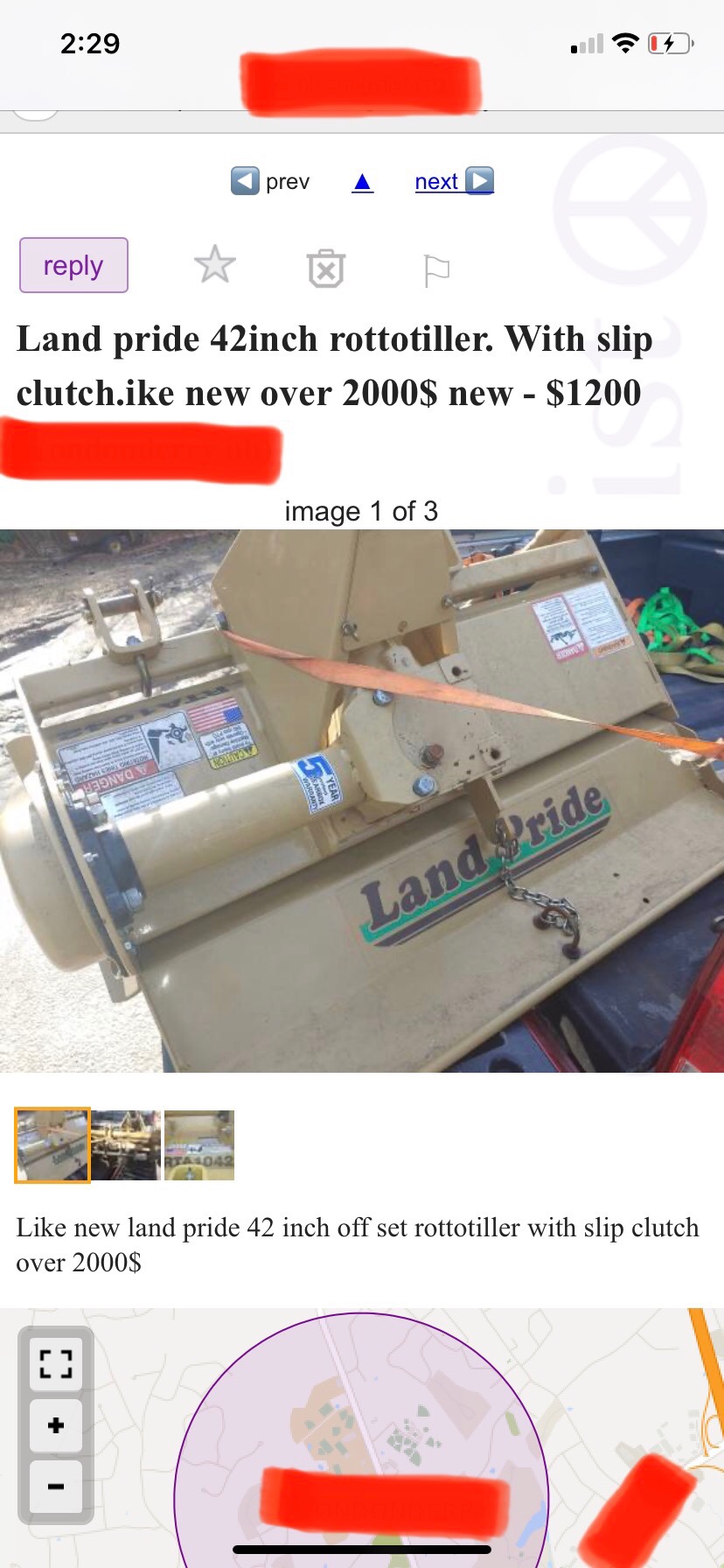

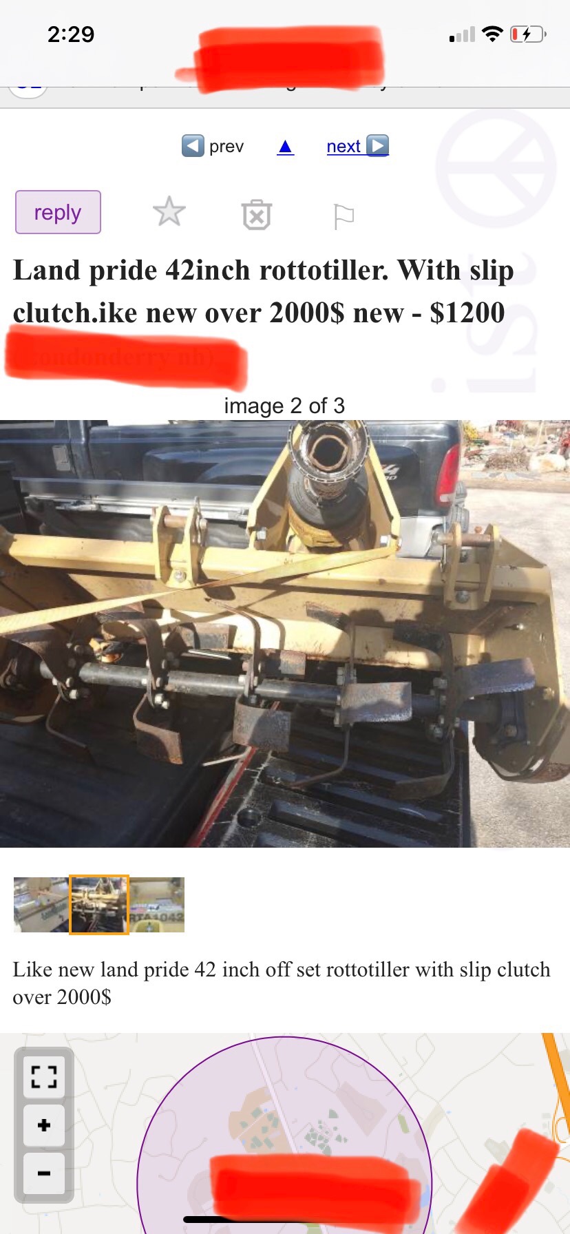

Thanks for the info guys! I have seen a bunch of 4’ tillers out of state for around $1,000 which is around my budget but find nothing here. I found a 42” offset Land Pride tiller that some guy is selling. He is asking $1,200 for it. I have seen plenty of 42” tillers going for the $700-900 range, and I know brand matters. Is $1,200 a good deal for that tiller? It looks in decent condition but I would want it for $900. I don’t need anything too of the line.. just need to turn some dirt/clay. A 42” offset might be more manageable for my tractor, right? See attached for pictures!
