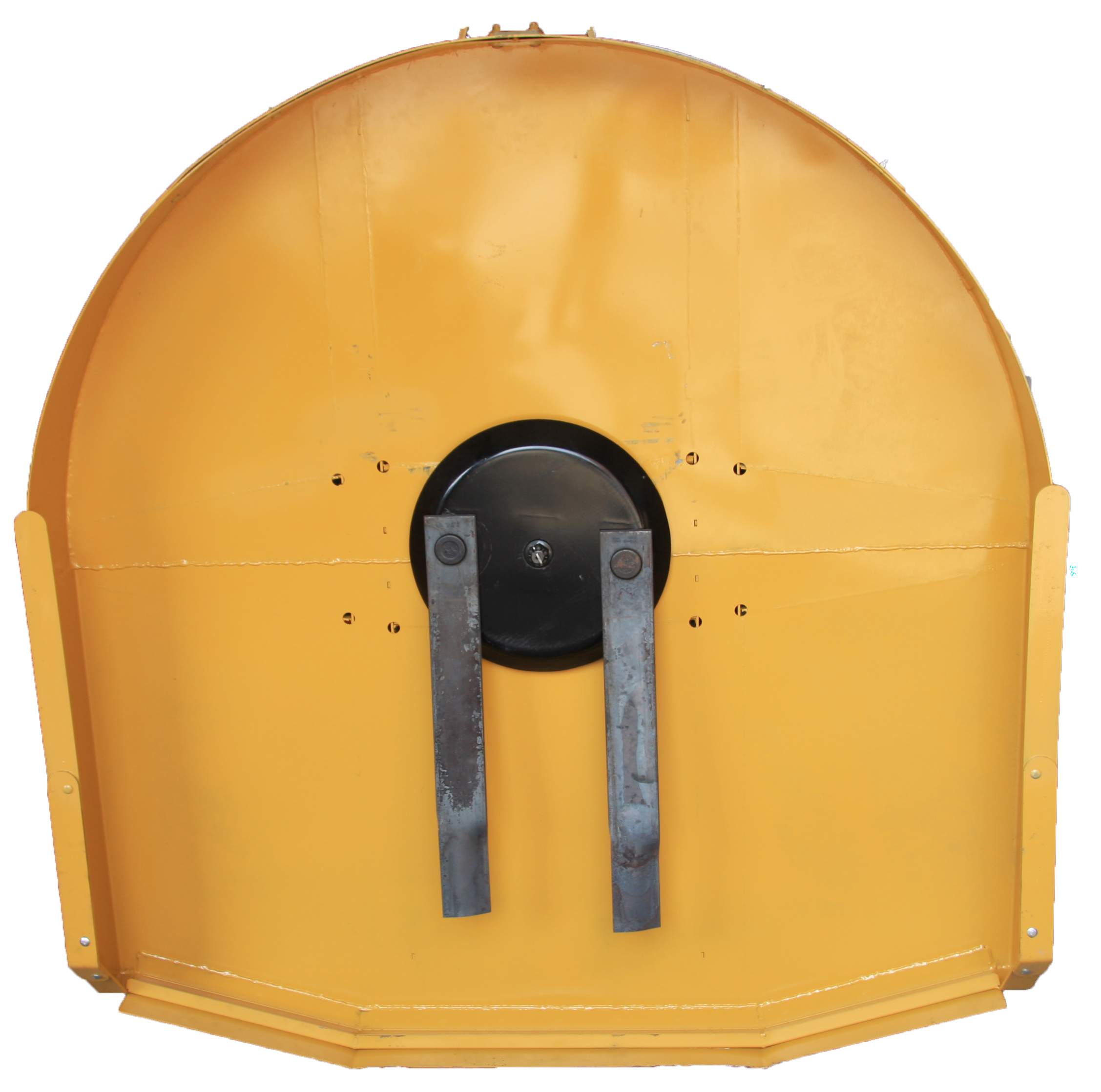

Here is the EA underside of rotary cutter. That stump jumper doesn't look very tough....
   / 5 ft rotary cutter choices #14
NO way of seeing how thick it is either. If its 1/4" thick I dont think you would ever bend it and I think it would slide over a stump nice.

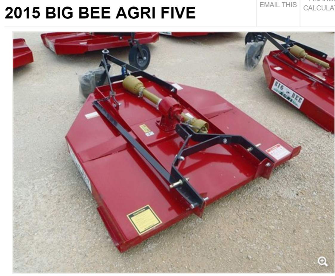

I bought one of these Big Bee cutters 5 years ago.
I don't make any effort to take care of it. I abuse it. I cut stuff that's way too big. I store it outside. I hit stumps and rocks all the time. It just keeps working. I managed to bend the tailwheel fork after hooking it on a stump one too many times and had to replace it but otherwise it just keeps going. A 5 ft goes for $825.
http://www.tractorhouse.com/listingsdetail/detail.aspx?OHID=6330147
