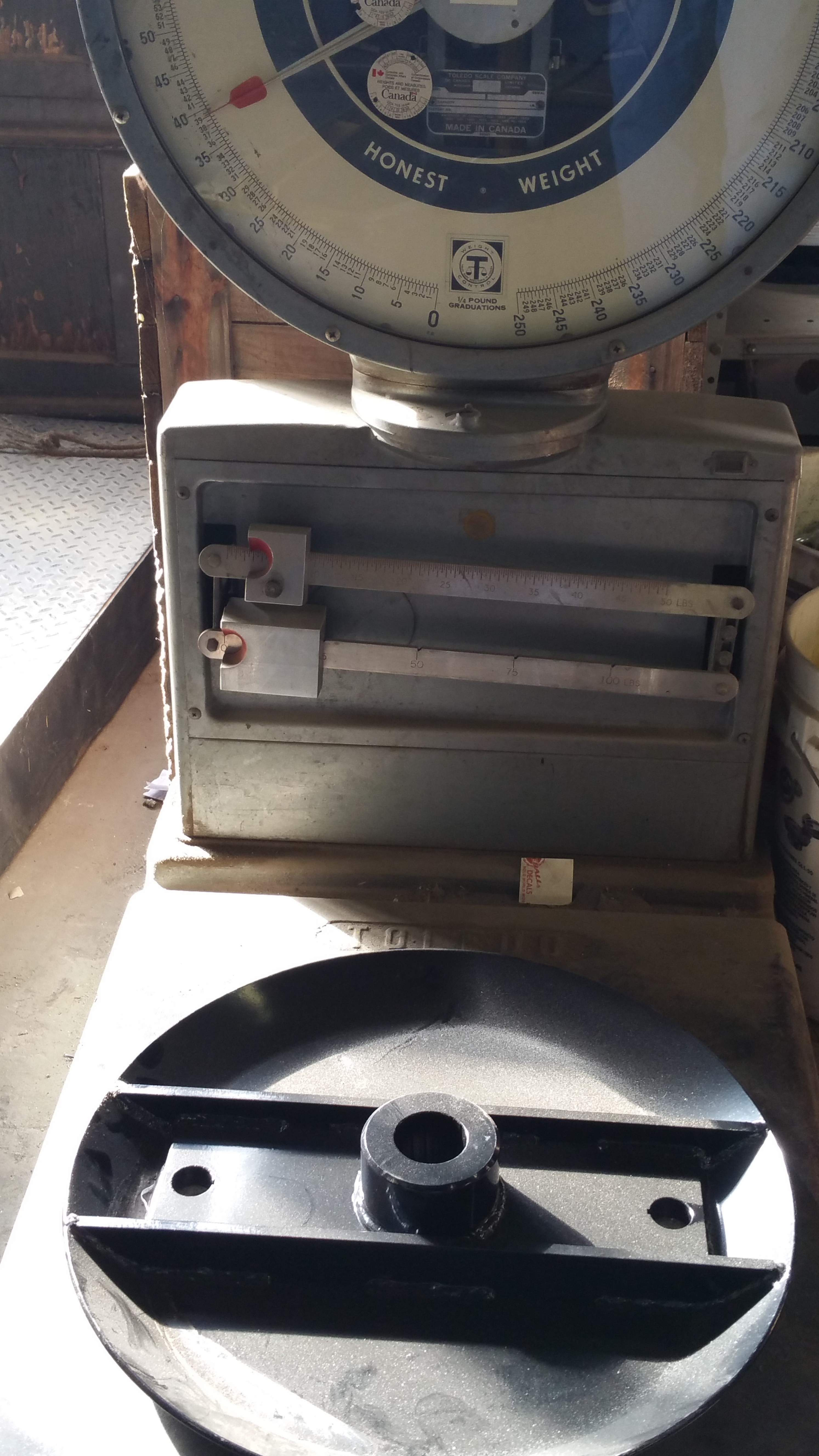

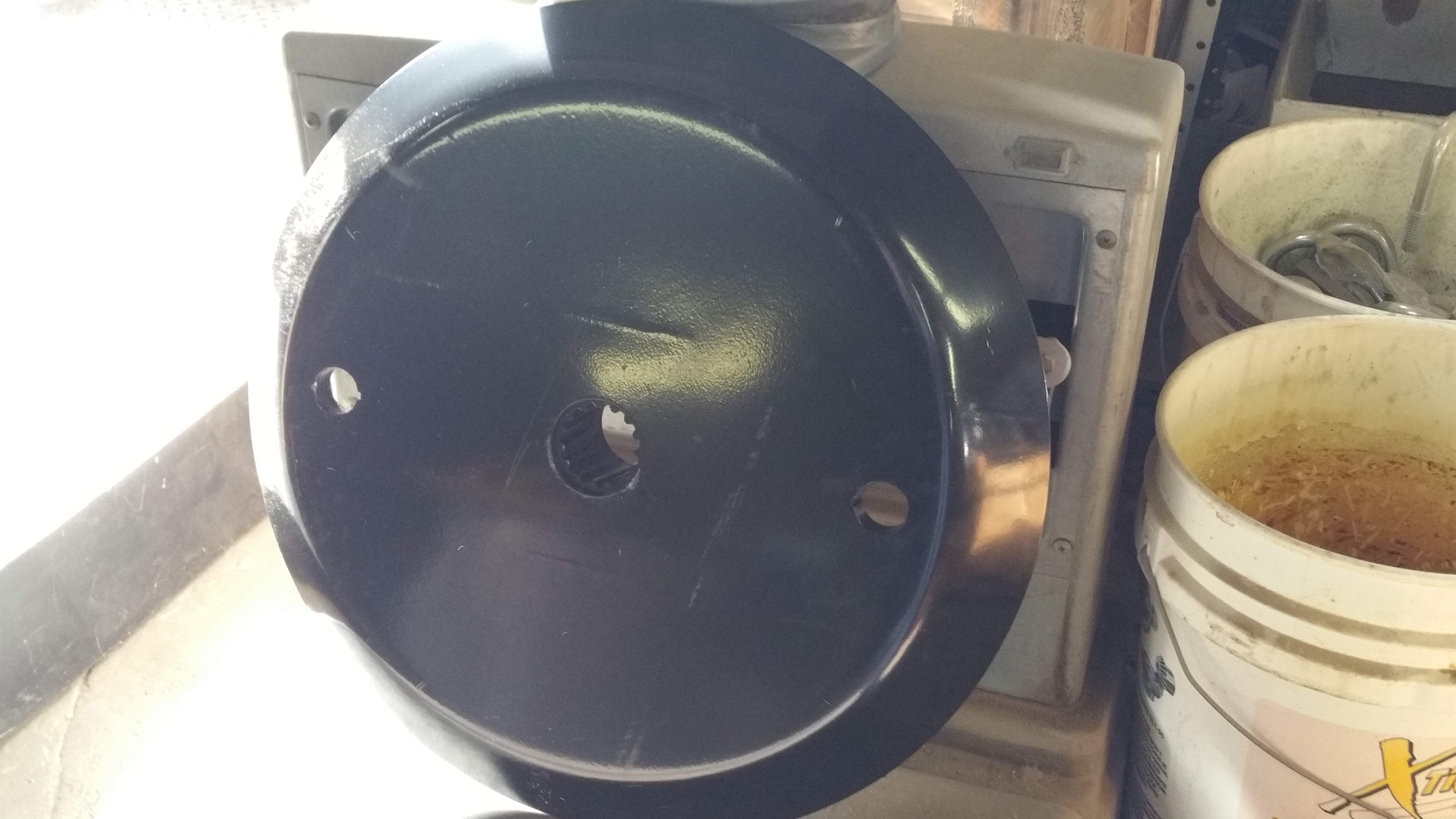

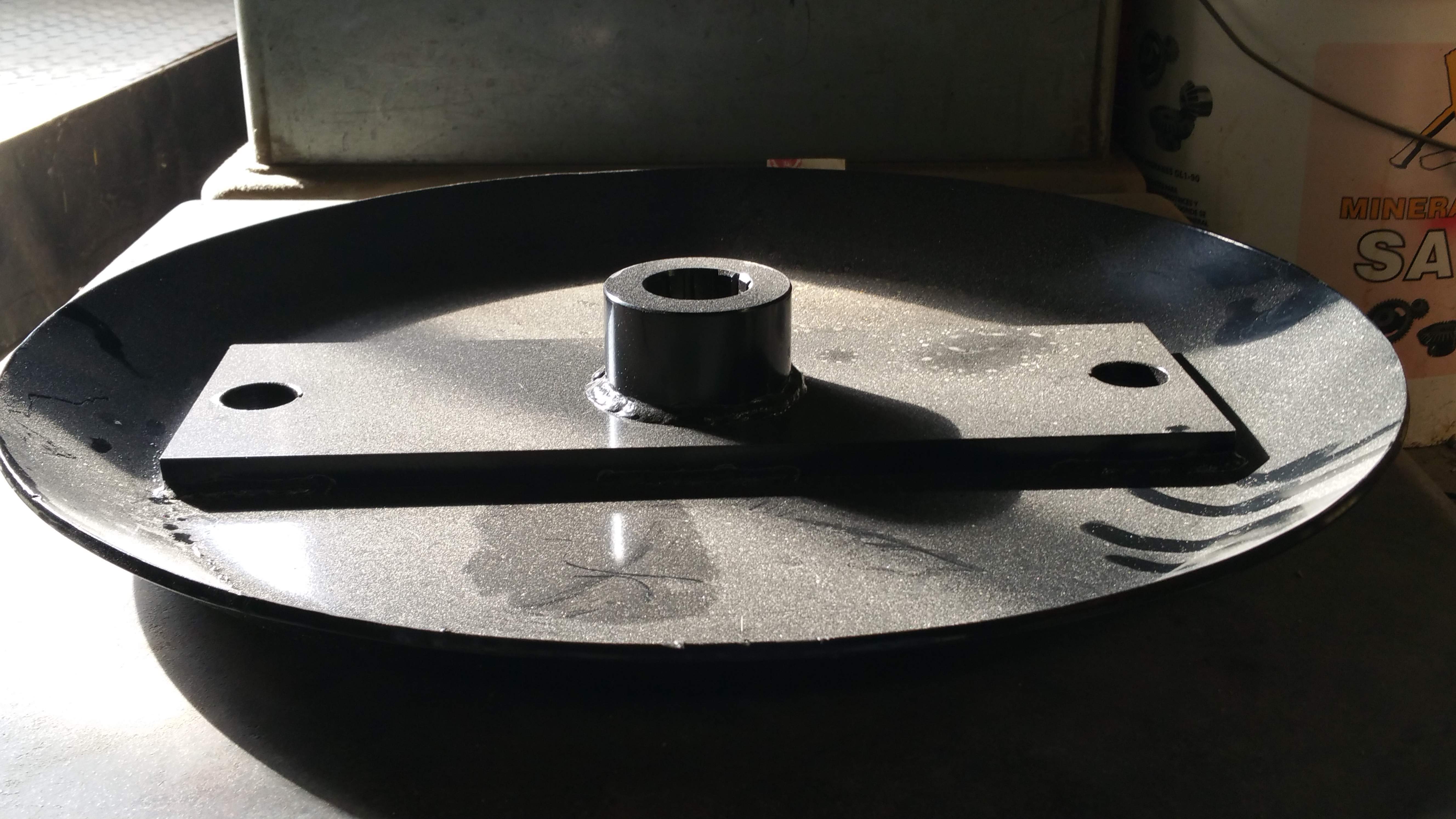

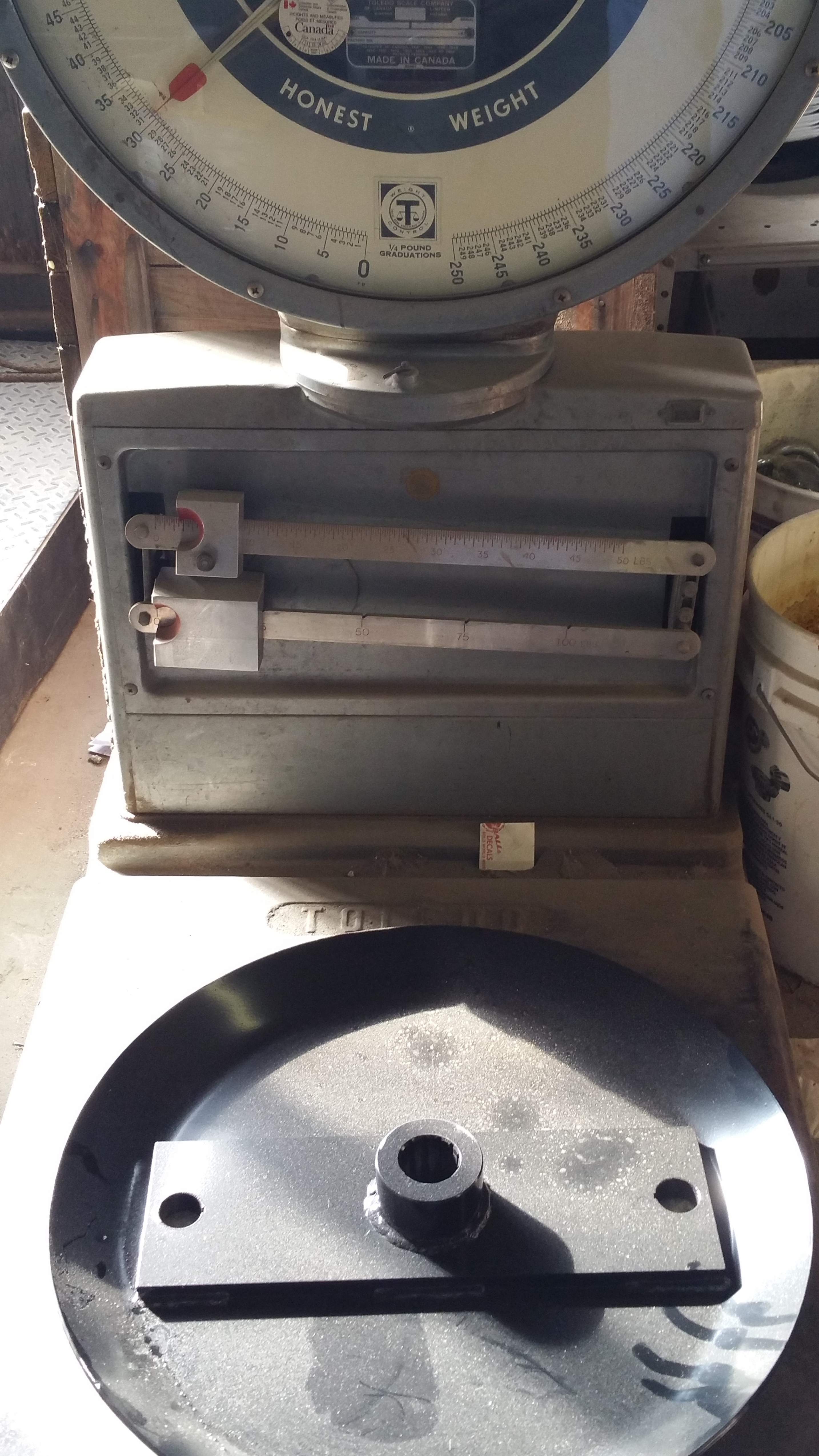

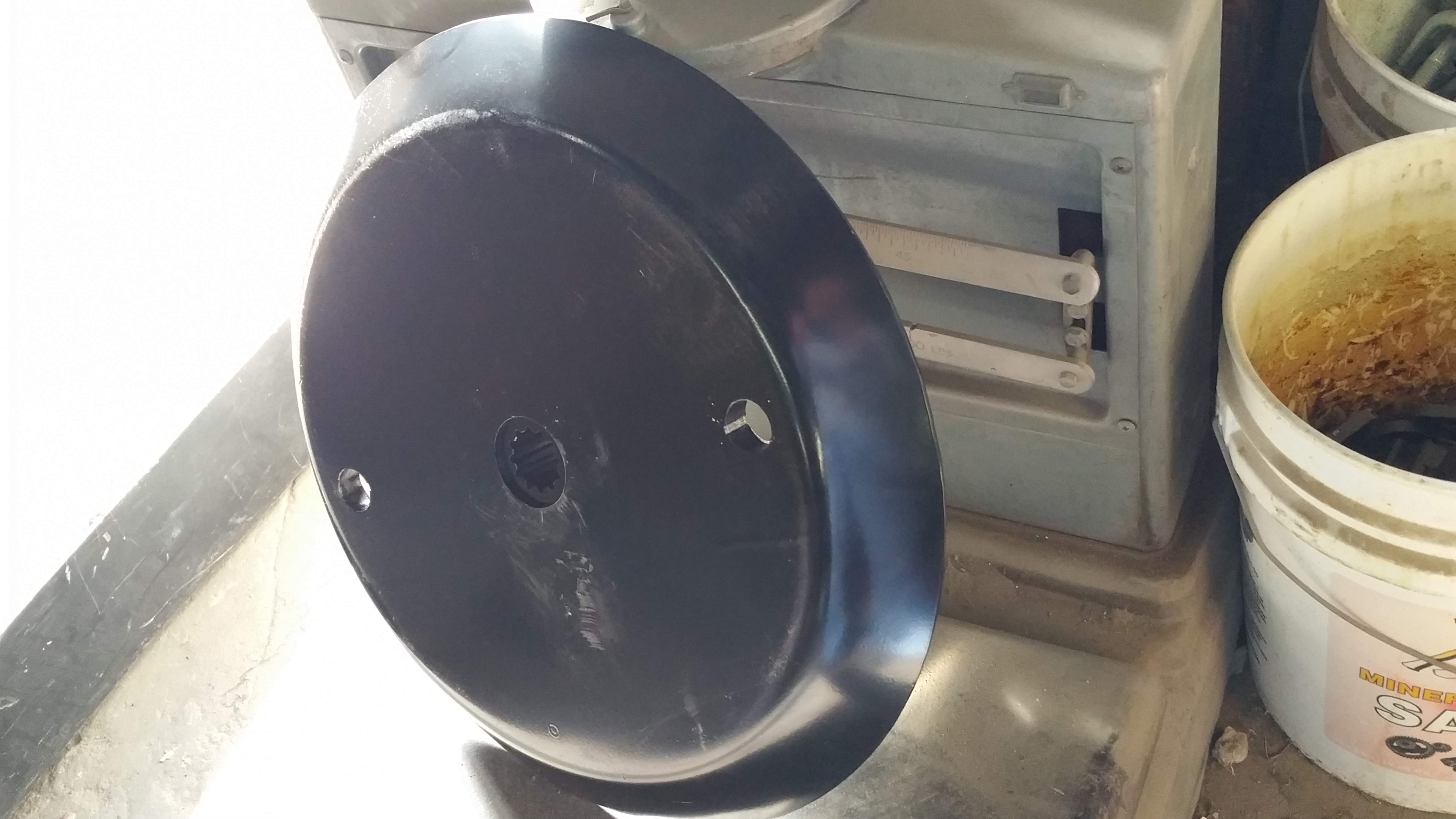

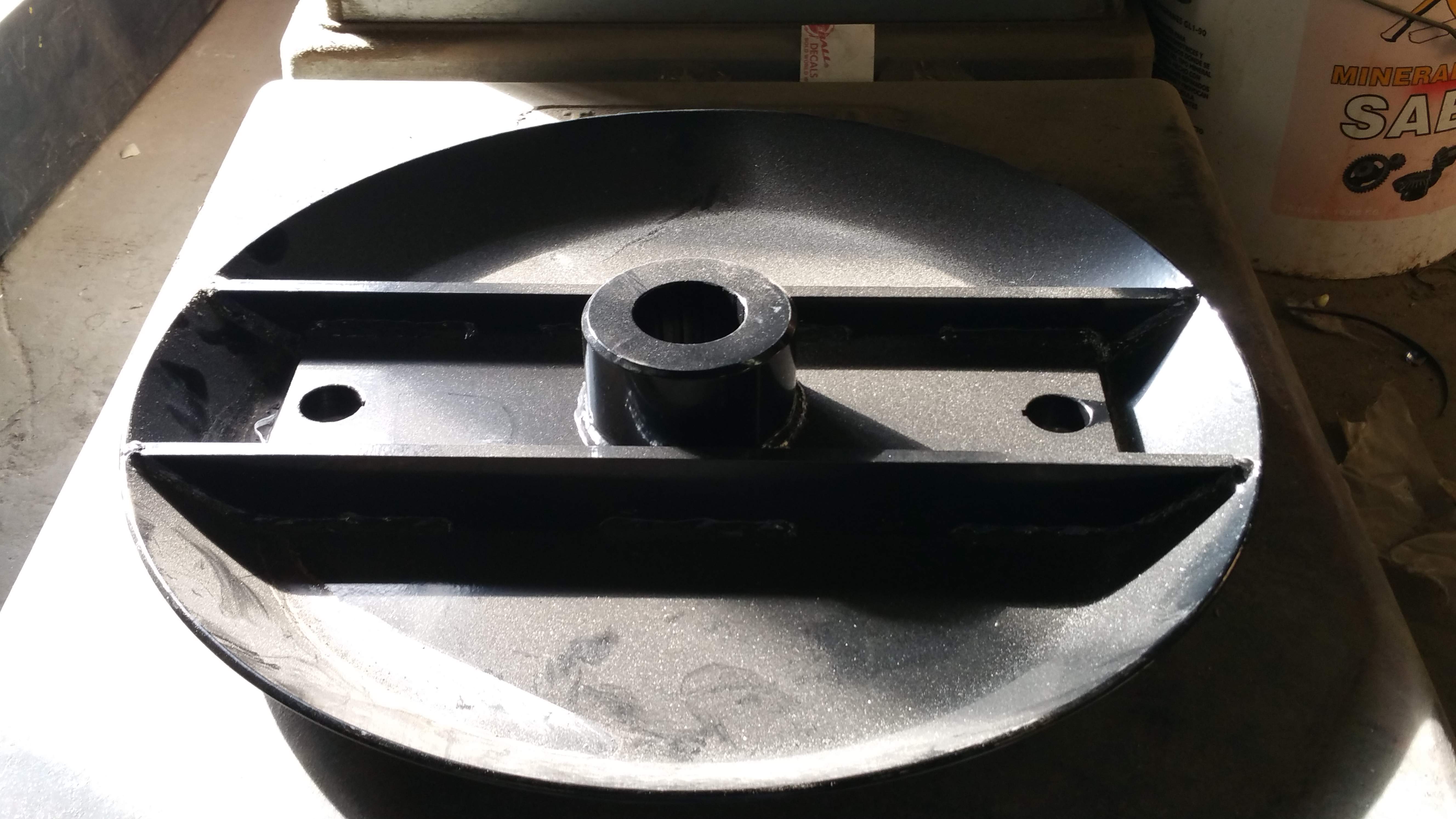

Here is the EA underside of rotary cutter. That stump jumper doesn't look very tough....
I agree, the photo shows no depth or definition. It does show that the deck is welded underneath. If you look under a Land Pride, they do not weld the joints under the deck.
Here are photos of the stump jumpers that we use.
They are 20" diameter and 1/4" according to my tape measure.
Travis
Stump jumper for 45HP gearbox. 31 pounds
Stump jumper for 75HP gearbox. 39 pounds

Thanks so much for the stump jumper photos. Clarifys alot !

Looks pretty tough to me. I bet it will more than do the job. I think a rotary cutter is one of those things that you can buy by weight. A 600lb cutter is better than a 500lb cutter and so on. Less vibration and more durable. They are not all that complicated. You do need a bigger tractor with a heavier cutter.
