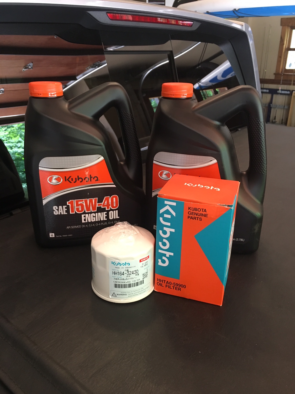

Double check on 50 hour service. Does anyone change the hydraulic oil or just that filter as shown? Thanks. IMG_7489.jpg
The other filter is engine....and engine oil.
/ 50 hour service #3
Some owners do a full hydraulic fluid and filter change at 50h. The manual specifies changing the HST (transmission) filter at 50h and every 200h thereafter. Hydraulic filter and hydraulic oil are both changed at 400h.

What does your owners manual say? Yep, Change engine oil and engine oil filter at 50 and one or 2 Hyd filters at 50 and no mention of changing hyd fluid until 200 or 400 hours like my L39xx. You can do what individuals you don't know say because of whatever their reasoning or do what the factory that engineered and made the machine says. Or whatever you want to do and when you want to for whatever reasoning.
Personally I change mine per owners manual for the specific machine. The owners manuals have changed over the years on the same or similar machines so someone may tell you they do what the manual says and they are telling the truth for their 2009 machine but the manual for a 2017 machine may be different. Tolerances and products change and that's life with machines and manufacturing. Some people say one company is following other companies ads of extended maintenance because of sales competition but that is foolish in my opinion with these machines.

In my owners manual for the L3301 the 50 hrs service says to:
1) Check Engine start system
2) Check wheel bolt torque
3) Greasing
4) Adjust clutch
5) Replace transmission oil filter (HST)
6) Replace Engine oil
7) Replace Engine oil filter
My only problem is how much transmission oil will I lose trying to just change the transmission oil filter?

Even if the manufacturer says to NOT change the hydraulic fluid PLEASE DO CHANGE THE FLUID.
I waited till the recommended 200 hour and I was amazed at the debris that came out of my system that was rolling
around inside my tractor from new.
There were metal shavings from the machining of parts in the fluid that I should have taken out at 50 hours.

Any debris you can see and finer particles you can't see won't make it through the filters before it's pumped through the machine. Change the filters regularly as per the tractor's manual so they never get plugged with filtrates, and the oil should be perfectly fine to 400 hours (as per my B2650 manual). Changing the oil at 50 and or 200 hours is a waste of money and good oil, unless there's obvious symptoms of degradation like color darkening.

Letting it settle also points to why Kubota isnt that concerned. It does the same thing in the sump. Most stuff just settles out to the bottom of the sump & stays there until you drain it. What doesnt settle out gets caught by the filters.
Keep the filters changed as recommended. Cavitation from a plugged filter or strainer can destroy a pump faster than contaminated oil in most cases.
