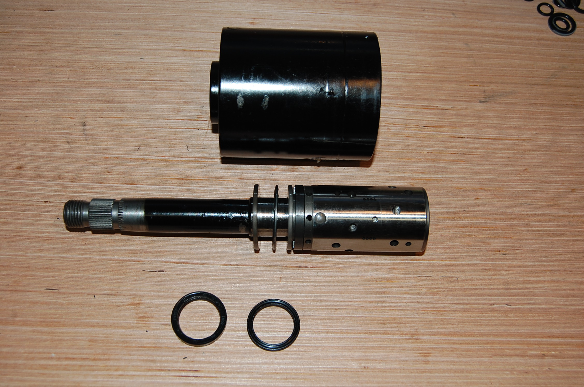

Any way, here's a picture of the seals; the one on the left is the "upper" dust seal, it's 22 x 30 x 5 or you can use a 22 x 30 x 6; the one on the right is "inner" oil seal. There is no size markings on it but it's roughly 22 x 28 x 4. I don't remember the technical name for it but this has "double" lips around the outside as well the inside and is one piece.

Thanks for the picture DirtHauler. This helps! Not much to it. The double lip seal ring is called a quad ring or X-ring. At least that is what we called them at the nuclear power plant I worked at. They were used in many hydraulic systems and valves. We had a cabinet full of these, all different sizes and materials. Many were metric. Quad rings really aren't good seals for high pressure. If they were used for high pressure systems, they always had a Teflon seal used with them. It's a bit strange not to have the Teflon seal with this. It's hard to believe a few bucks worth of seals could save this unit instead of spending $1,099 for a new one. I'll do some research, once I get mine apart. I copied this. It the SINJIN website. www.powersteeringunit.com/catalogue/eng_06RPPSU.pdf It doesn't tell me much, other than sizes.
