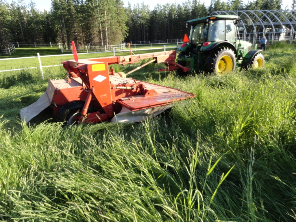

Your situation does not lend itself to a simple answer or a single, "do-everything" tractor; either. Nonetheless, I have used my 5075M to rototill inside my 35'x65' greenhouse/high tunnel and do all the hay chores, too! It's a challenge to keep the edge of the cab from hitting the rafter supports along the side of the greenhouse - but, it can be done. It would really be a piece of cake to work a 200'x50' "open-air" parcel!
That said, you can invest several thousands more into an M model versus a fairly equivalent E model. And, with your acreage and amount/kinds of farm work - you're probably committed to another larger frame tractor. So, those extra dollars could be used for that 2nd machine.
The new E's are a major improvement over the previous models. Power reverser transmissions (with creeper), cabs with air seats, better hydraulic options and loaders, HD plastic fenders and hoods - a significant shift towards the plus features of the M lineup. And, they are a bit shorter (wheelbase) and lighter than the M's, (the 2012 M's were stretched another 5 inches on the wheelbase) which makes them a bit more agile than their M stablemates. But.... the latest word is that those newer model E's won't be available until August.
However, if you need that tractor "right now" and want to use it on as many of the farm chores as possible - including hay baling - I'd look at the 5100M or the 5115M. With a 310 or 340MSL loader, wheel weights and/or filled tires with the added hydraulic options including the HD 3pt hitch - IMO - you won't have a problem with even the silage special 5' balers.
AKfish
That's the high tunnel in the photo.
