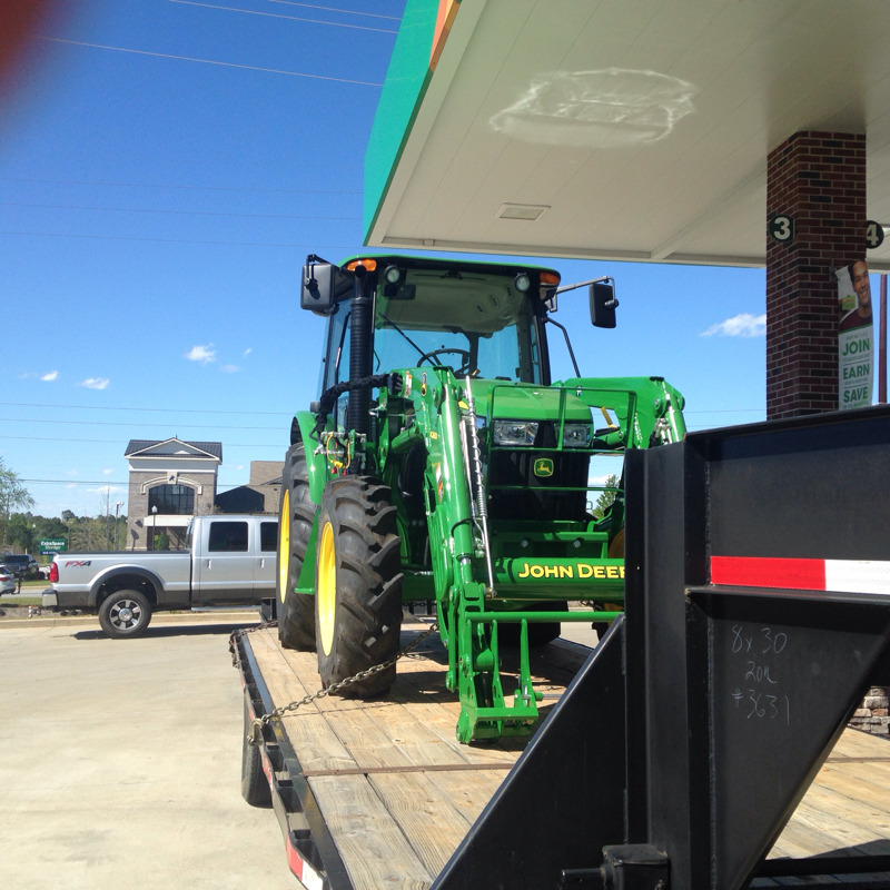

Congrats on the new tractor! I was only going to add that everyone wishes for more hp, never less. Enjoy the new ride though!

OOps ! I too like Eric the Oracle failed to see the previous page where you had already bought it. Which is it , can't tell for the photo ? Congratulations either way.
I run a MF2660 81 hp using a 7ft Bush Hog. Typically cut 56 acres of WV pasture field 2 or 3 times a year. I find a tractor that size ideally matched with a 7ft hog. Mows a heck of a lot of ground very fast when not steep. Some of mine is ... well.. darn steep. The 4wd 81hp is still very much the right tool. For 10 years I did the same job with a JD4700 using a 6ft hog. It took a lot longer but that was great machine and a near perfect match of cutter size and tractor size too. I studied the daylights out of the JD5085 before I bought the Massey. I think that the M versions really are better machines if you don't choke on the prices. That feature of having synchronized ranges, not just gears within a range, is huge to me. It says several things -- you are dealing with a different tractor chassis wise, not just luxury bells and whistles. I have zero knowledge of the cabs (a cab would not last 2 days where I cut!) I hear the M series cabs are worth it if you keep it long term.

It is a sweet cab!
