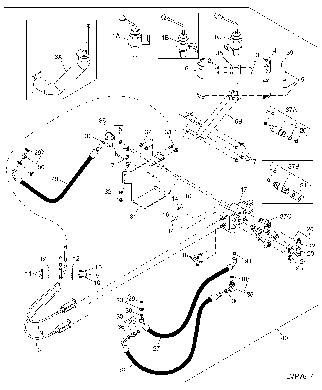

Tried that as well, as you can see in the photo, not much rust around fittings, but pushing in and pulling out doesn't do anything. It only pushes in a fraction of an inch...
   / 5205 Dual Control Valve - Loader won't tilt bucket #14
If the cables(parts key #13) are dirty/rusty then relieving hyd pressure on control valve is difficult causing quick-disconnects in your photo difficult to disconnect and more difficult to reconnect

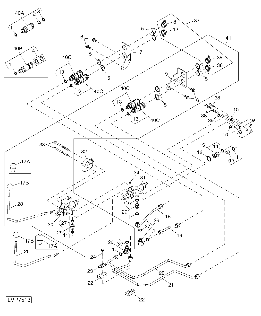

In your first post you said the lever for the bucket doesn't move back at all. I'll bet a new cable will solve your problem. Swapping the boom valve cable (at the valve) to the bucket valve would verify if its the cable.
   / 5205 Dual Control Valve - Loader won't tilt bucket #17
Sounds like he his loader connected the same way as my 5105 (same tractor as 5205 except for fuel pump). Tractor has two rear remotes operated by two levers on right side of seat. The levers operate the valves and I don't think that there are any cables.
   / 5205 Dual Control Valve - Loader won't tilt bucket #18
I'll bet there are cables from joystick to hyd valve. Look at the parts schematic I posted earlier.
#19
There does not appear to be cables on the diagram for the dual control valve. By the way "he" is a "she" :)LVP7513________UN20JUL06 (1).gif
