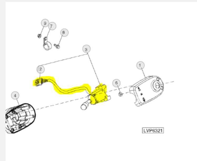

Does it have the "electro" controlled Power Reverser? I am thinking power washing got the reverser control wet inside.
That’s the style. It doesn’t look like dash or operator station was washed. Checking that with a meter I had continuity from an end wire to one of the other three in any given position. For instance continuity from a to b in foreword but not a to c or d. It would change in each position which is how I would expect it to be.

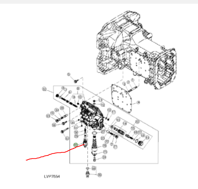

Next I would check the solenoid on the transmission, and it's connector
Check for continuity from B to D when in neutral. This is circuit for neutral start. Power comes in D and B goes to neutral relay K16. I am assuming open station tractor? If so, is a flat platform tractor or straddle mount? Wiring varies depending on configuration.
Excellent thank you, I’m suspicious of something like this and not hung on the pressure washing. It had had a larger fuse installed when it had a similar issue years ago. (Idiot) I will attempt to get to it because it’s pretty tight. The only thing gentleman at the service counter at the dealer would identify yesterday was the neutral safety switch which he then said “you probably won’t be able to identify.” Thanks fella. They wouldn’t identify any other electrical components on the transmission and said they will gladly come out and repair it when I’m finished. A little bit of an unnecessary attack on my livelihood but it’s what I have come to expect from our friendly neighborhood John Deere dealer.
I believe this clears the handle then I appreciate that. It’s an open flat platform machine.

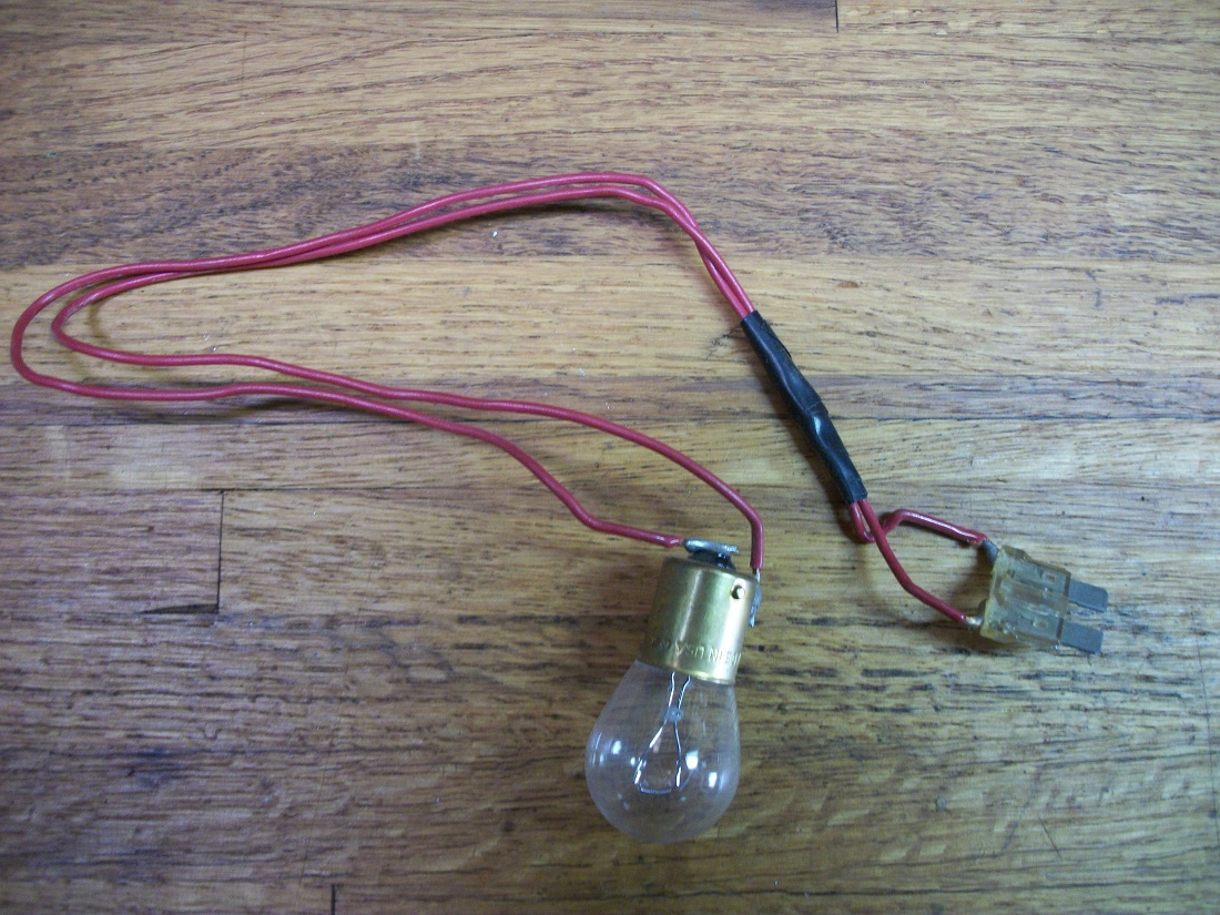

This issue has been isolated to the 10amp micro fuse F17 MFWD/FNR blowing instantly when the tractor is put in reverse. Having forward it just teaches us to currently carefully plan moves until I get to the root of this.
/ 5325 power reverser issue #20
Loadstar
Stick a rigged 12v light bulb in the micro fuse slot such that a short will just show up as a lighted bulb.. until you track down the short causing the problem.
