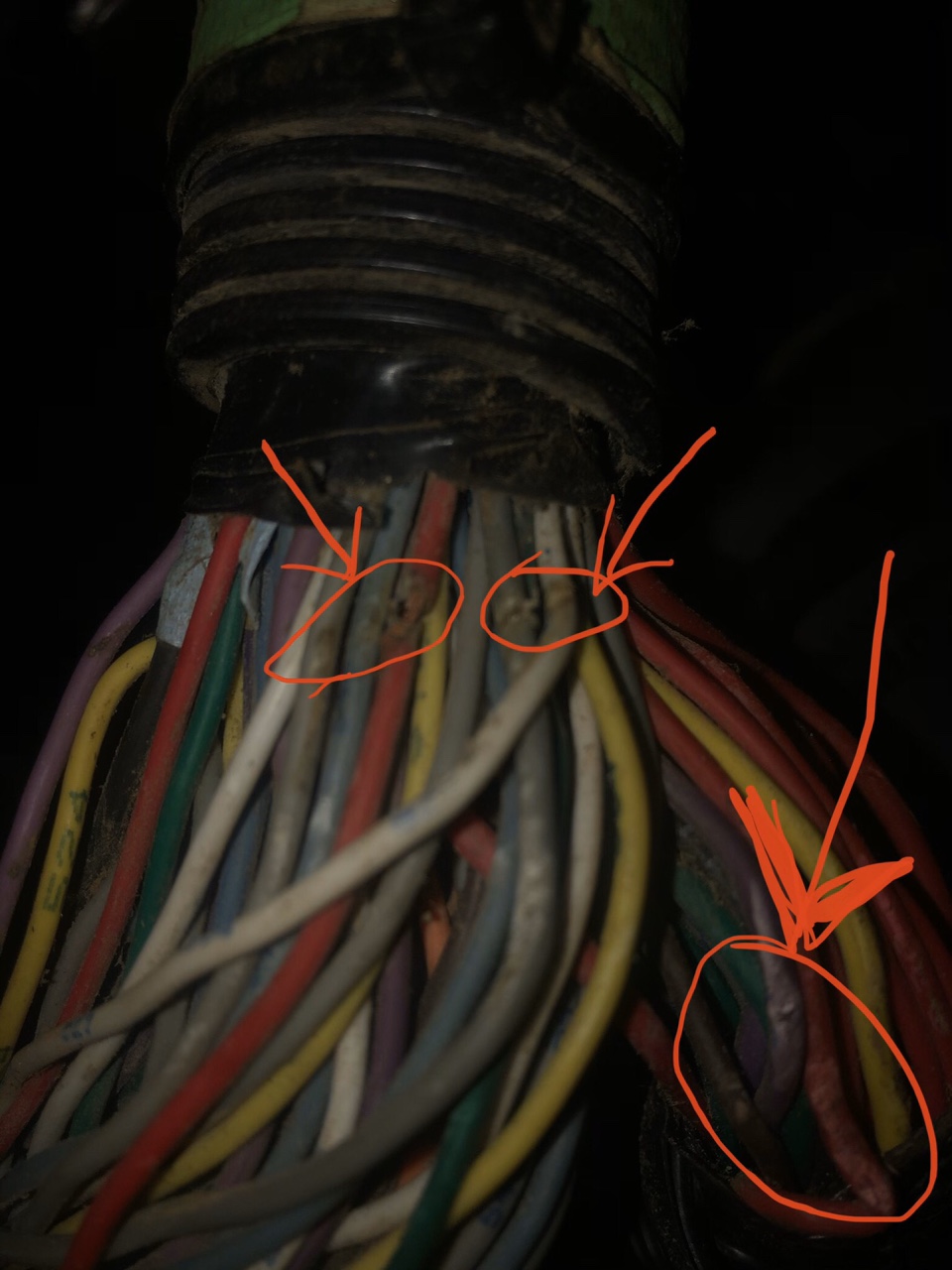

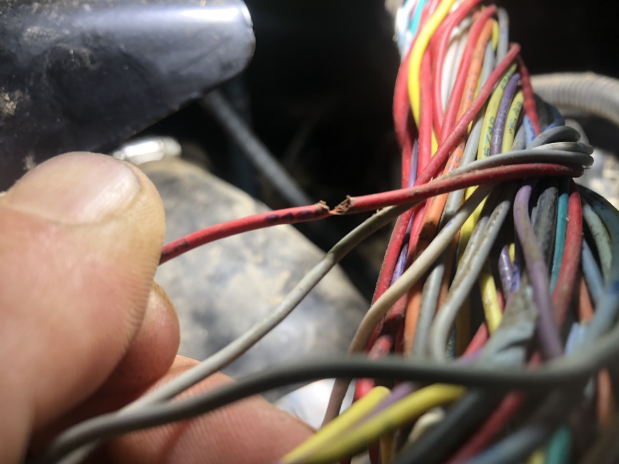

This issue has been isolated to the 10amp micro fuse F17 MFWD/FNR blowing instantly when the tractor is put in reverse. Having forward it just teaches us to currently carefully plan moves until I get to the root of this.
   / 5325 power reverser issue #20
Loadstar
Stick a rigged 12v light bulb in the micro fuse slot such that a short will just show up as a lighted bulb.. until you track down the short causing the problem.
