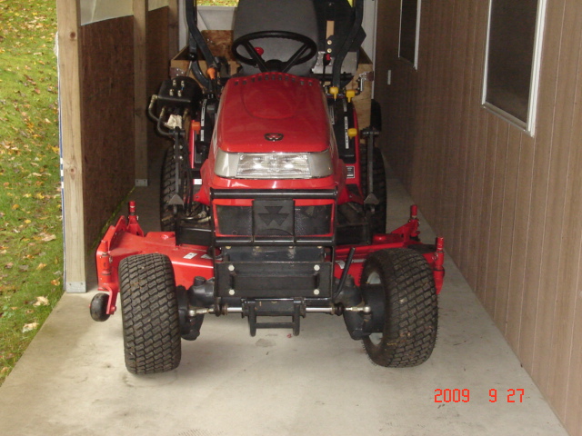

   / 54 or 60 inch mmm #16
I think the Kubota and MF decks are quite similar... with the removal of a couple of bolts, I was able to fit my 60" deck/tractor into my rather narrow parking spot. Simple solution- remove the discharge flapper/deflector.
I also feel that the deck does a better job of dispersing grass clippings (rather than leaving a ridge) with the discharge "chute" off.
That makes mine 62-1/2" wide, but perhaps that's still too wide for your trailer... just a thought.
