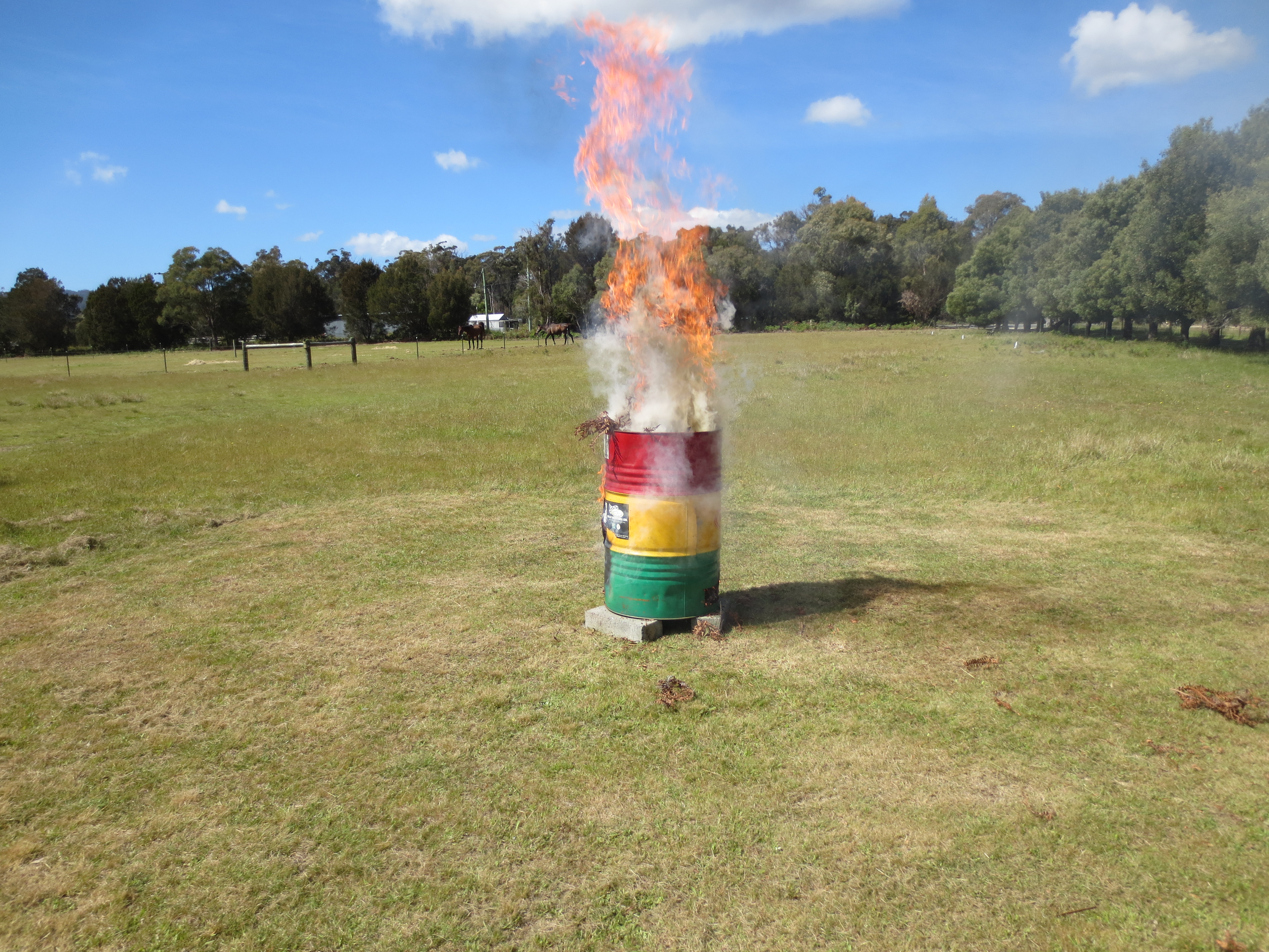

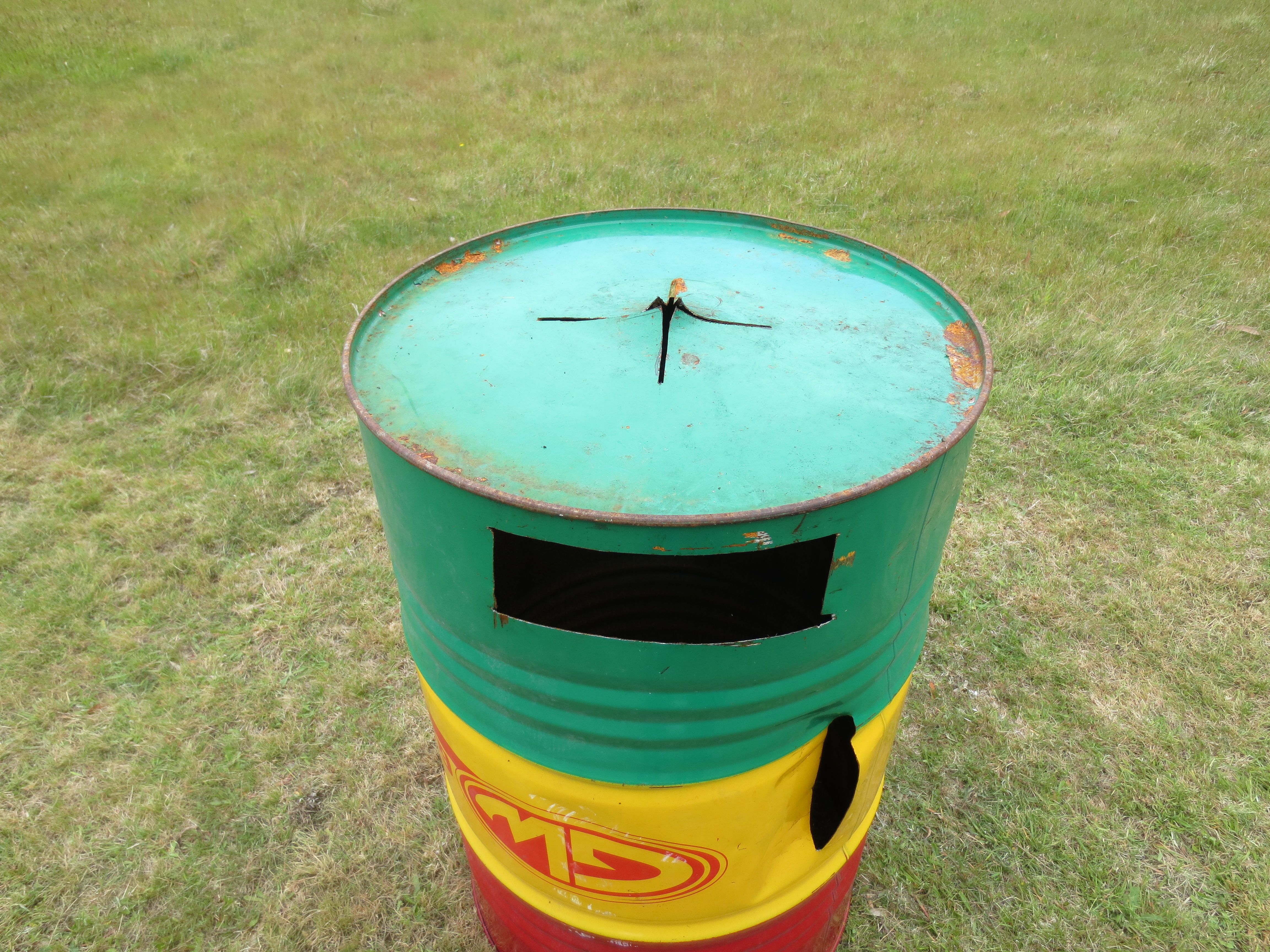

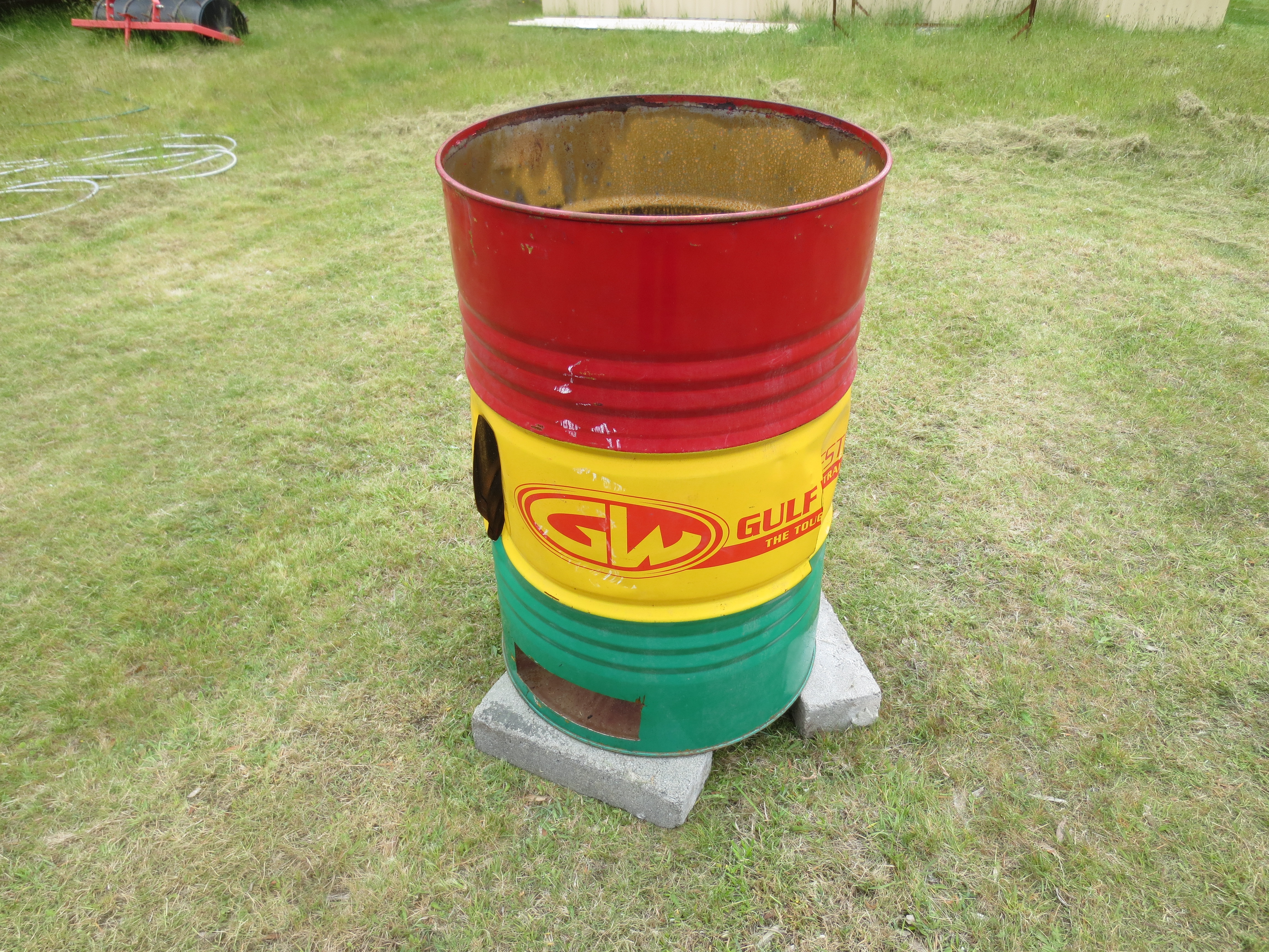

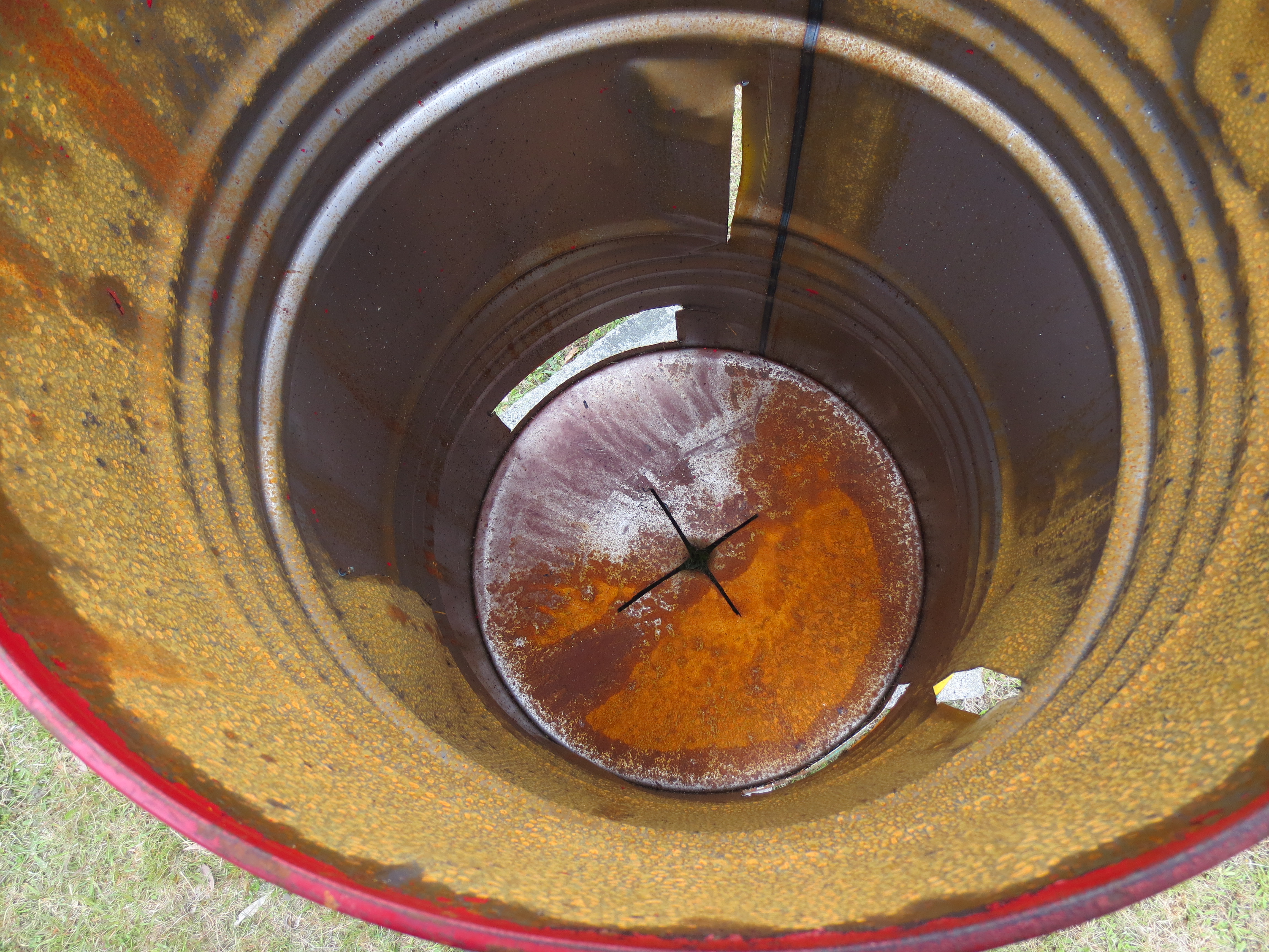

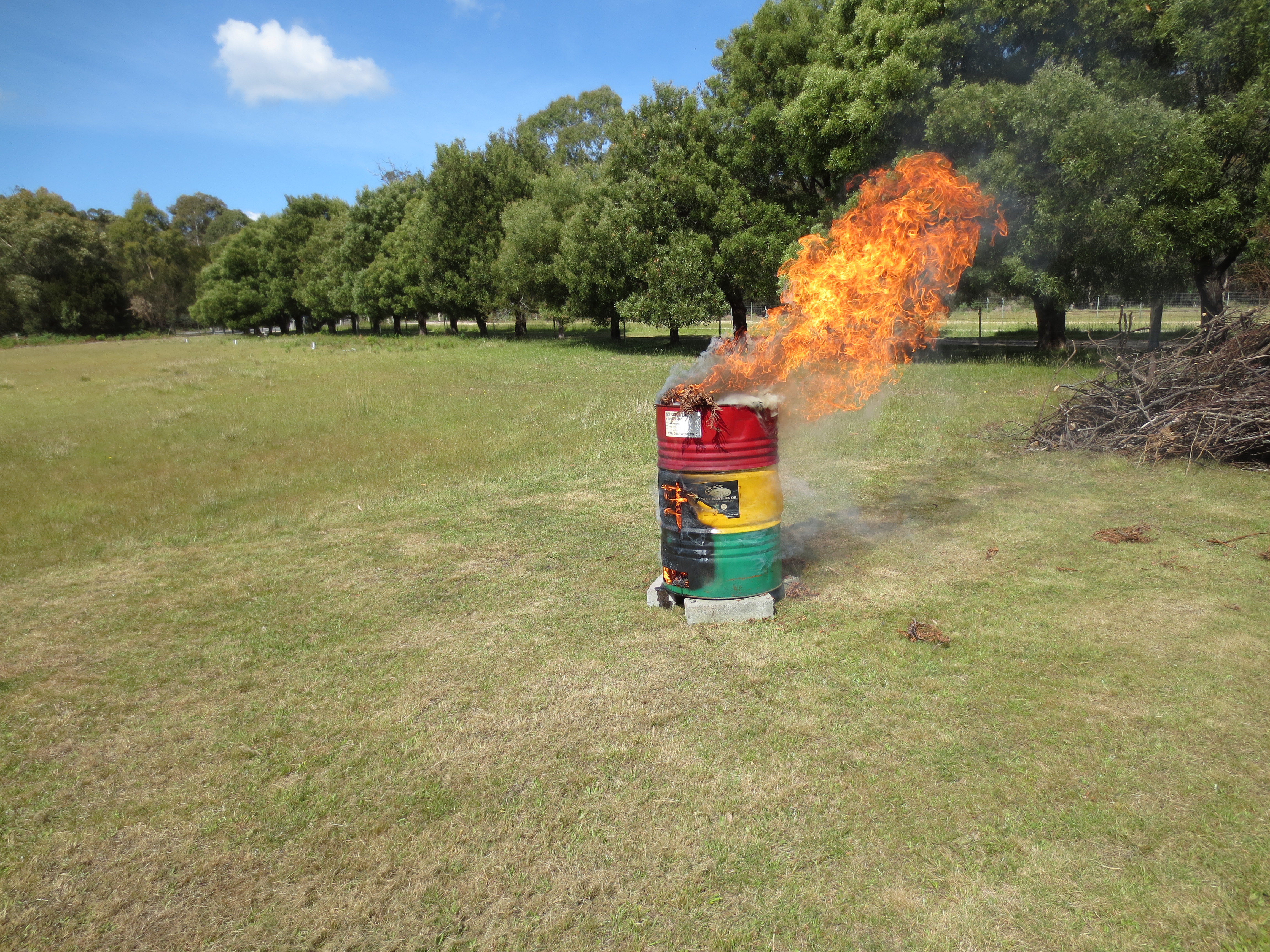

I know that I had a 'Burn Barrel Designs' thread on TBN a couple of years ago.
Went with a sweet "cyclone" design that works a treat!

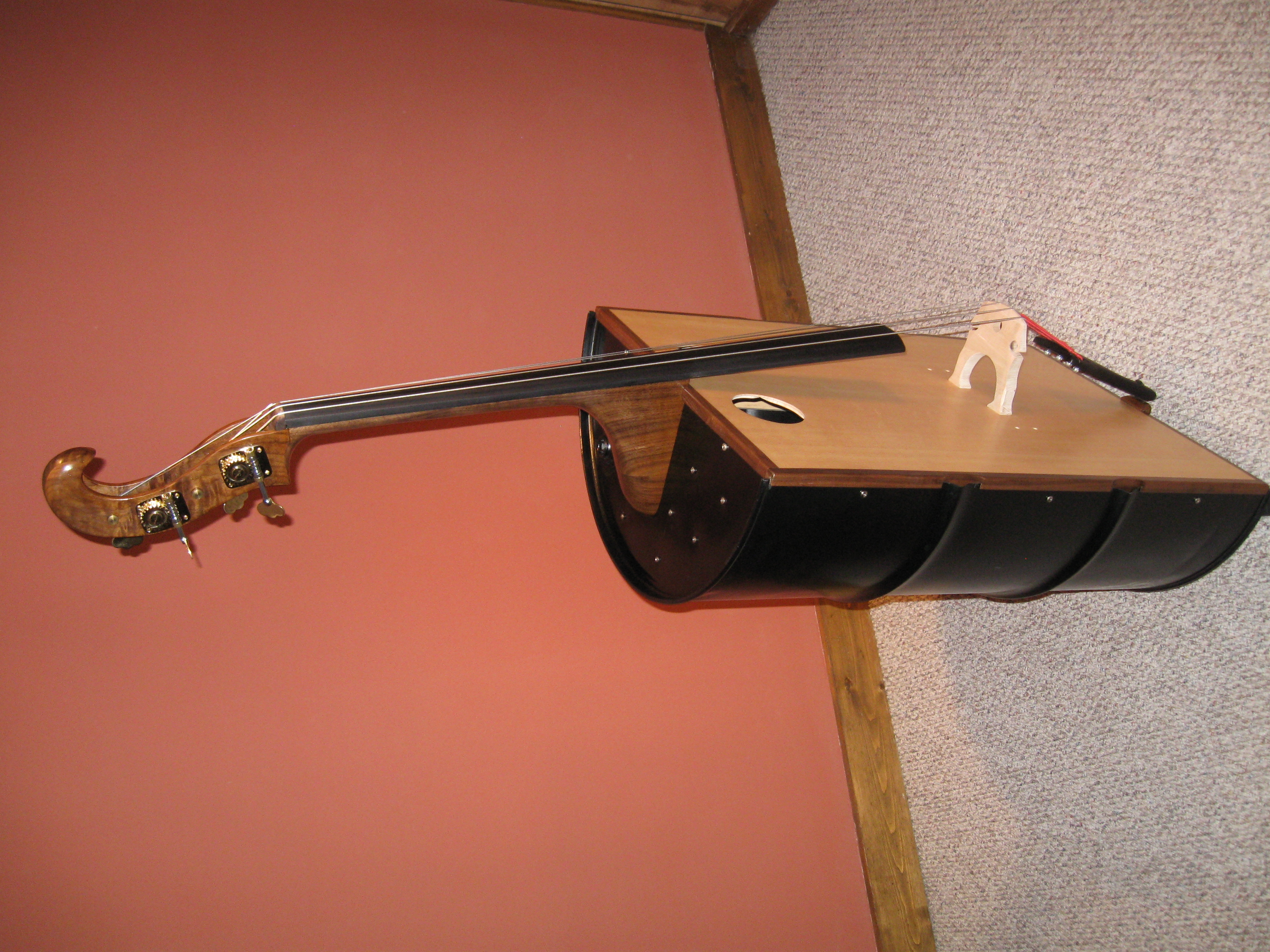

I cut one in half and made a 27.5 gallon bass out of it. It sounds good!
I found the burn barrel thread you mention but would you say your pictures above are what works best? I could knock out that pattern with a plasma cutter in mere moments and start burning. Do you put any wire screen or mesh over the top for spark control?
G'day Mate.
With my own research, here on TBN and on YouTube, going with the 'cyclone' design looked to be the best way to go due to the side vent scoops. Everything that I've burned in it has been reduced to a fine white ash = very little clean-up at the end.
You're right in how quick & easy cutting one of these barrels up. Just a "sharpie" marker for where to make the cuts and (for me) an electrical hand-held counter-rotating circular saw made quick work of it. I considered using a spark arresting screen, but didn't in the end... opting for a somewhat calm day to conduct the burn whilst wearing long sleeve cotton shirt & trousers, boots and (most importantly) Anti-Flash hood & gloves ('liberated' from my Navy days ;)). The heat from this barrel design is intense!
