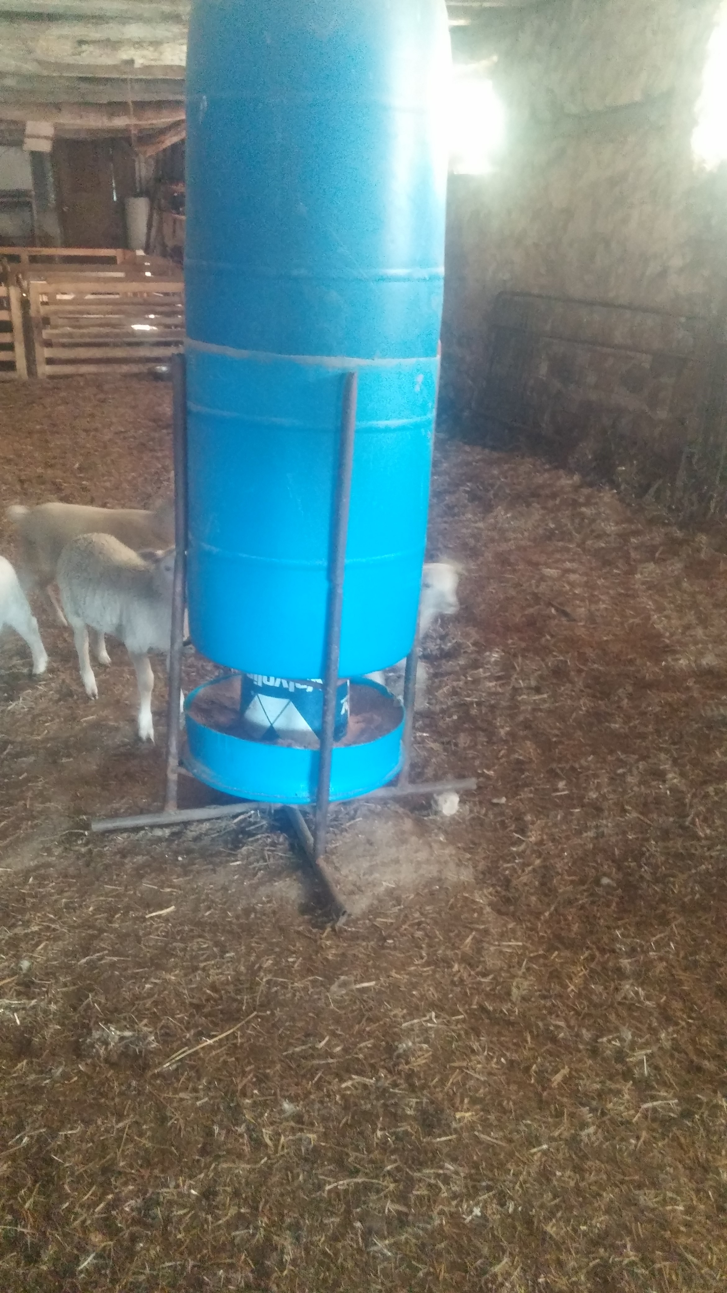

20160625_195854.jpg I made these for feeding lambs. One plastic barrel plus one plastic oil pail cleaned out real well. bolted together with a 6 inch hole connecting the two. leave an inch gap or so at bottom of trough. the extra barrel on top is so we can pour feed in from upstairs, not recommended to fill both as it becomes quite unstable.

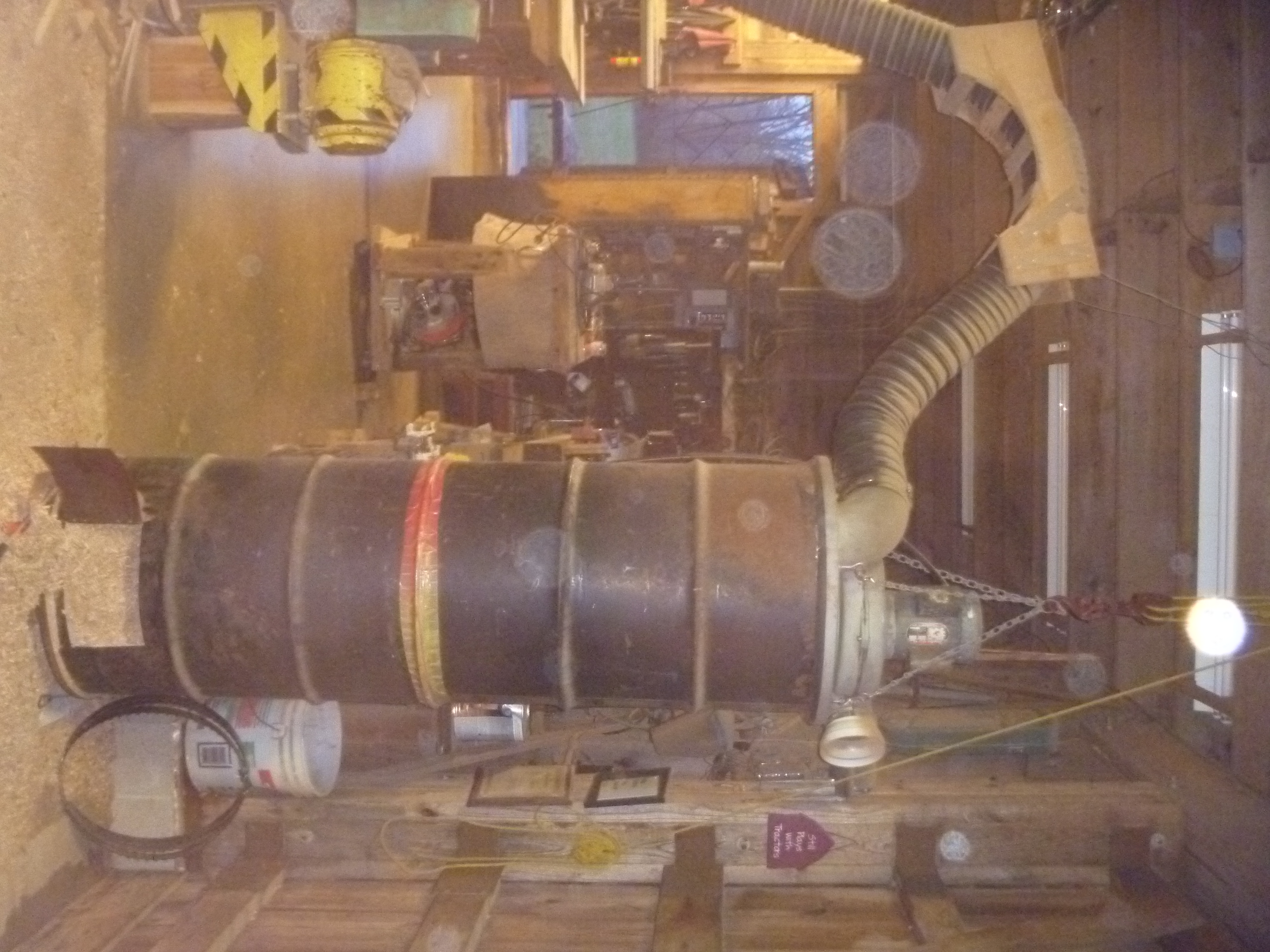

I welded 2 together to make a sawdust collector for my planer. I can fill it in 20 minutes so I should have welded 10 together. :D
