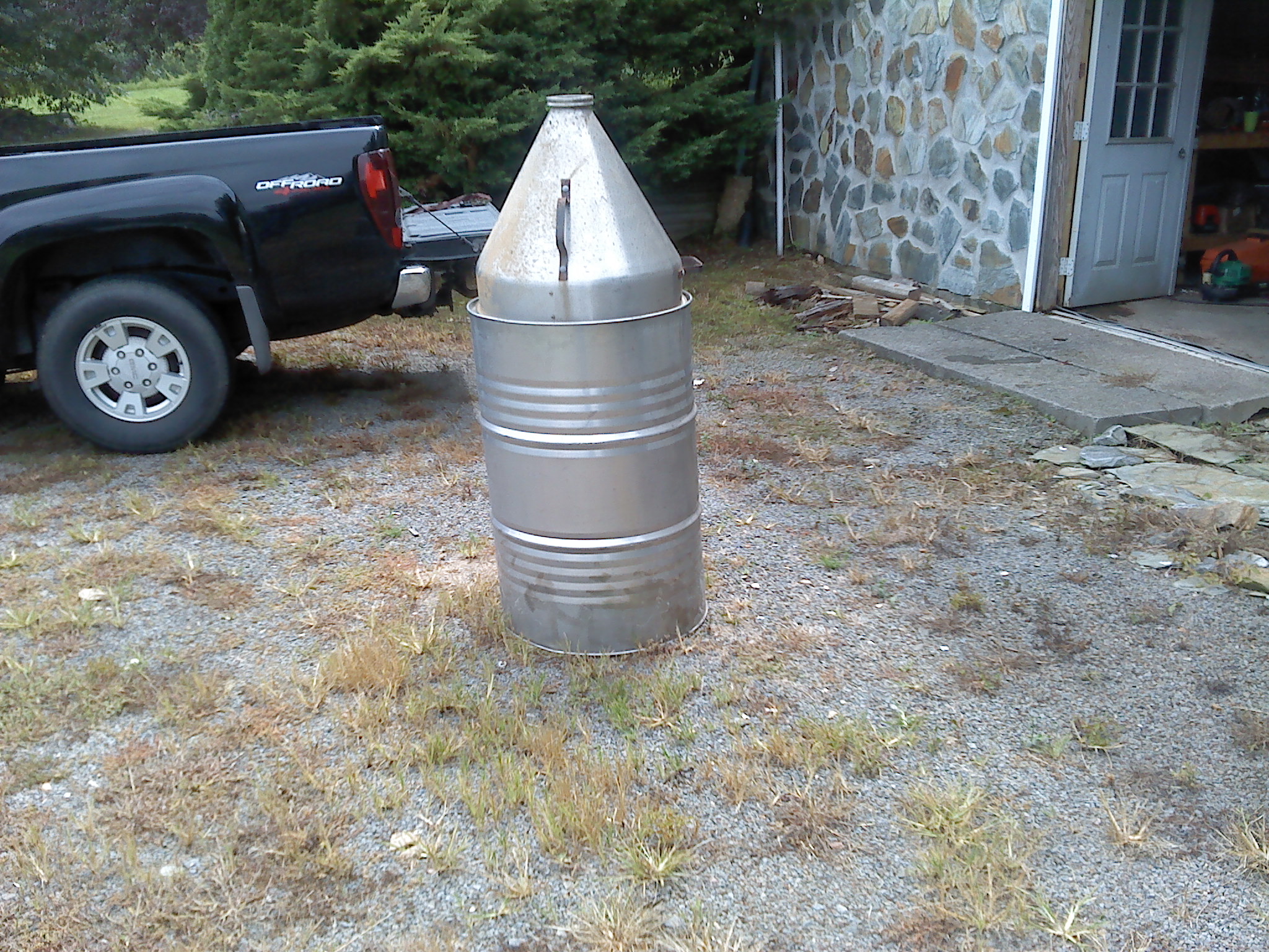

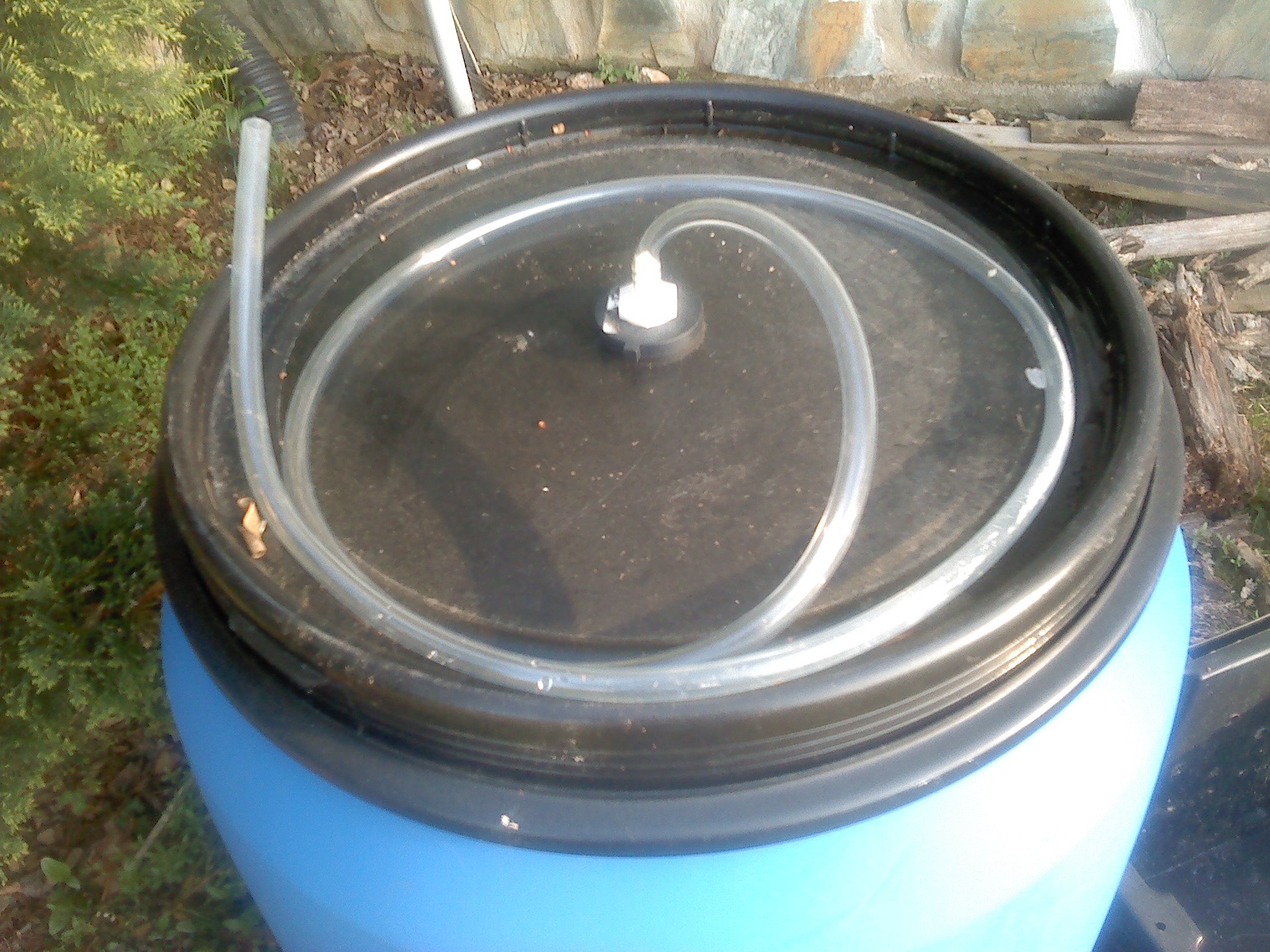

well, if you take a stainless barrel and add a cap, then a plastic barrel and add a air lock, a little copper pipe, I'll just let you figure out what to do with it.
