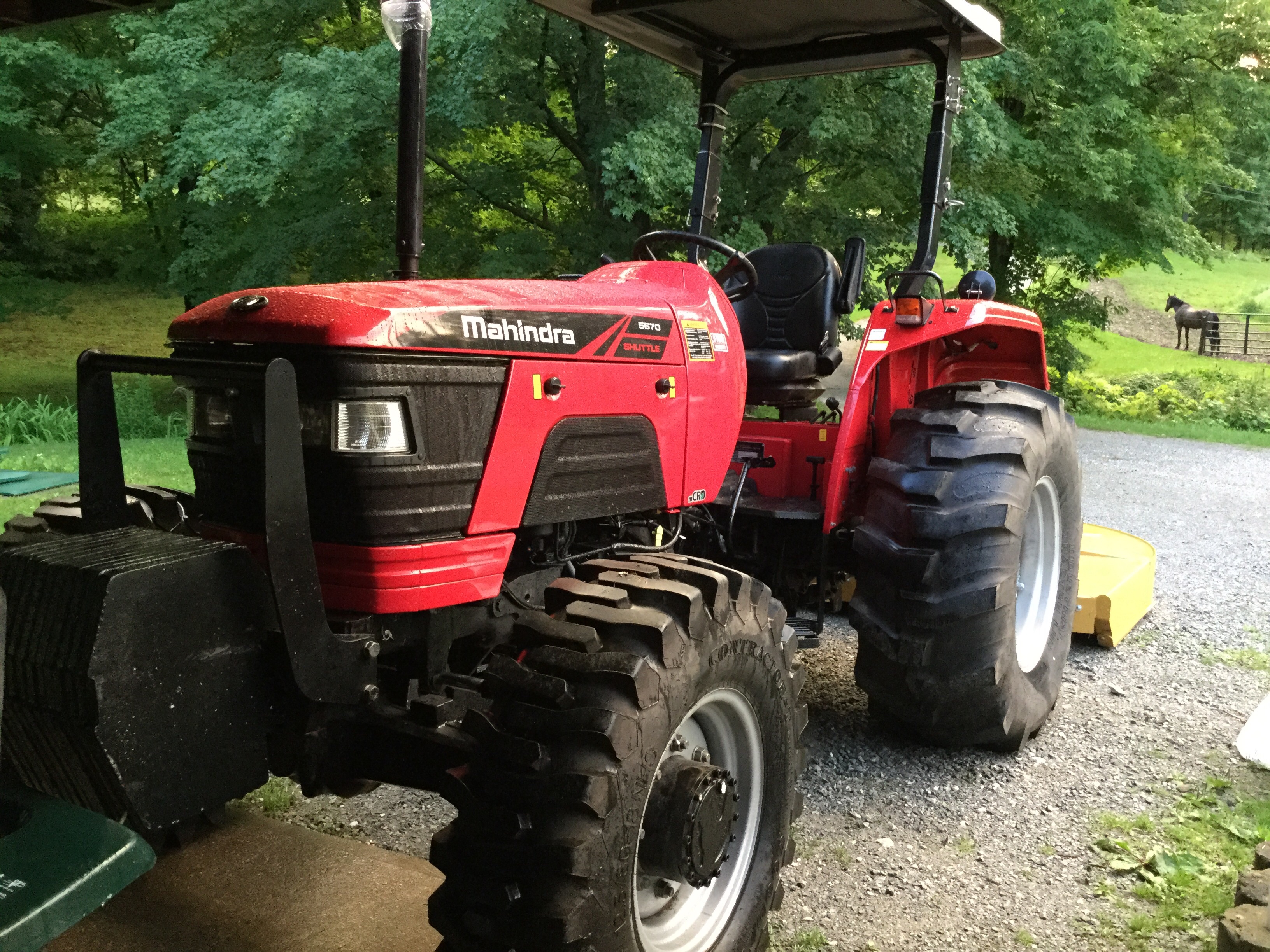

Just got my 5570. I bought it from a a dealer in Michigan. 2015 with 219 hours. No loader.
It's been sitting for quit a while. Runs nice.
All manuals are on order. Just a few questions please...
Are there lubrication points that will make this tractor shift easier. I realize it's not a fully synchronized tranny (maybe I'm wrong there) but I think my shifter might be fighting me a bit.
Also are there any special procedures for putting it in 4WD? My 4WD T-handle moves VERY hard.
Where do you check hydraulic oil? Tranny oil?
I see a grease fitting on the front position of the hydraulic pump. What kind of grease and how often? ....please.
There is a fitting on the side of the tranny. Same grease I would think?
I'll read my manuals carefully when they come, but I'm itching to get out haying and brush hogging on this machine. Don't want to hurt it in any way.

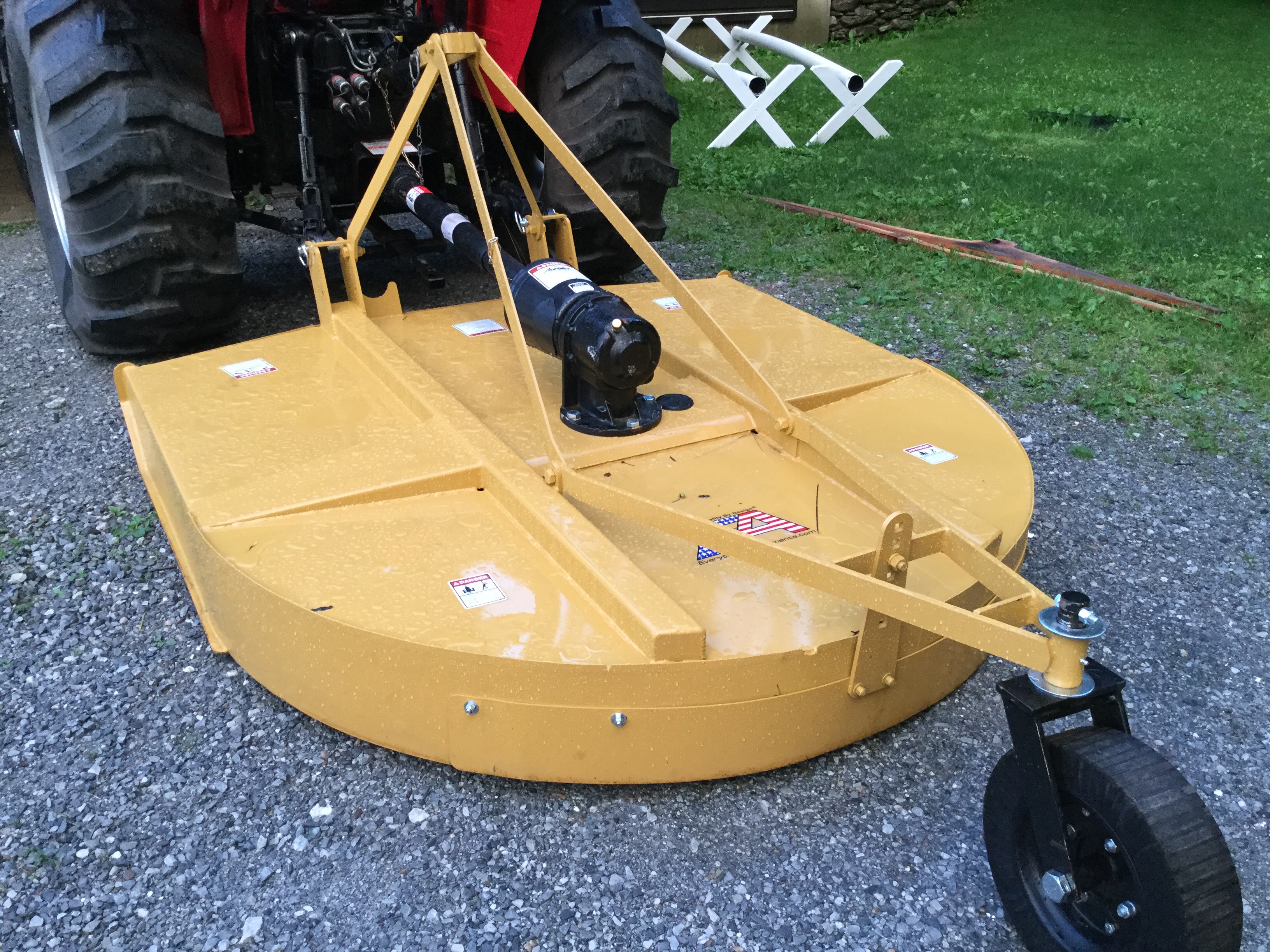

Hey! As a side note. I bought a 6 Foot rotary mower from "everything attachments". Nice piece of equipment. 2,000 and free shipping to Vermont! image.jpgimage.jpg
