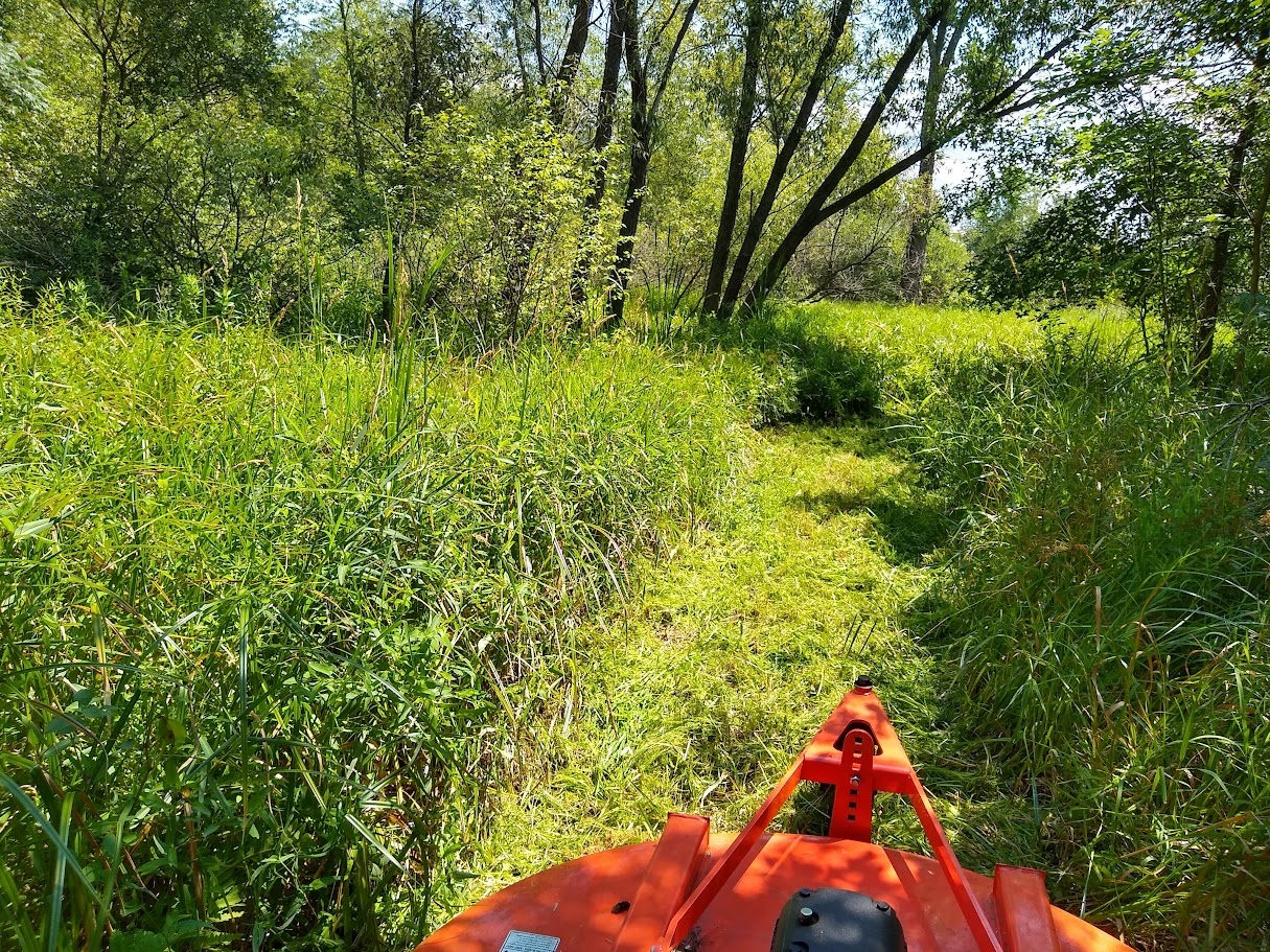

I was aware of the HP to mower size ratio, but dealer told me to go with 5' on my little 24 HP B2650.
5 years, plenty of slopes and I never wished I was went smaller.
