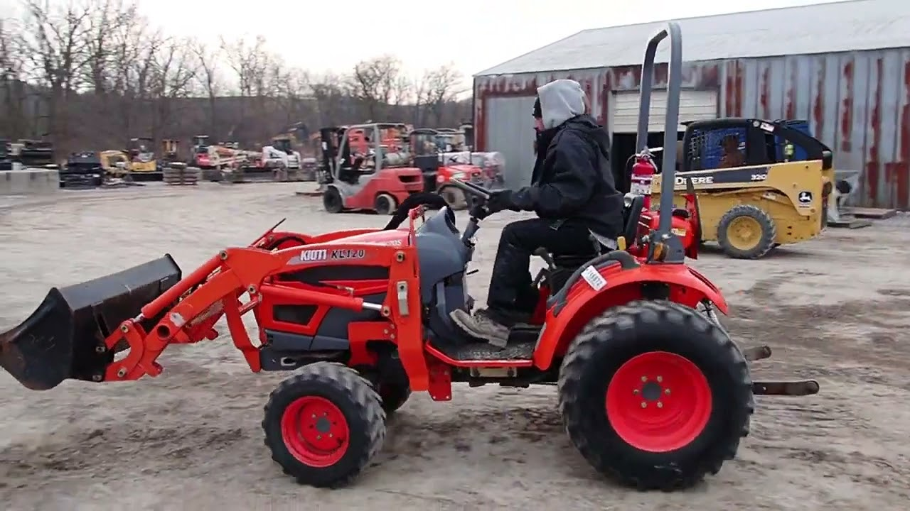

The owners manual on my Kioti ck20S states that a 4' mower max with a manual and a 5' max on a hydro tractor. The dealer said that with a hydro if the tractor starts lugging you can just let up on the go pedal. I have ran a 5' for years with no problems. BUT, would make sure back tires loaded and wouldn't use without a loader or front end weights.

Yeah they are almost a ton. Im sure it is well over a ton with the loader. I also have my tires loaded. Lifts and handles it fine. If i was mowing more than my 2acer field once a year, i think a 4 footer would be the better option to save on machine wear

CK20s are the smallest compact made. Not a subcompact. Everything on it is cast iron and they are heavy for their size. BUT they are still a small tractor. The reason the manual trans model called for a 4' mower was due to available hp. The HST model has a few tenths less hp at the PTO but can quickly adjust ground speed to compensate for lugging the engine. We have sold all three farms my wife and I inherited and I am no longer bush hogging 50-60 acres every year and no longer having to 'trim' around fields with crops in them. People have stopped and asked me why I had the little tractor in the field when there was a larger tractor and mower also there and I would tell them that it was my weedeater to go around the edges.

I run a 5 foot with my 2400H (24 HP) with no problems on flat ground. Never connect top link just let roll on the tail wheel. Adjust my speed based on material being cut.
For your safety at least use a chain in place of the top link. If the tractor will not pick the rotary cutter up you should not be risking danger to yourself by using it.
