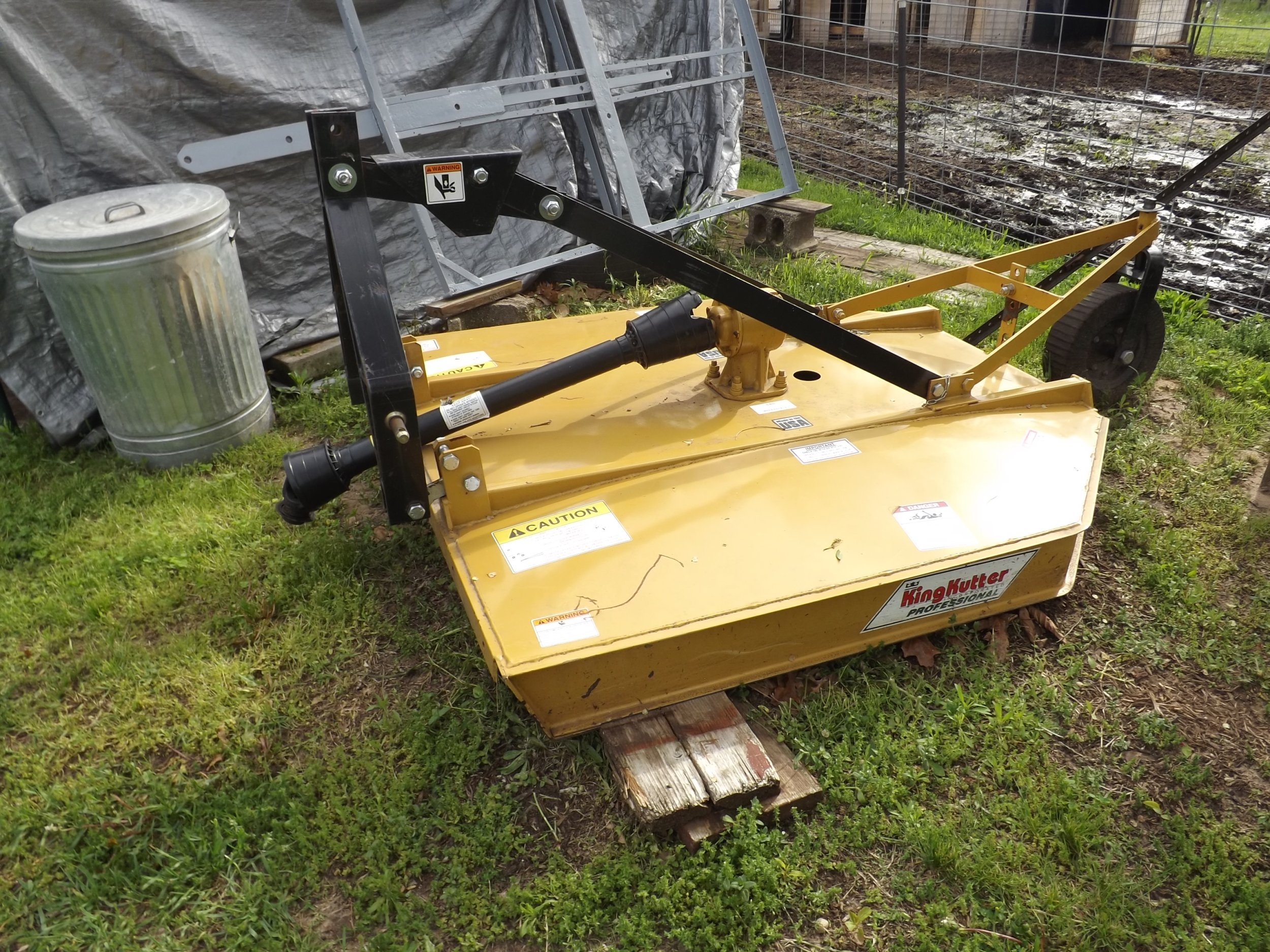

i have a tym t25 and i just picked up an old 5ft brush hog tonight. Thing is heavy built, deck is way thicker than the new entry units at tsc and rural king. That being said first i need to make sure the 3pt will lift it and the tractor handles it well. Second is if i have enough motor and if the tractors gear box will handle it. One would think it should as the old ford 8n's and farmal's had less hp and would run them fine. But those old tractors were built heavyer and bigger than these new compacts. Thoughts?
Here's my "two cents worth":
In/around 1995 I bought a 1991 Kubota B20 from a local equipment rental company. It had about 1500 hours on it {as I remember} and one can imagine that those who rented it weren't too interested in its care! Does "rode hard/put away wet" ring any bells?!
I bought a WELL USED 5' Bush Hog to use at my hunting camp and was told my 17/20 HP tractor wouldn't be enough machine.
Being one of those who had to have "things" proved instead of going by what others say -- I welded it back into working condition, new/added supports, new blades etc. -- the Stump Jumper was SOOOO loose the blade tips would hit the underside and had actually chewed holes/slits/dents in the deck from basically flopping around when on -- I was amazed the guy had been using it and the only reason he was selling it was due to just buying a new 7' Bush Hog for his Ford tractor. As you mentioned, the newer ones aren't near the quality of the older ones -- his new 7' BH lasted him less than 5 years!
So -- my tractor is a 17 HP Kubota and will produce 20 HP when running implements -- supposedly! I have never put it on a machine to see as I don't really care.
After selling my asphalt business in 1998 at age 49 {retired? -- HA!} I decided to start Bush Hogging/Minor Land Clearing and I have done quite a bit when I choose to -- IF I did it for a living -- I wouldn't! {Bush Hog and minor Clearing - farm & garden services - craigslist}
My Kubota B20 with my 5' Bush Hog has no problem mowing/cutting/chewing up just about anything -- BUT -- hard wood saplings over about 1" to 1 1/2" and even those get pushed down with the loader bucket then drove over!
I've got videos of 14'/15' tall vegetation before/after that doesn't stand a chance with me -- again, I am not cutting acreage {usually 3 to 5 acres is my limit as I don't push my machine -- unless it's steep, I'm in 2nd gear and have a Hydrostat so I watch temperatures close.
As I'm in central Arkansas it gets HOT/humid in the summer months and I would build an enclosure and install AC -- but a 17/20 HP won't handle it along with implements -- so I will sometimes pass on a "project" if it's too hot, too steep, too thick etc.
As I will turn 72 in May and have repaired just about everything I've owned -- less all the crap that is computer operated! -- I don't worry too much about having to weld something back together.
All this being said -- unless you're going to cut/mow/Bush Hog 5,10,20 acres or more on a regular basis, your 25 HP will handle a 5' Bush Hog based on my experience with mine.
Here's one final thought -- ever use one of those old PUSH rotary lawn mowers {or even a regular mower} to mow grass in your yard? If you let the grass get too high -- you probably have to go slower and maybe even go over it twice.
Same with Bush Hogging.

If it's cutting HP that's the limiting factor, can you buy a 4" blade and use it? Yes, can't cut close to a fence, etc. but cheaper than another hog.

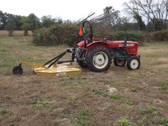

If your TYM T25 is a diesel, then you could even run with a 6FT stump jumper King Kutter brush mower. I'm doing this now with a 26Hp PTO on a Yanmar YM2610.
