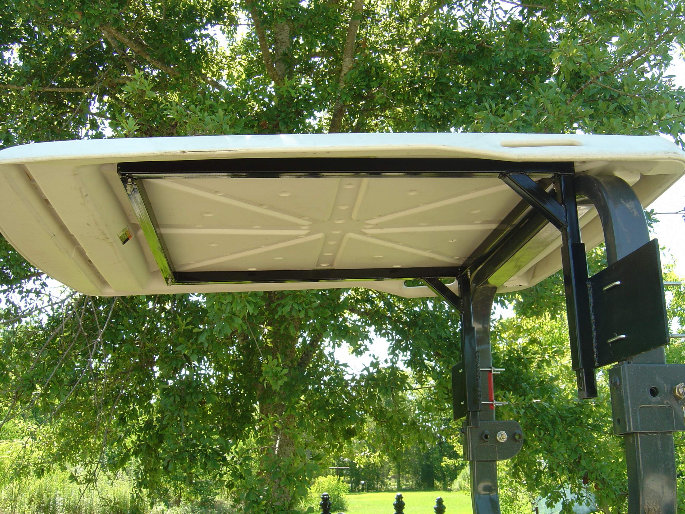

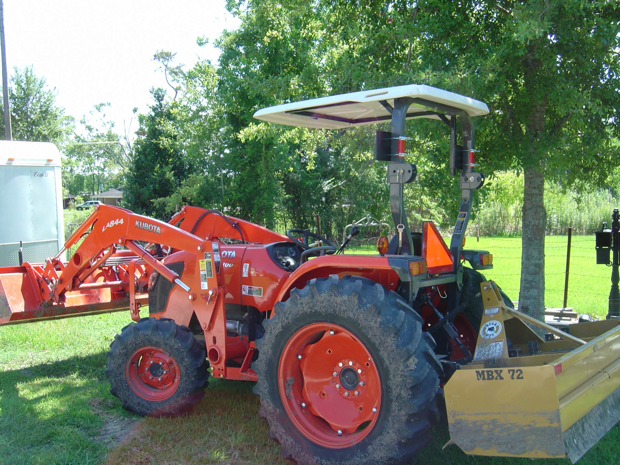

So for the past few days its been 95 to 100 out side and i've got one heck of a sunburn sitting on the tractor.
Priced a canopy at the kubota shop. . . i don't think so.
so i made one and i have Just over $60 in it.

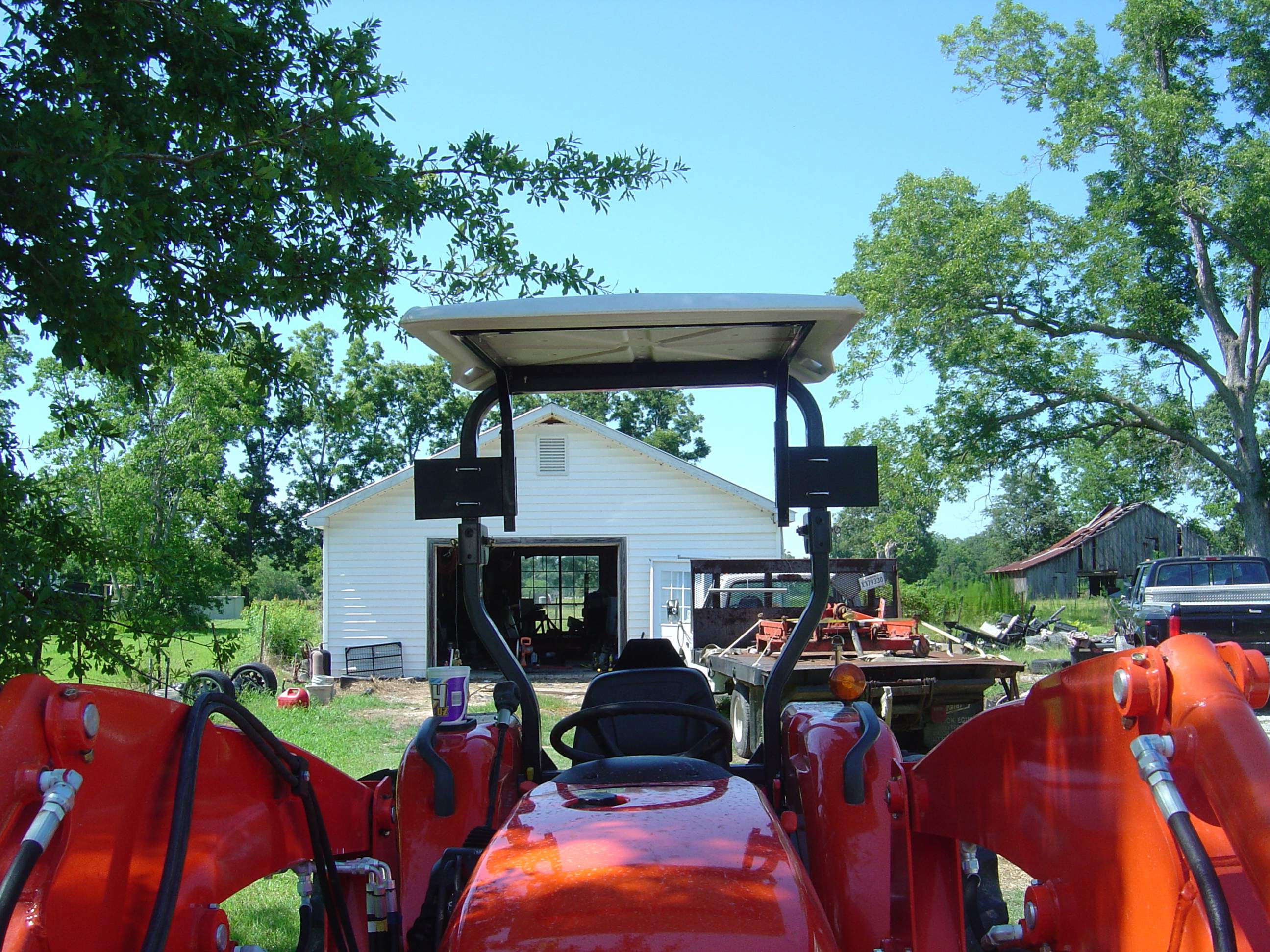

I wanted this thing to come off easy, because when the rops are up my tractor will not fit in the door.

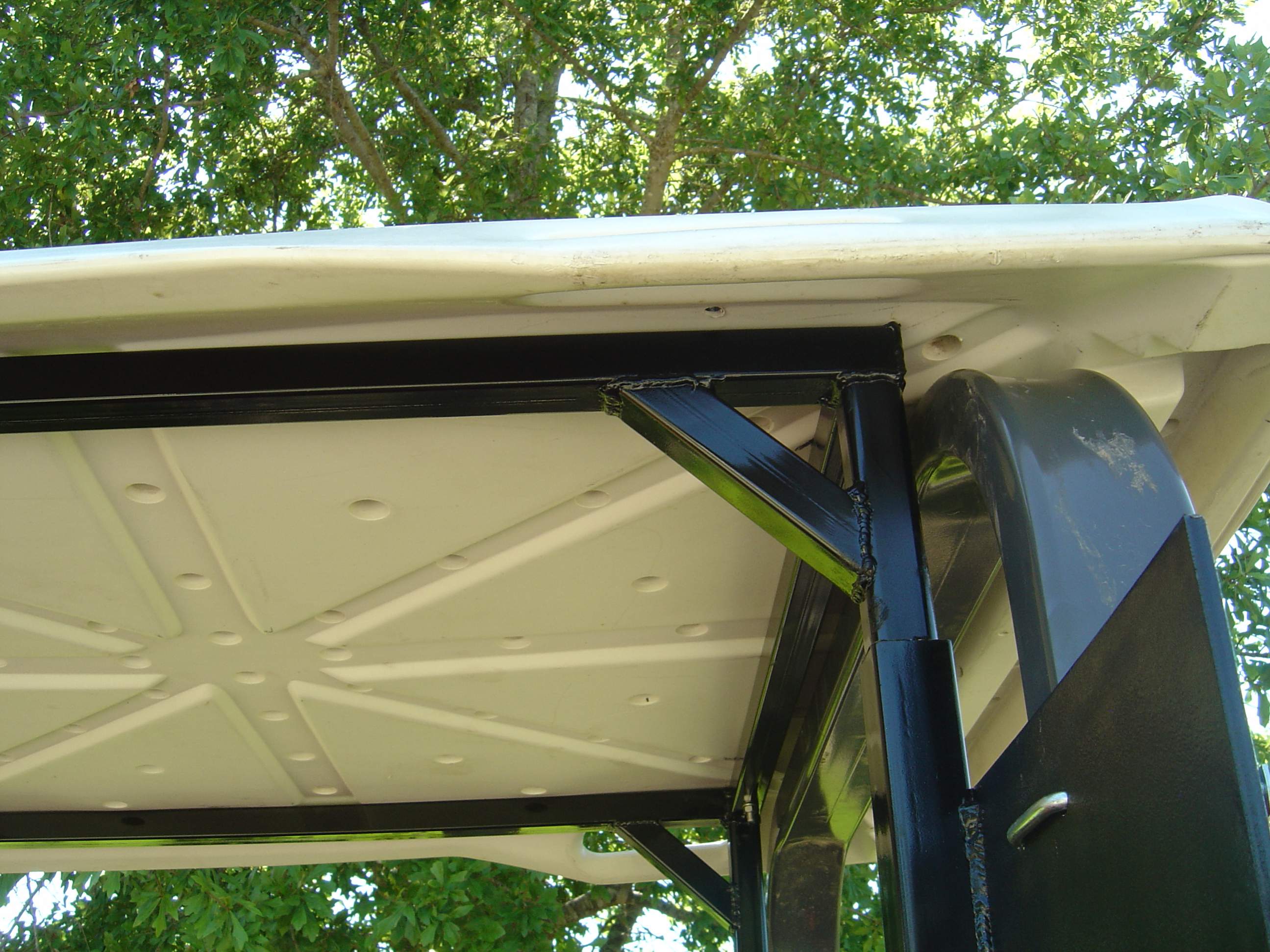

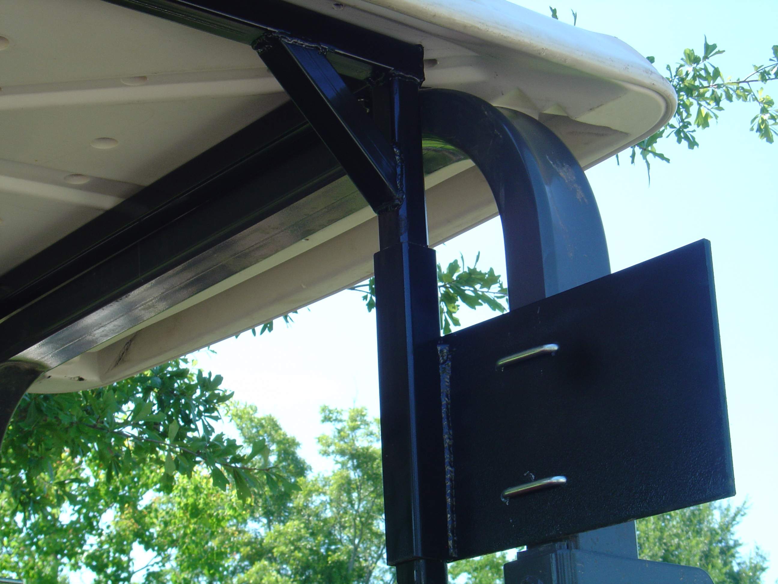

so i welded a 10" long x 1 1/2" tube to a 6" wide x 12" flat plate. I then used u bolts and bolted it to the ROPS.
Then i made a frame out of 1 1/4" box tube. it was 3' X 2' 10" . On one end i welded a 10" 1 1/4" down leg on both corners and the welded on a 7" angle brace to the down leg and the frame.
The down legs slip into the 1 1/2" tube that i bolted on the rops.
next i bolted a used Golf cart top to the frame with 5/16 stainless bolts.
$18 steel
$25 used golf cart top
$20 in u bolts stainless bolts and rattle can of black paint
i do wish is was a little bigger but for the price couldn't pass it up.
once i pop off the canopy i can still fold the rops and get in the shed
I plan to add some lights to the other end of the plate (the ones in front of the tractor get blocked by the bucket.

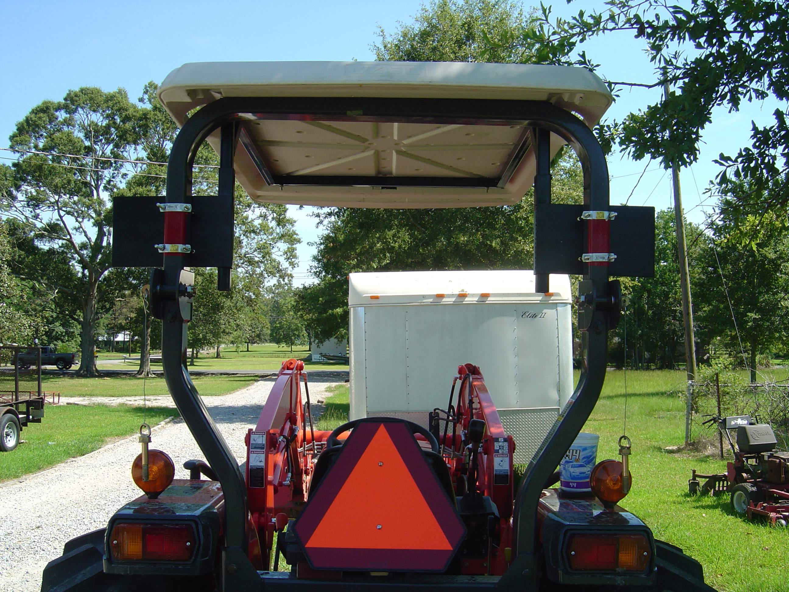

just a couple other shots

Nice job. My factory canopy will fold down with the ROPS and not hit anything. Give it a try.

Nice job, Big Bri. looks very professional. Can you tell me about how many hours it took to complete it?
/ $60 Canopy ! ! !
Now i'm no fab shop guy, but after i picked up all the steel, the golf cart top, and the hardware i have about 4 to 5hrs cutting and welding. then just had to wait for the paint to dry. it really wasn't that hard.
I picked up the top from a golf cart store. they had about 50 used tops in the back, told me to pick one out and it would be $25. they all had scratches, chips, or cracks. i just found the nicest one.
I picked up the steel from a Gate shop, they make iron gates. i find it cheeper to buy from little shops like this, lowes and homedepot are to high, and the steel shops want you to buy in bulk.
Good luck if you try one and if you have any questions on how i did something just ask

Looks good and a simple design - I may copy it (I hope that is why you are sharing:) )
Before the safety police take a look, I hope the ROPS locking bolts are in place when you use the tractor.:eek:
Cityfarma
[/QUOTE]
i thought someone might bust me after i posted the pic. Bolts are in place as we speek:)
