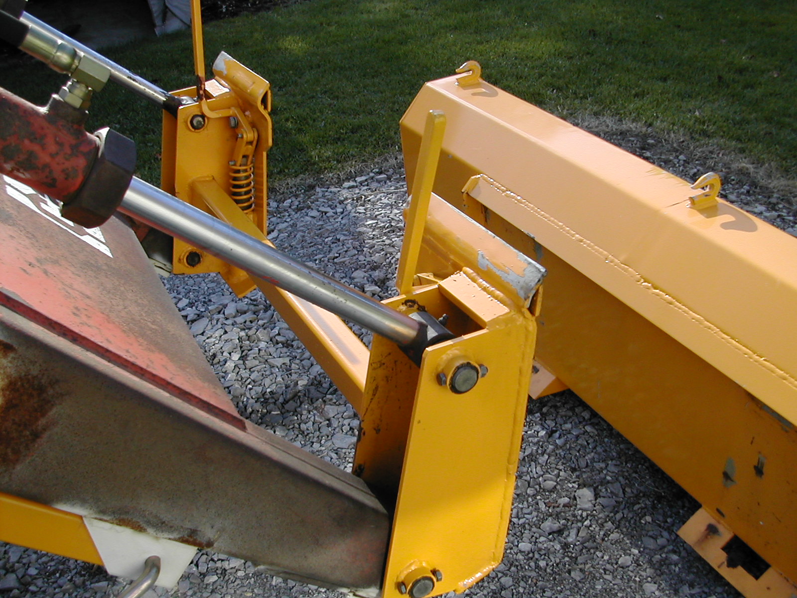

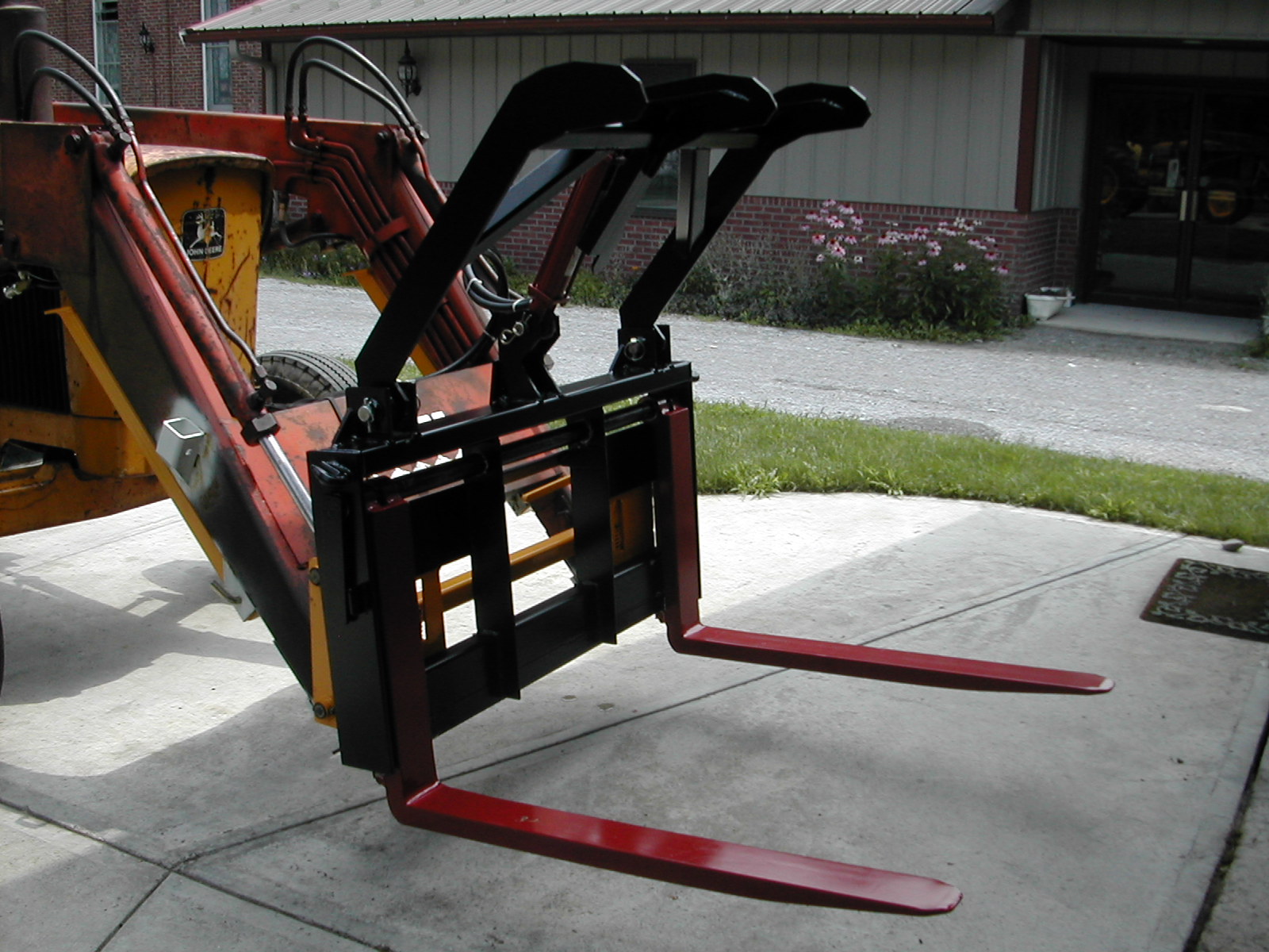

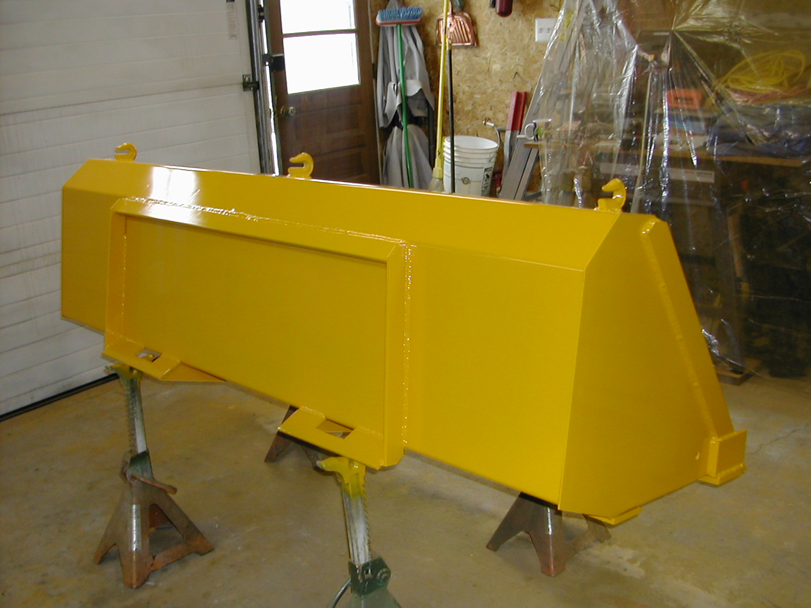

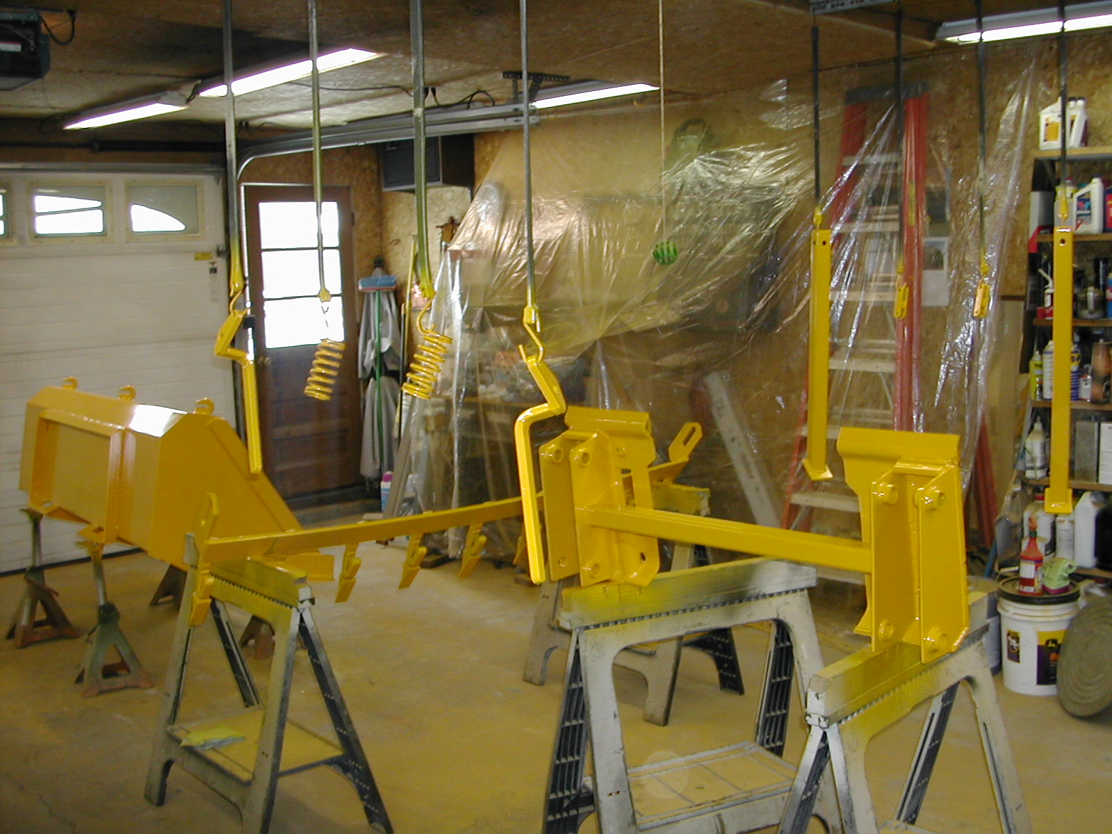

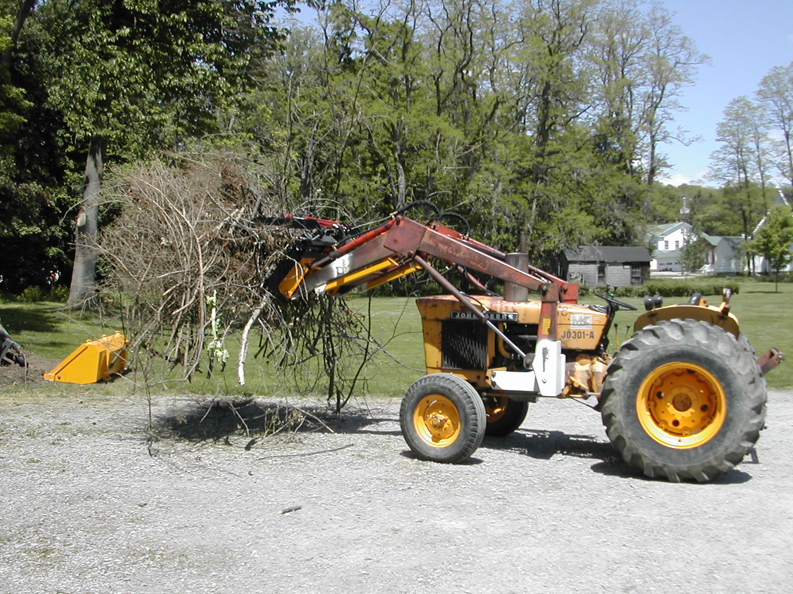

Nice job - that looks great. What you did is actually almost exactly what I was thinking of doing. If I compare your setup against the ATI setup - you've got minimal extra metal - and you haven't really moved the bucket out any further than the standard pin-on setup.
I bet more weight could be taken out of it without reducing it's strength at all by getting a hole saw and cutting some strategic placed holes.
You've got one cross bar - just like the Kubota setup does - whereas the ATI setup has two pretty beefy looking ones. All of that adds weight - and decreases capacity.
If you have the specs on the SSQA and could forward them to me that would be great. It would come in very useful when I get the welder going :)
Oh - and I have thought about the JD quick attach setup too - I've actually got some of the pieces hanging around somewhere here because I was experimenting with trying to adapt my BX23 FEL to use a JD setup. I think between the JD and the SSQA - I would go the SSQA route though - the JD setup is proprietary to them, even though it is very common, whereas the SSQA configuration is pretty much an industry standard.
Haha....... great minds think alike. Mine does put the bucket out a bit more, since the SSQA I bought for my tractor was somewhat of a 'universal fit'. I lightened mine up with a holesaw also (plus some drill bits). Still..... adding the SSQA was the best thing I've done to my tractor.
http://www.tractorbynet.com/forums/customization/140902-adapting-skidsteer-qa-my-kubota.html

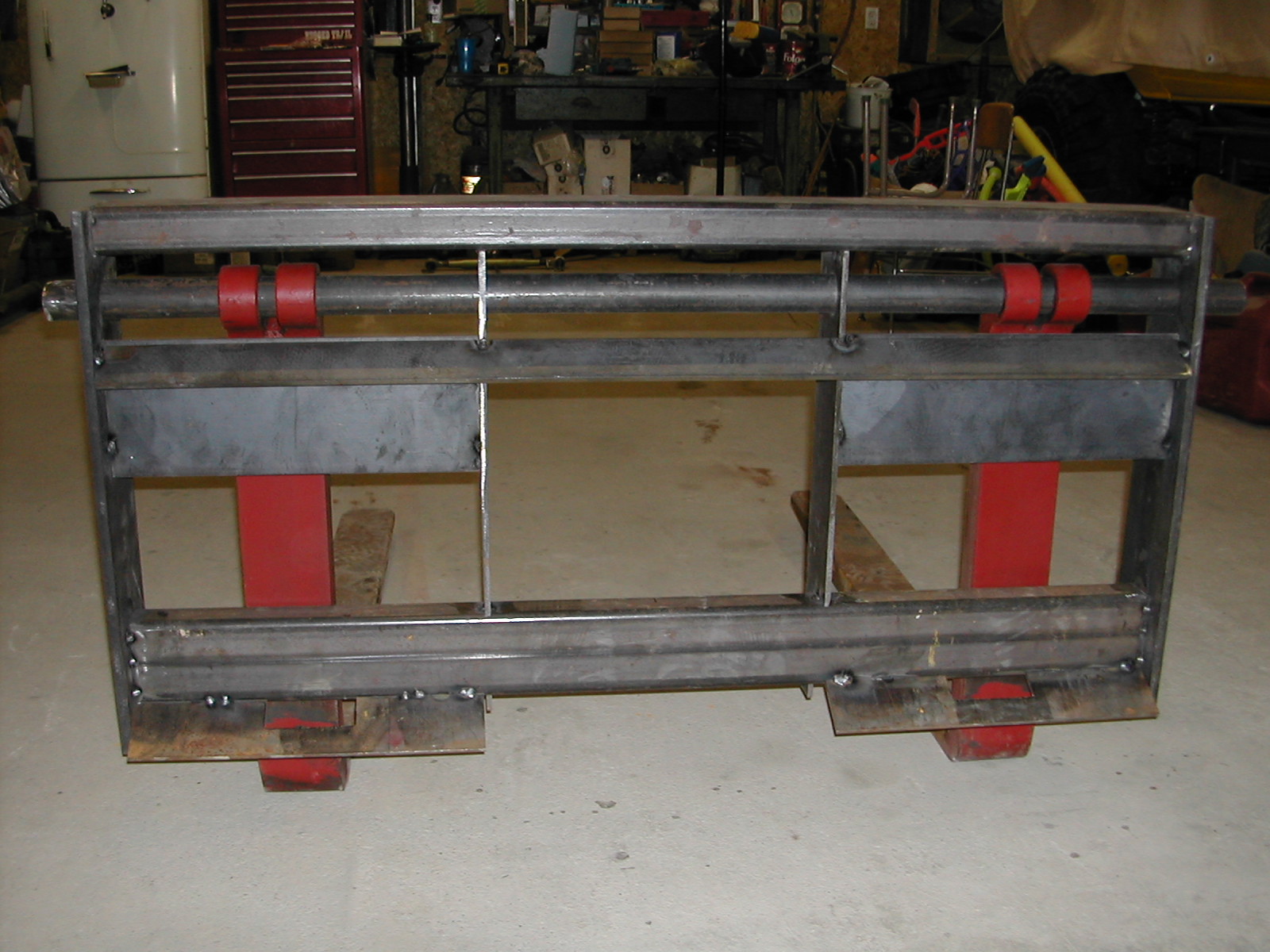

Hi Jim,
Thanks for the compliments. Yes, the parts I made could have been lightened up further. I think sometimes you get close to ending a project and just want to finish it up. The forks and grapple were also probably quite a bit heavier than they needed to be. Most of the steel that I used for that was a freebie. Sometimes it takes longer than it should to build something when you have a limited quantity of material to make what you want. Anyway I will stop rabbling and here are the spec's I had for the SSQA. Let me know if you need any more info. I have saved various pictures of mounts over the years. I looked at the ATI site again and their bracket did not look too heavy. I attached a picture I had of the ATI. I will have to look on site here to see if someone has posted one on the B3300 loader. I think the steel may be fairly thin wall, helping to reduce weight. I also attached a couple of pictures of a bucket with SSQA bracket that were quite minimal as far as adding weight. A local New Holland dealer was clearing out a bunch of buckets. I should have bought a couple. Prices were good. Good luck and take care.

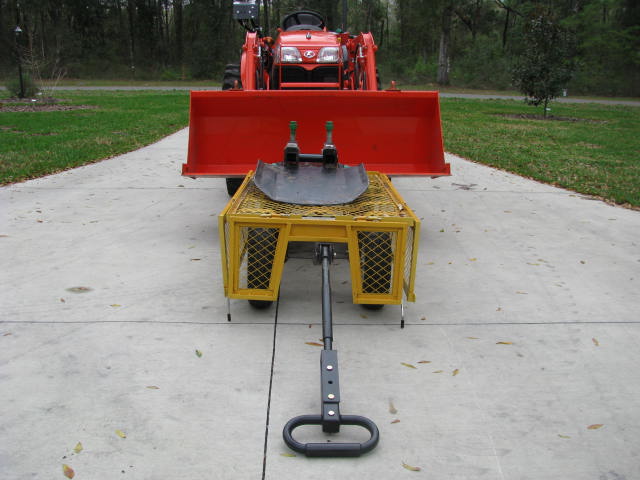

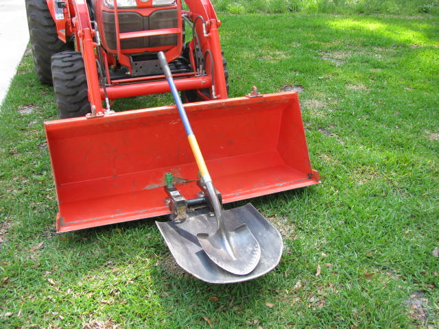

I purchased a Kubota B3300SU in February 2012.
This package came with Kubota's L504 Loader with 54" bucket.
The outside width of the tractor + tires is 54".
I use this rig for keeping up trails and improving access in a forty acre heavily wooded, brushy area. Maneuverability was and remains an important issue.
The bucket has Ken's Bolt-On-Grab-Hooks installed in line with the hydraulic cylinders. The factory bucket + 5/16" chains + bucket hooks have been used a lot to pull old logs, well settled into Florida loam, out of the dirt prior to backing up and using a Hanging Tree attached to the 3-Pt hitch to skid these partly decayed logs to the burn pile. The entire tractor setup has been solid and given no trouble.
Ken's Bolt On Grab Hooks
When it comes time to dig out living trees I use a clamp-on Bucket Solutions Bucket Spade, rather than digging with the bucket. This is a good tool; 100 pounds. The spade takes out everything up to 4", roots and all, in just a minute, again in Florida sandy-loam with minimal rocks. This small stuff is chipped with a Wallentstein BX42 PTO chipper and used on the trails.
Tractor Forks, Bucket Forks, Loader Forks
I recently purchased the well-reviewed Ratchet Rake from my local Tractor Supply for $299 plus tax. It is reputed to work well loosening up rocks. So far I have only used it to knock down and tear out brush, at which it is effective.
My advice: If you have a specialty need get whatever specialty tool is required. Do not count on the bucket to be a universal tool....it isn't. If you spring your bucket it will reduce your enjoyment of the whole tractor experience. Even a relatively small repair is more expensive than the correct implement to forestall damage.
