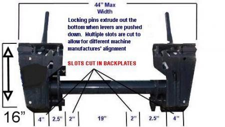

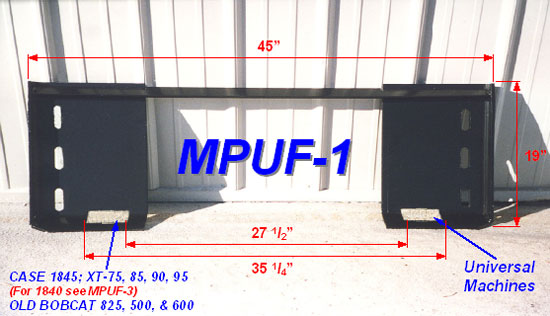

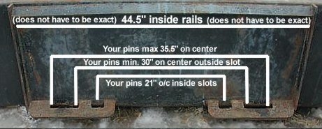

A couple more pictures of SSQA's with measurements I found on here. Plenty on the website here as I assume you already know. Hope it helps.
  • 75291d1177387373-here-universal-attachment-mount-specification-sae_j2513[2].pdf
