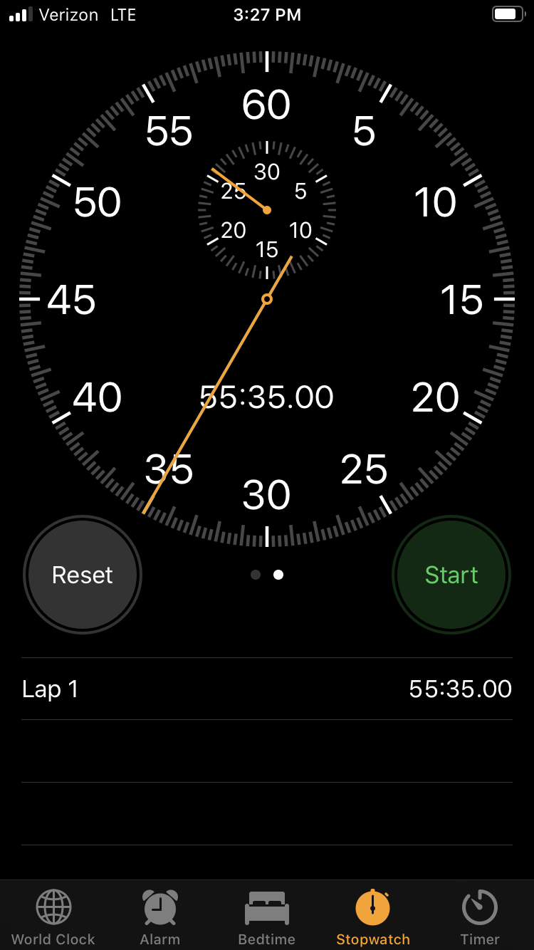

Real life information. We had 2-1/4 acres that I mowed for over 20 years with 5 foot decks (both MMM and RFM) and at a sensible speed it took about the same amount of time regardless of deck - between 1.25 and 1.5 hours. In 2012 we increased the yard to 3-1/2 acres and at the same time went to a 6 foot RFM. The mowing time remained the same as it was for 2-1/4 acres with more horses and the 1 foot wider deck. The yard has some trees, sheds, a creek and a couple other obstacles.
Due to the need to overlap, a 5' deck may cut about 54" after that first pass while a 6' deck will cut 66". That works out to 5 fewer passes on an area 150' wide.
Starting in the Spring of 2019 I went to a 7-1/2' RFM and it allowed a more leisurely pace but still cut down on the time. Last week I mowed to "git 'er done", but still didn't travel fast enough to be hard on me or the equipment. I used the stop watch on the phone because I was curious to see how long it would take. Below is a screen shot of the stop watch.
It can take longer if I'm mowing after dark, or doing cute patterns. Cutting at the rate of 16 minutes per acre while cruising comfortably works for me. I could have sworn it took about 20 minutes an acre last year.

Otherwise, a 72" deck is 20% bigger. If same ground speed is used, you gained 20% more ground covered. If we convert that to time, you'd save 20%. So you'd do the same mowing as your example in an hour and 18 minutes rather than an hour and 30 minutes. Saving 12 minutes each time you mow. In 7 mowings you would gain 1.
83% of 90 minutes is 75 minutes, not 78 minutes. You also have to factor in overlap. Assume 6" overlap, so the effective cutting width of each deck is 66" and 54". So it's 82% not 83%. 74 minutes.
