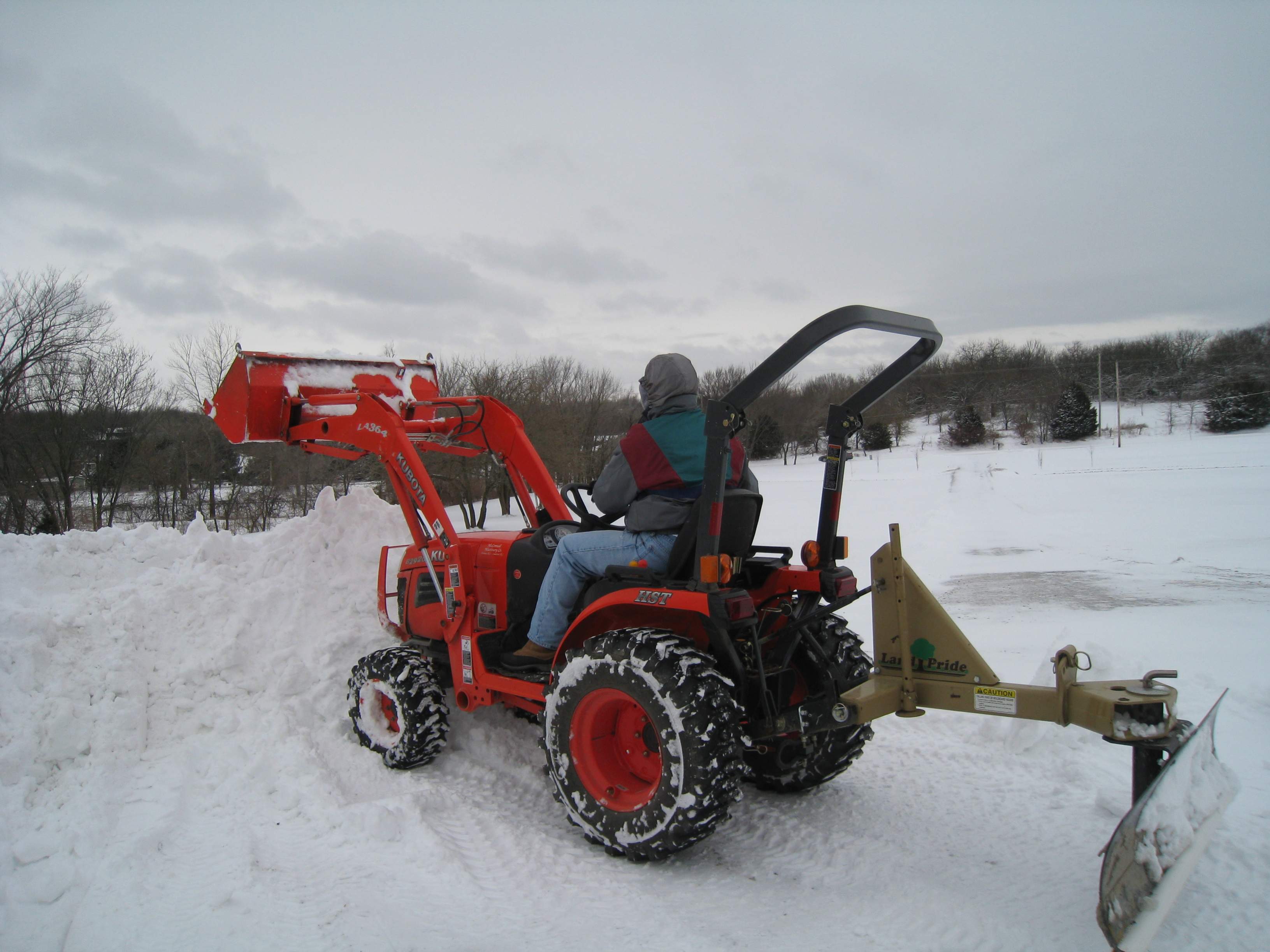

To give you a visual, this is my 5' blade on the back of my B2920. I was using the FEL to clean up a drift that was too much to push. There is still plenty of clearance for a 6' blade to clear the tires. As mentioned above, I opted for the 5' version because I could not get it raised high enough to tilt it to the max setting with the 6'. At the max angle, it will cover my tracks, but only by a small margin.

I have a B2920 with a 60 inch LP blade. After our last snow storm, I'm thinking that it's really to small, and I am now shopping for a 6ft tilt blade. When blading snow, you have it in a angle position to kick the snow off to the side, so the horizontal coverage of a 5 ft blade is now only 4ft. When you come back from the opposite direction, you have to overlap the leading angle of the blade, making the coverage only about 3ft. 3+4 = 7ft lane, which is -just- big enough to get a car or truck in, but then it gets harder with a short blade to push the snow berms over.
I wouldn't think that a 6ft blade for gravel would be a problem for a 2620. If you start to get to loaded up, you can always raise the blade slightly or use the top link to change the scoop angle on the blade to not be so aggressive.
I think I paid $450 for my blade. It doesn't do tilt. The local dealer does have some 6ft Woods blades that are new but blemished (rust) that he is trying to move for $350. (but I want tilt).:D

I use a 6' rear blade on my 2620. I got if for $130 about 6 years ago from Rural King. It is made by Wallace auto Parts. It is very rare that the blade will load up with too much material for the tractor to pull. Only once in snow close to a foot deep would it push the rear sideways and I don't have loaded tires. The FEL helps alot with 4wd to pull it along. My driveway is about 1400' long and has about a 100' elevation change so I have to grade the gravel several times a year with heavy rain and I plow snow if we get much over 1/2". It has held up just fine and I believe I have got more than my money's worth out of it. It doesn't tilt or have a removable cutting edge. I recommend a 6' blade, unless you have a specific reason for needing the 5'.
