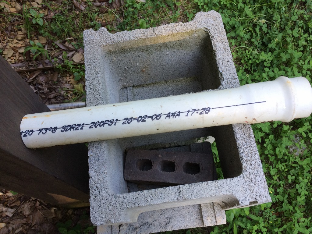

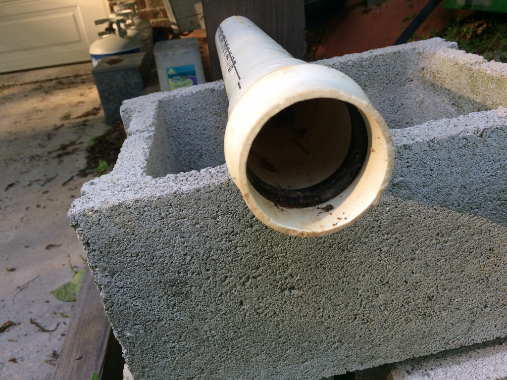

My contractor used the same stuff he runs miles of for the water utility district. SDR21. 20 ft lengths with o-ring joints. Water lines need to be able move just a little. They also put in 3 2" "sectionalizing" valves in little brick underground boxes so we can valve out a specific section for repair if it becomes damaged.
If your soil expands or has any movement at all, this is the best type of pipe out there. There are a few different versions of it, but what's most imported is that it can slide in and out of itself without leaking when the soil moves it in the ground.
