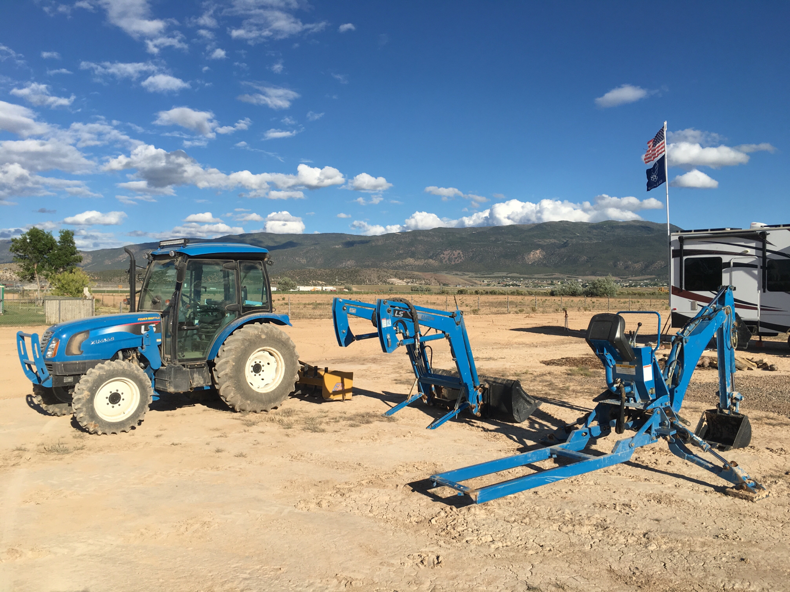

I just took the loader off for the first time because I have some close quarters box blade and post hole digger work to do. It took all of five minutes.
Not having to worry about the loader hanging out front makes using the box blade much nicer.
