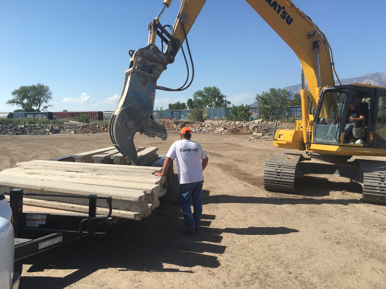

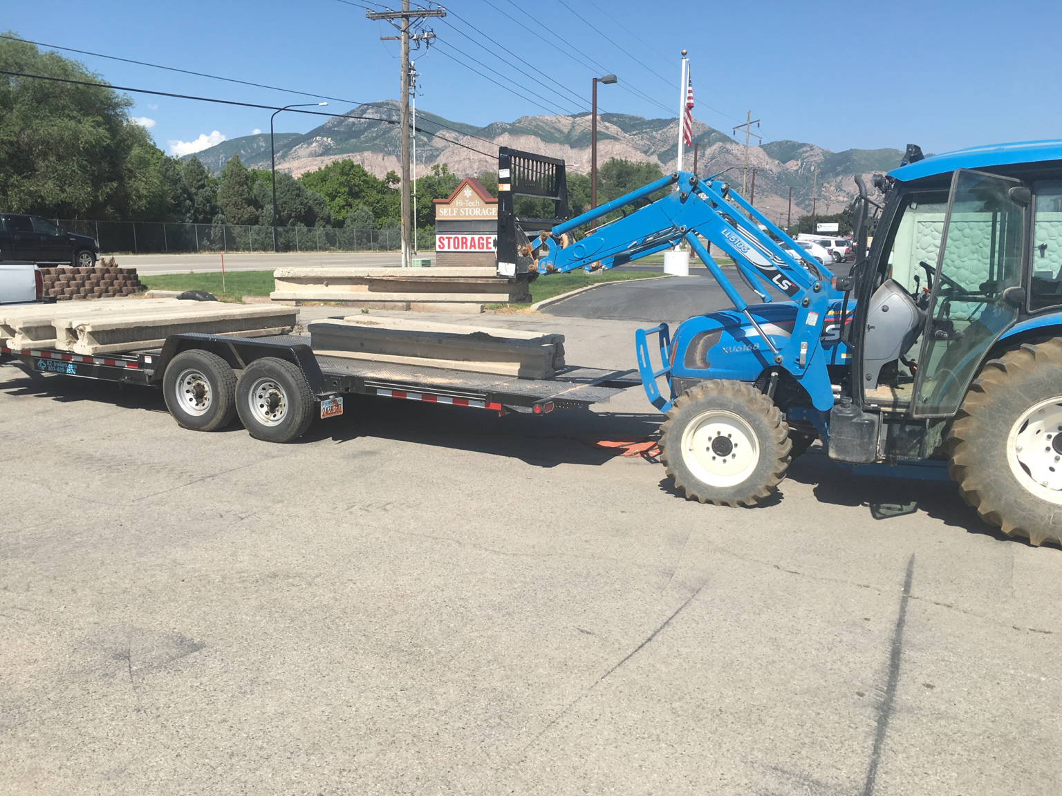

I took the tractor to my VFW post yesterday to help out with redoing the parking lot. It is about to be repaved, but wee needed to get rid of 10 chunks of reinforced concrete that had been used as parking stops.
We loaded them on my trailer and took them to be recycled. We figured each one weighed 1k lbs. For reference, my forks are 60”. Even with the loaded rears and the backhoe installed, the rear end was the lightest i have seen it.
They were offloaded with the crusher.

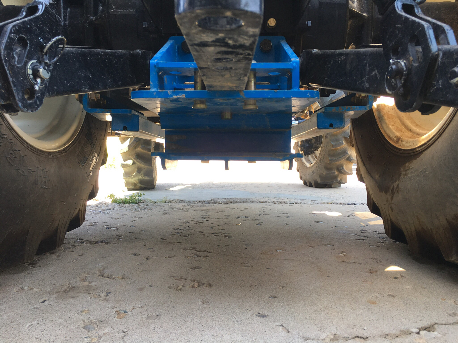

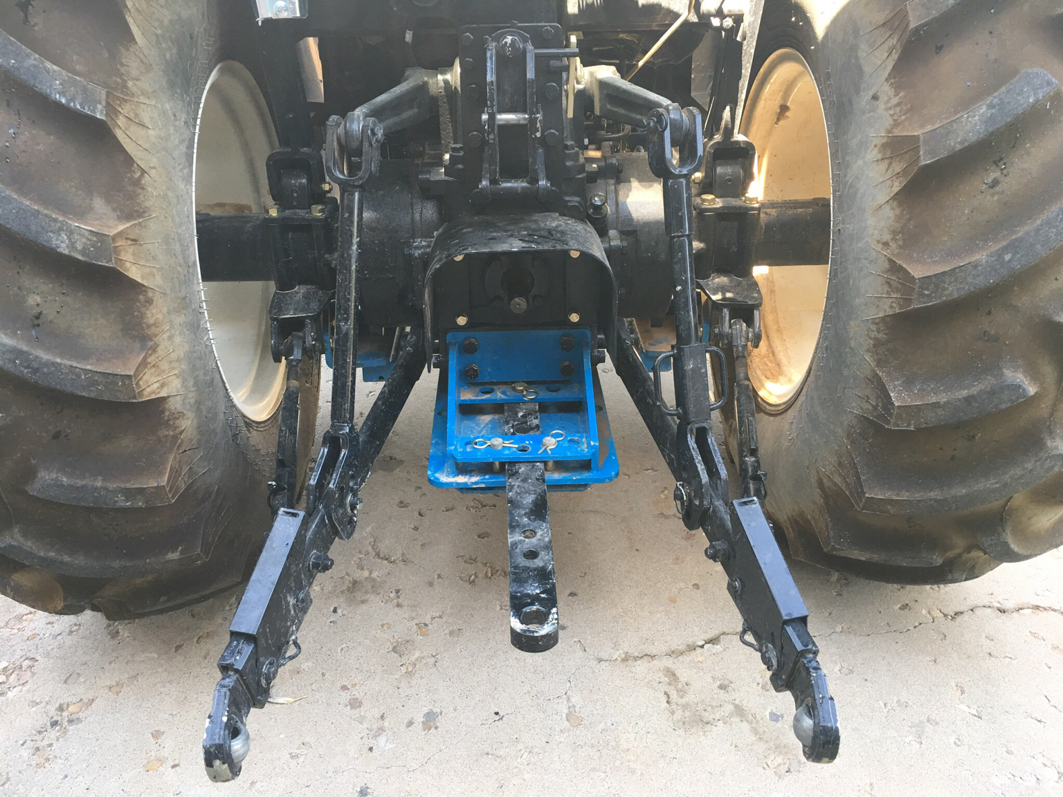

I had the backhoe off this week to use the post hole digger. While it was off I took a couple pics of the subframe mount. On these XU series machines, the standard swinging drawbar mount is removed and the subframe is installed.
I also measured the subframe as being almost 5” lower than the lowest part of the rear axle, so the ground clearance loss is something to be considered. On my flat land, it has not posed any problems.

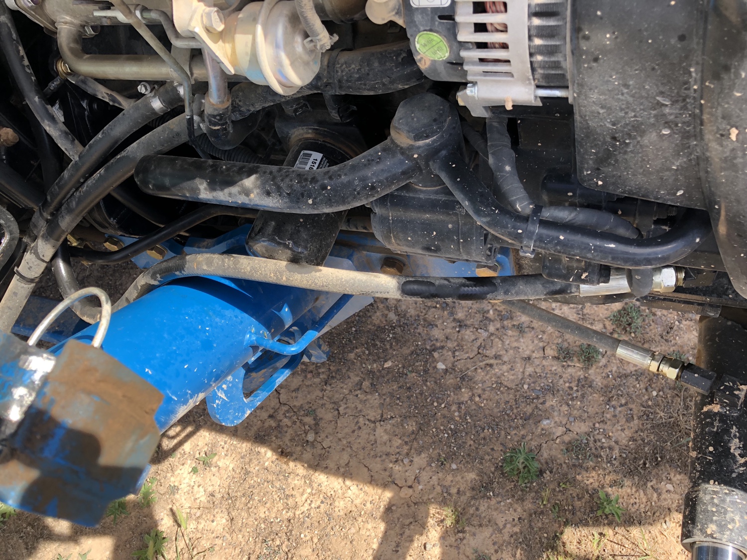

OP here. I had my first breakdown. The hose from the power steering pump to the orbital valve ruptured while I was jockeying the tractor around to line up with my tiller.
The line runs right past the oil filter and over the loader support on the right side. It was just a pinhole and would spray oil on the lower right glass of the cab when I turned the wheel.
I called my dealer and sent him a short video and some pics for the warranty. He is going to send me a new hose assembly. In the mean time, I was able to cut out the bad section of hose and install two -8 field installable JIC fittings (one male and one female) to get me back in service for a couple days until I get the new hose assembly.
Since this was the steering, I am comfortable with this type of repair since there is no pressure on the line until the steering wheel is turned.
For those of us that don’t have a hydraulic shop close by, I recommend picking up a male/female set for the hose sizes on your machine for temporary repairs like this.
Here is link to these reusable fittings.
SAE 1R1 Field Attachable Fittings
The offending hose before my repair.
What was really weird was the line didn’t rupture where it touched anything. It was on the top of the hose and aimed perfectly at the cab. I’ll see if I can post the short video.
Edit:got it
Steering hydraulic hose leak - YouTube
I am planning on putting the new line in sleeving to help prevent premature failure next time.

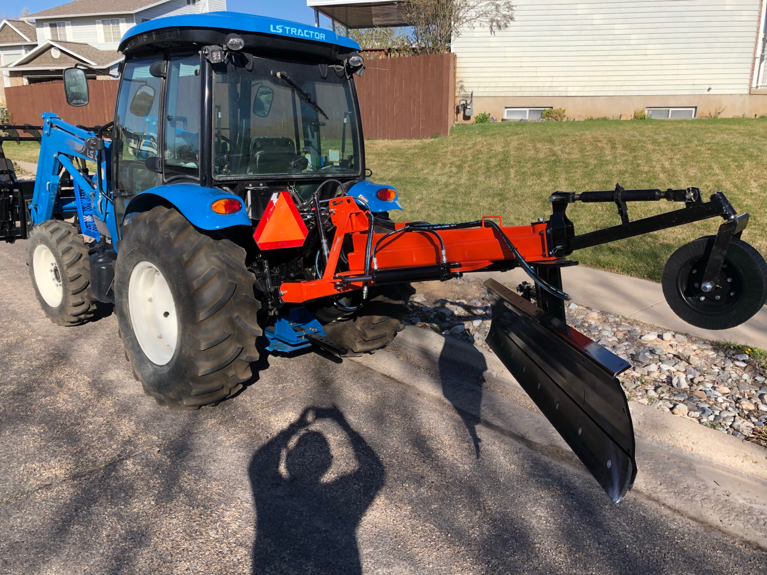

Today I picked up my new Everything Attachments 66 grapple and 96” hydraulic scrape blade.
I also had them send me a Cosmo 3pt cement mixer since it didn’t really add to the shipping. I haven’t played with it yet. They told me that I will probably have to modify the cylinder since my tractor is a cat 2 and it may not dump all the way. I’ll have to see what it needs.
To run the grapple, I also ordered the WR Long 3rd function kit with flat face couplers. The kit fits nicely and wasn’t too bad to install. Taking apart the right side of the cab to run the wires the way I wanted wasn’t much fun, but it makes for a neat install.
I heated and bent the bracket 90 degrees they sent for the couplers. I drilled two new holes in the hydraulic line cover on the loader and mounted it sideways once I had the grapple on and found the hoses were plenty long. I put sleeving over all the lines while I was at it.
