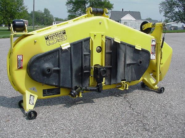

   / 62D MMM Creating Divots with Front Wheels #110
This photo is similar to my deck, but my deck has both front wheels like the one on the RIGHT side of the deck...which has a spring mechanism to realign the front wheels...You might check with JD to see if they can get you something similar...
