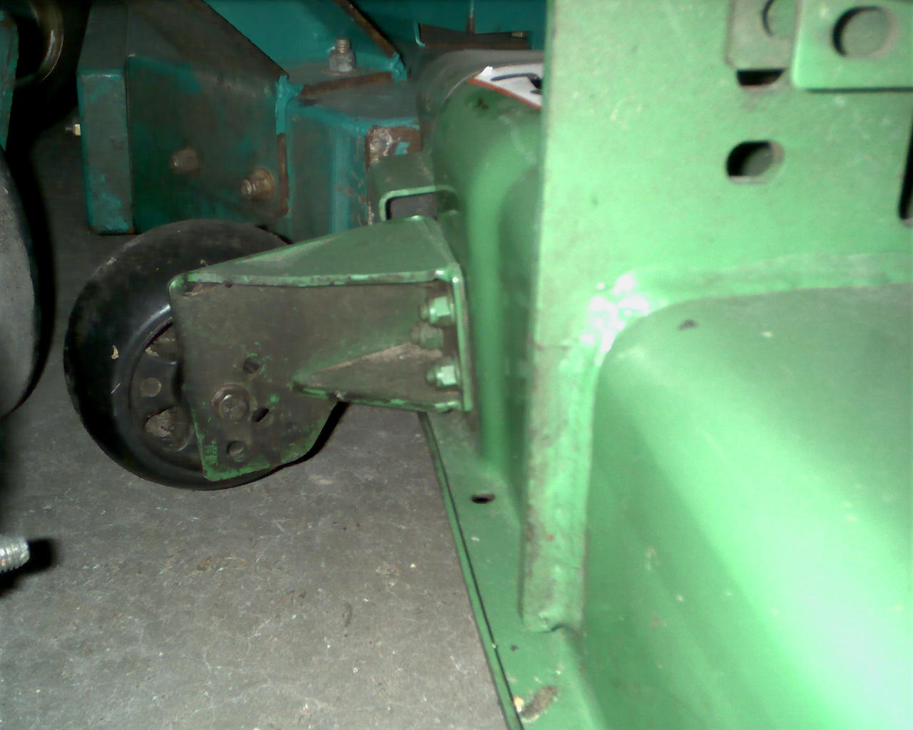

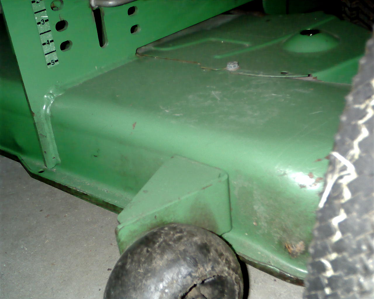

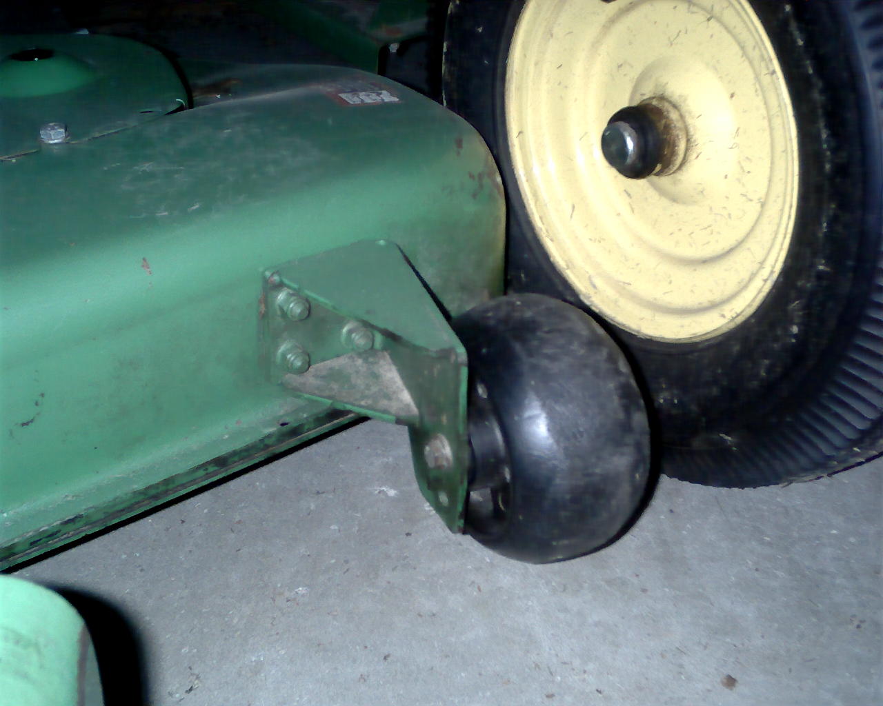

I think the best and easiest thing to do in this case is to cut the front anti-scalp wheels off. Brackets and all. Then order an anti-scalp wheel kit from John deere that bolts onto their GS75 54" walk behind mowers. We purchased this kit years ago for our machine. The wheels are height adjustable, with a wrench. They have grease fittings on them. The wheels are heavy-duty and very rounded. If i remember, we had to drill a couple of holes for them. If anyone is intersted, I will take a pic.
Yes, please post a photo. I am the one who started this thread and I am still looking for a solution. The grass will need cutting in about a month in this part of the country.

Papaw, Just sent the pics!

Fella's , I could fix this problem in 30 min.
from the pictures that have been posted. the wheel is rideing right under the pin it is suppose to swivel on. and thats not going to work very well at all.
it is going to drag when you turn, instead of swiveling like it should. it needs to be set up like a caster on a grocery cart. the wheel needs to be offset of the swivel point. All that needs to be done. is have the pin cut off the wheel bracket. and slid to one side and reweld it. if there is not enough room. add a 2 inch peace of 1/4 flat band on one side and reweld the pin to it. and it will never dig your yard again. it needs about at least 2 to 3 inches off center. it needs to look like the wheels on the front of a 0 turn mover like a ZTrack. the wheel need to be offset of the piviot point.
I know i use to repair these wheels on tractor mowers for years.
this was just a design mistake. but its a simple fix...:)
   / 62D MMM Creating Divots with Front Wheels #69
I just saw a better picture. it is offset a tad. but no where near enough. it needs more to work right. Three inch offset. and it will never hurt your yard. trust me...;)
