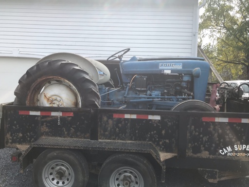

Loaded the trailer and beat it back over there and loaded it with a winch and ramps.
And then.
Dead battery. Hooked up jumper cable to battery with 12 volt but low battery.
No spark. Opened distributor and cleaned points, cleaned corroded coil wire end. Got blue spark.
Started on starting fluid.
No fuel though sediment bowl was full. Pulled carb and removed bowl. Found main jet needle stuck closed. Freed needle. And now have fuel.
Started right up! Checked voltage and is charging on the 6 volt system.
Then I did what all of you would do. Backed it off the trailer and went for a tractor ride! IMG_1219.JPG

Excellent find! Good job! What is on the front of it or am I looking at something else up there?
/ 64 Ford 2000
That’s the winch I use on the trailer for helping me load “treasures”.
/ 64 Ford 2000 #8
Nice find for the price! Basically you bought a power steering system, and got a tractor thrown in for free.

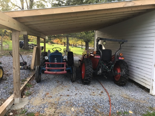

8 months later and tractor is running fine. I do have to turn the gas off under the tank or it will leak out when sitting. So I keep a screwdriver wedged in beside the tach cable for this.
While I was turning the gas on today, I saw something I’d never noticed before. A little box behind the right side floorboard.
A tool box! And with tools.
The tractor came with its own screwdriver and crescent wrench and I had never saw it.
Why it’s only been here 8 months...
