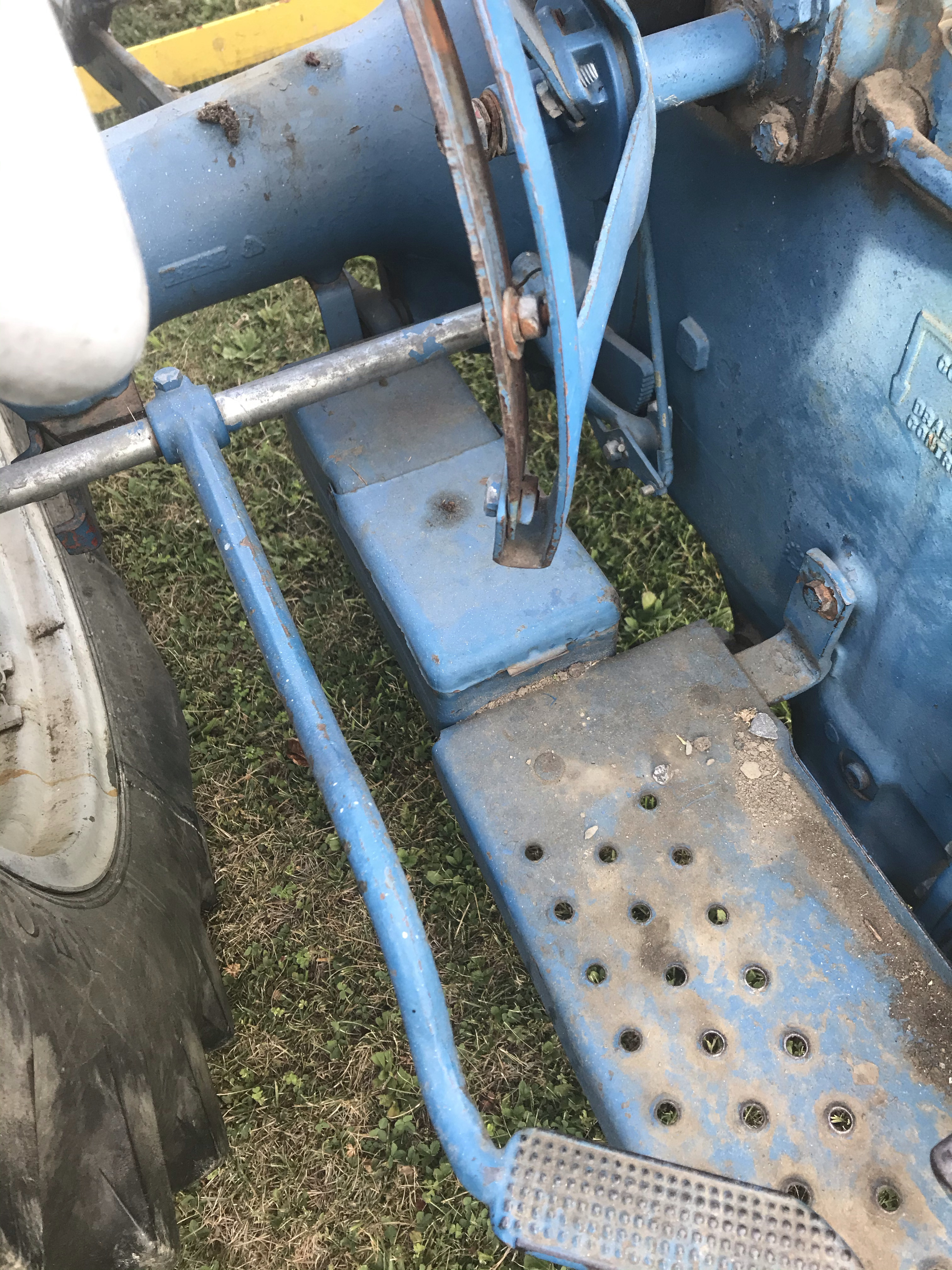

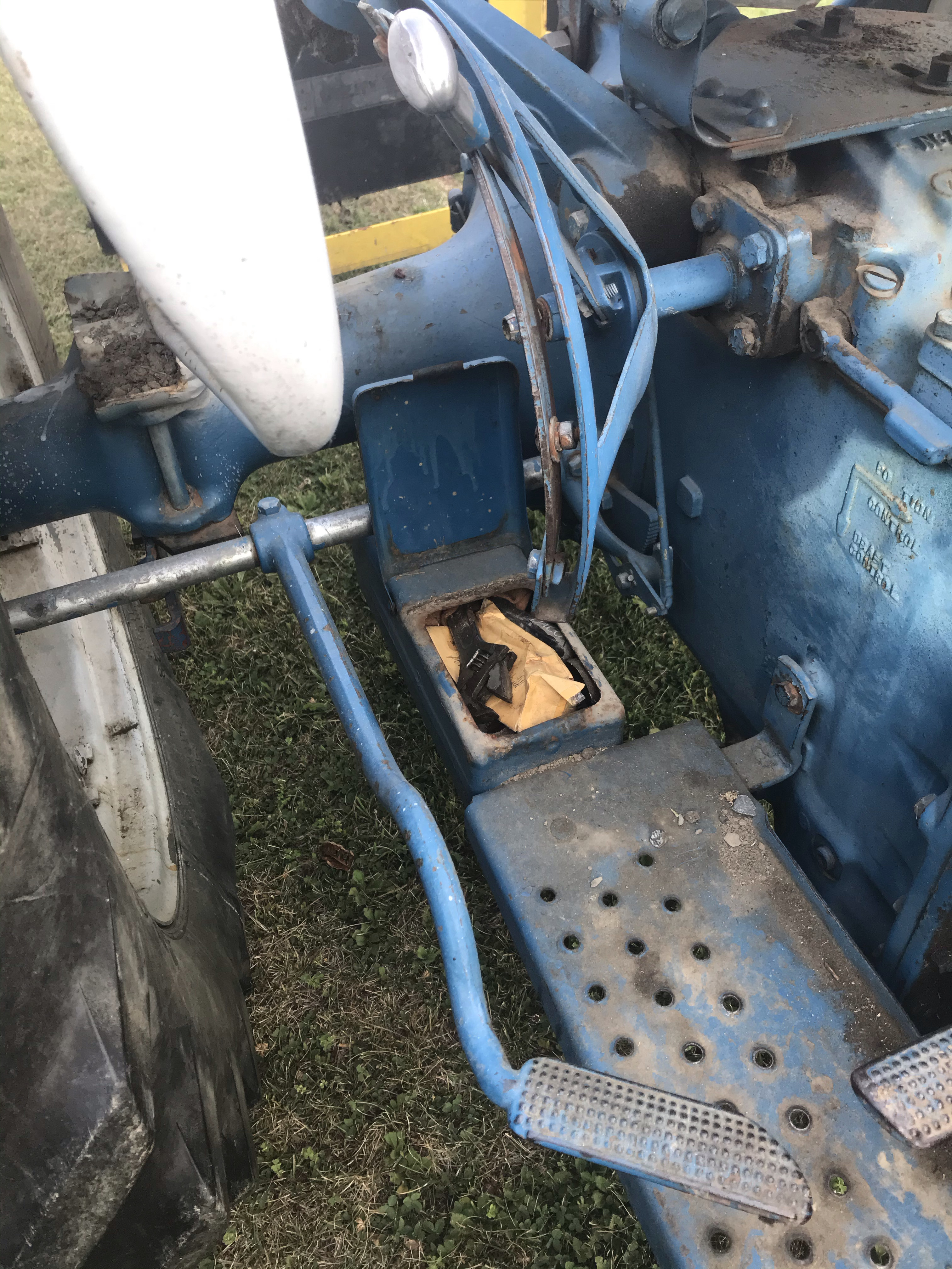

While I was turning the gas on today, I saw something I’d never noticed before. A little box behind the right side floorboard.
A tool box! And with tools.
The tractor came with its own screwdriver and crescent wrench and I had never saw it.
Why it’s only been here 8 months...

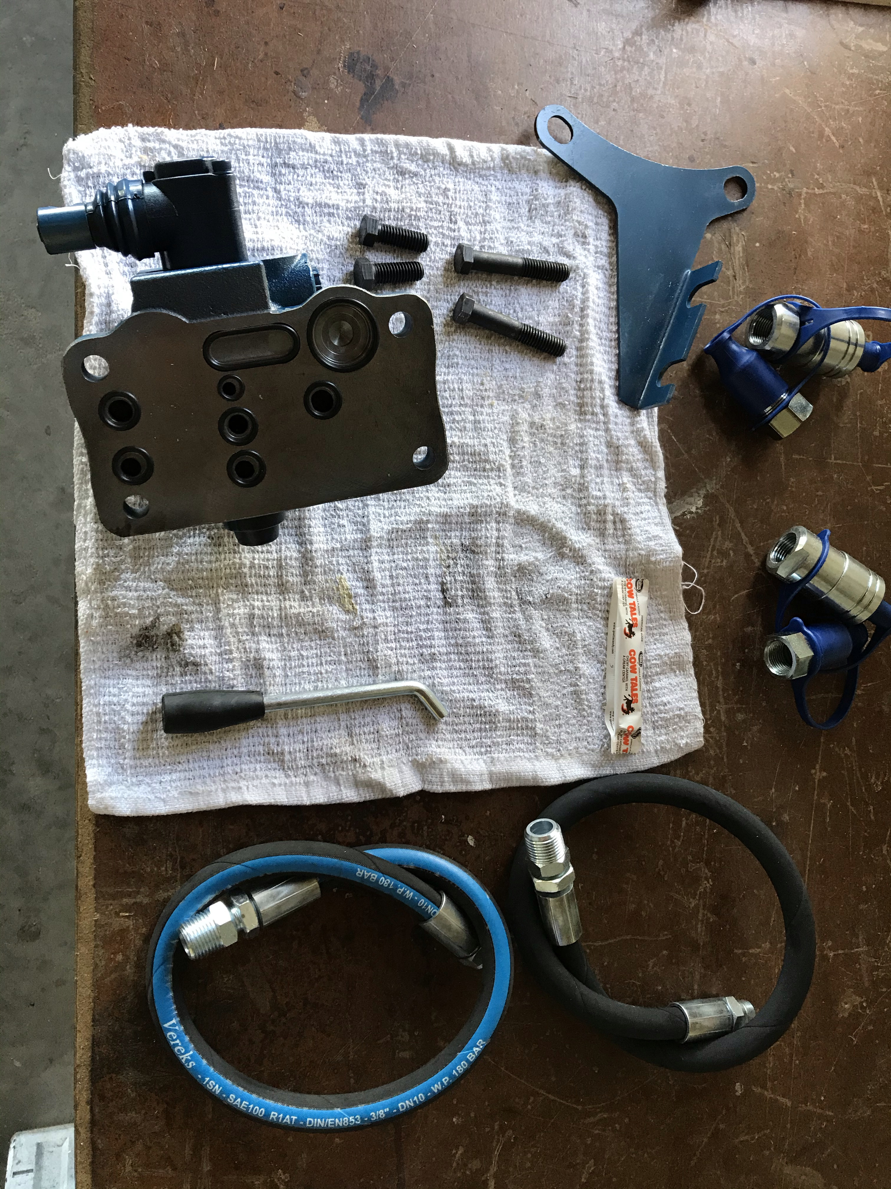

The post disappeared but I wa starting to show I picked up a remote kit from Steiner Tractor and installed it.
Easy one hour upgrade.
