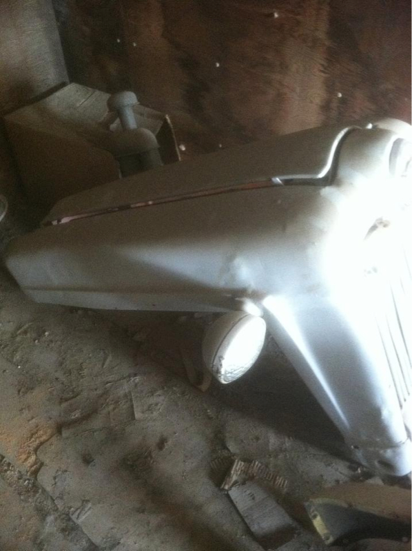

I've found a hood for 450 dollars, is this a good price for one
/ 640 with loader #44
i have paid that much for a set of tins for a 951 before... didn't like it.. but paid it...
